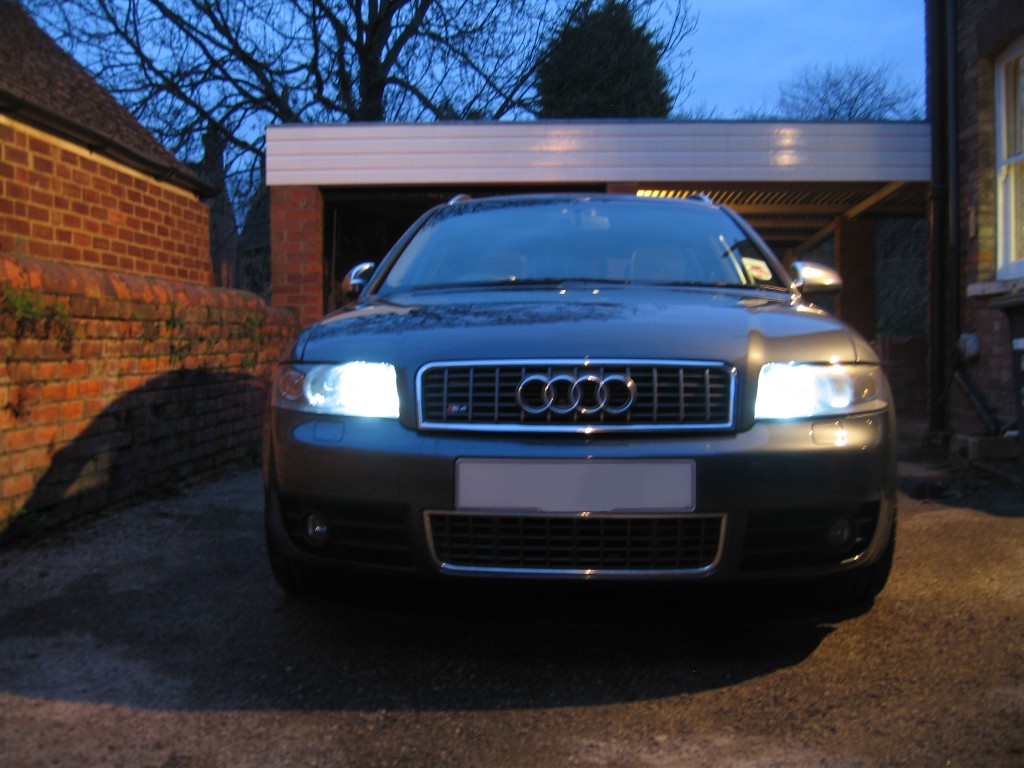

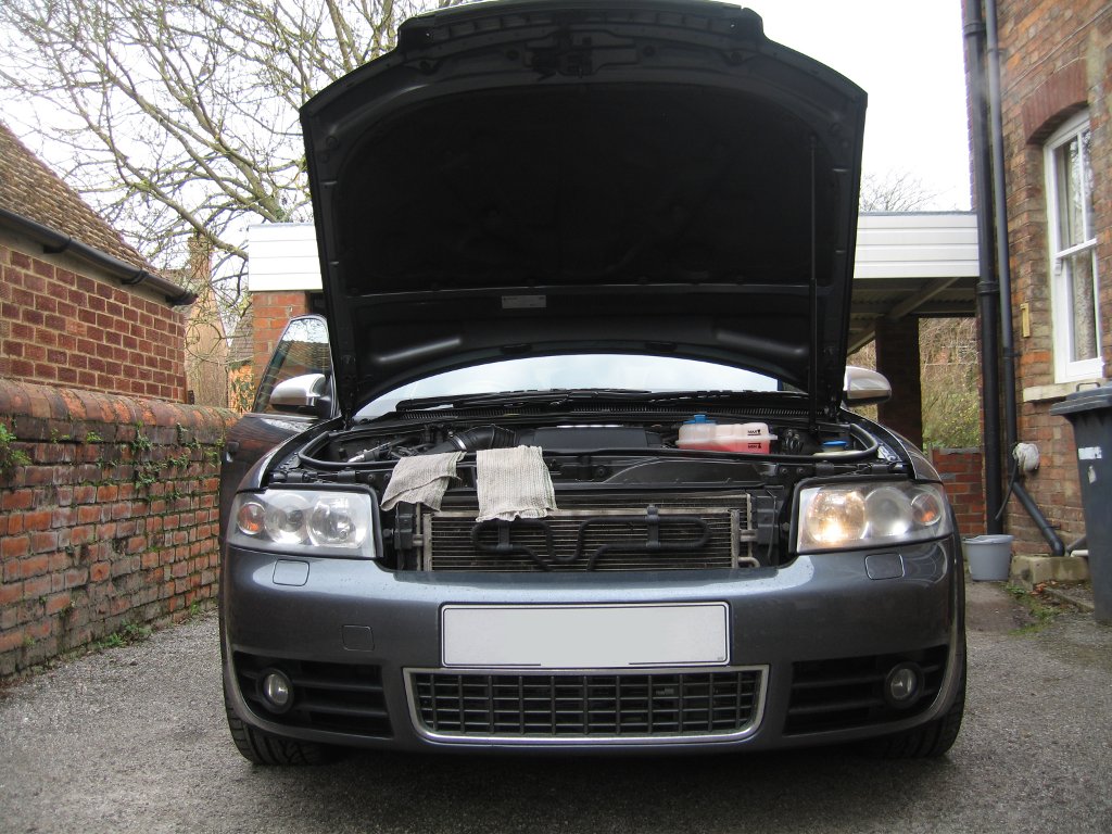

Diddit. Ordered Thursday night, hit my doormat Saturday morning when I was at work, very rapid.
Removing the left and right plastic cowls and the plastic air intake duct only involves two screws just in front of the slam panel. The backs of the headlight have a wire clip that pivots either end and uses an 'over dead centre' method. Unclips with one finger simply by pushing down. Remove the plastic backs of each headlight - with a bit of wiggling you can get them out the engine bay. The bulb holder has a lug on either side - squeeze these and pull the bulb holder straight backwards. The bulbs come out the holder just like a bayonet household bulb - you push them in, twist anti clockwise and pull them out. New leds in, key in ignition, sidelight dash dial on, bulbs on, no DIS warnings. Reverse above process to 'rebuild', double checking you have left nothing foreign under the bonnet before dropping.
The only minor note is to push the bonnet release cable down as you put the front of the air intake duct back under the slam panel. I couldn't work out why the duct wouldn't line up, and realised after a minute the duct was catching on the bonnet release cable hidden under the slam panel.
As mentioned, I ordered two sets of leds - a pair of the 'bullet' single leds, plus also a pair which house two leds in each unit. Fitted are the dual units. They match the xenons wonderfully, meaning I no longer have the horrid yellow sidelights ruining the lovely crisp xenons. Very impressed with the results. Photograph shows just sidelights - not with xenons!
