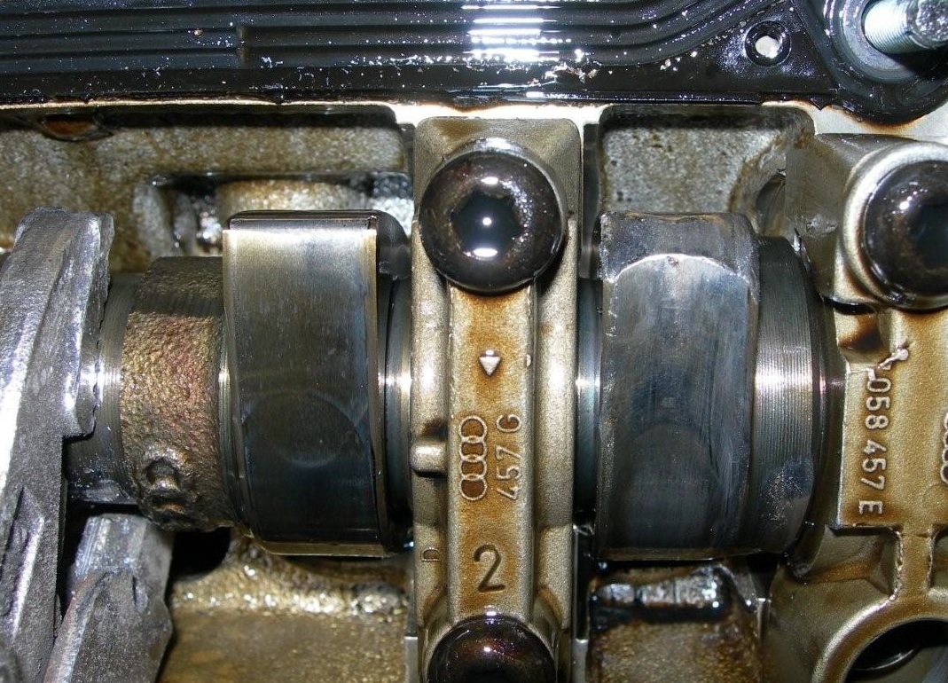

Doug then sent me a few pics of the diagnosis.

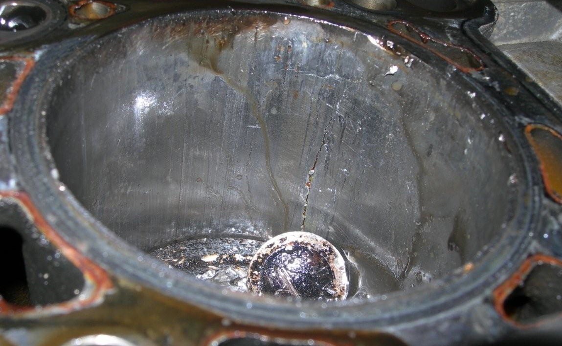

Post by buzzard » Thu Apr 10, 2008 7:10 pm
then it got worse

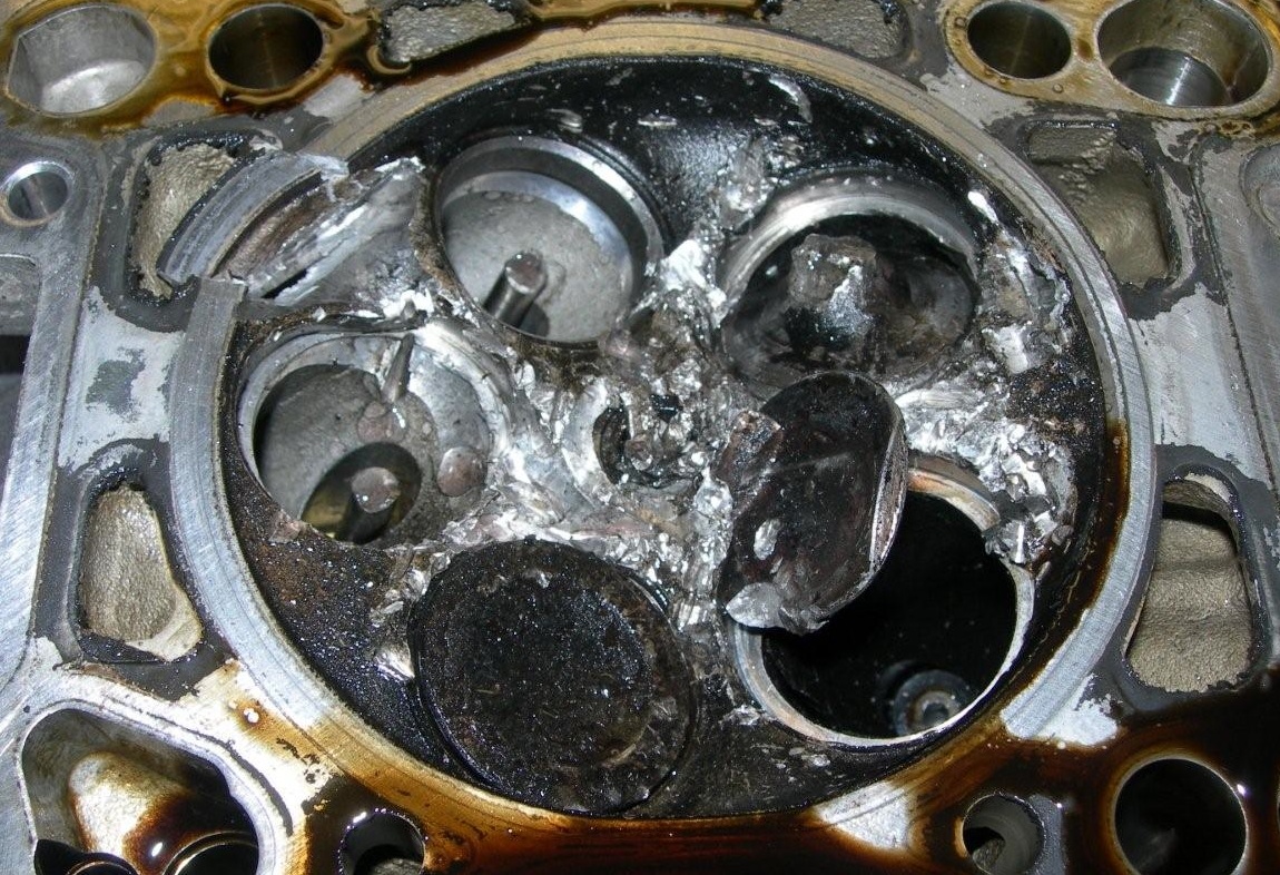

Post by buzzard » Thu Apr 10, 2008 7:11 pm
and worse
so now the engine is scrap

cam belt done 10k ago.
think it must of been running hot on the one pot.
then seized the lazy valve only to hit the piston then snap off and the rest of the valves ate it..
the bore has cracked possibly through heat or just self distruction.
this is the only one that doug has seen that has done so much damage only on one bore.

Cambelt was still timed ok - the locking tool fitted on.
The worn cam has eaten through the follower and then worn its way down the valve stem until the collets have come off - then the valve would have dropped causing the above damage and scarily craking the bore with it.
