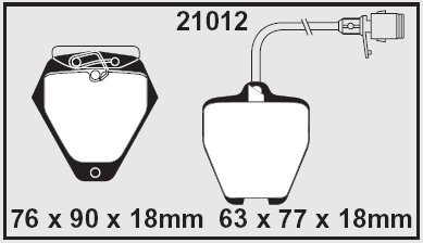

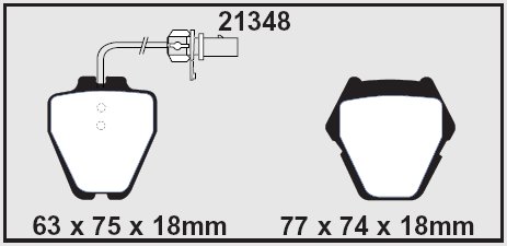

Not sure how you are getting on, hope you got it sorted if not a few photos for you re pad dimensions - you will need to remove a pad to find out what you have, hope this helps.

You can see the Torx bolt fastening on the up to 99 model.... Mine was manufactured 11/98 and has bolt fitting on pad (the pad with hole in it e.g 97-99)....... think later models have some clip assembly ...should see it clearly through alloys ......erm I think

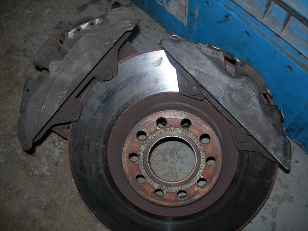

here you go - facelift caliper is the one on the disc.

There are/where 3 different calipers, pre-facelift....mid facelift.....facelift. The mid-facelift was Sept/Oct/Nov 99 cars. As far as I'm aware there are no 3rd party pads for the mid facelift car.
