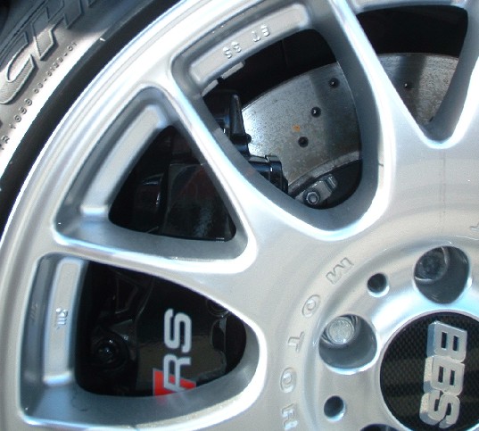

RE: Re: RE: Need help: Aloy lfittment with B7 RS4 Discs &
ET35mm 8.5x18 BBS CH will, as below.
- Attachments
- rs4v8discs11.JPG (70.66 KiB) Viewed 1222 times
- rs4v8brakes12.JPG (128.57 KiB) Viewed 1220 times
