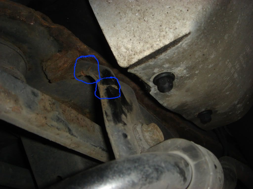

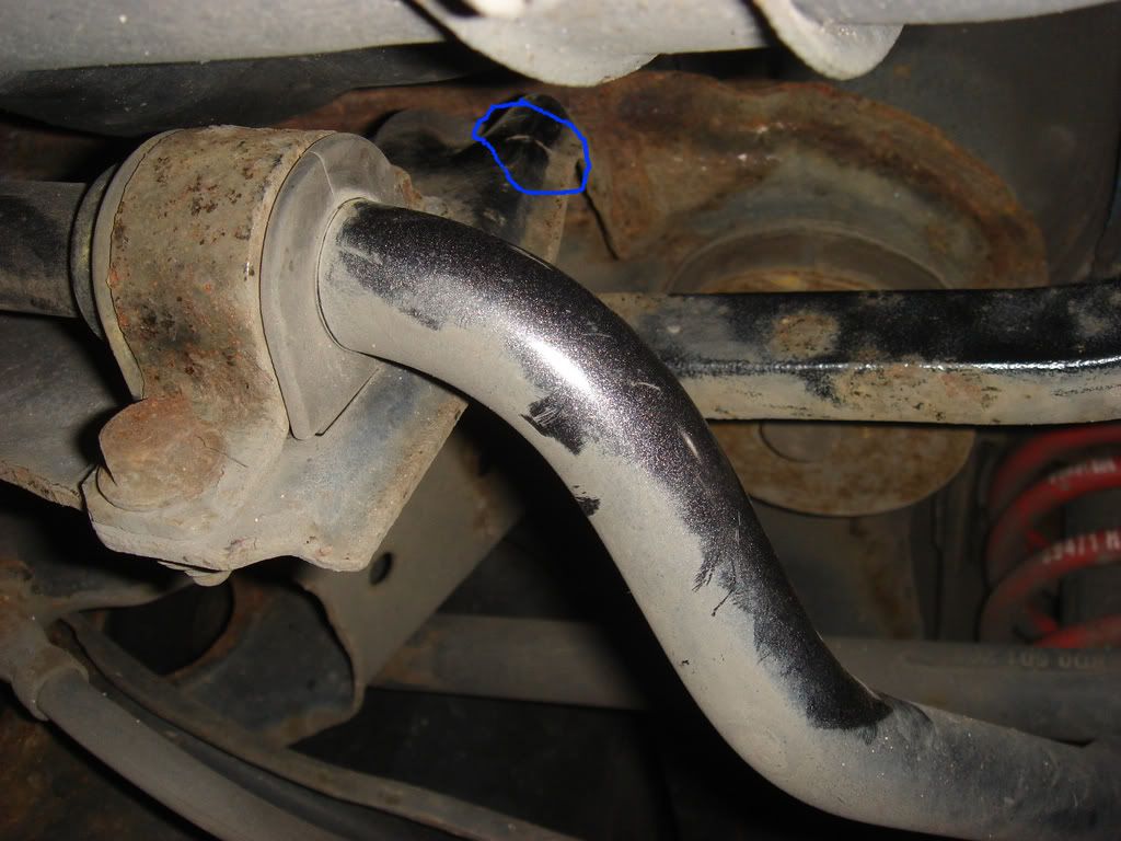

Post by s4-99 » Fri Nov 14, 2008 5:19 pm
Well, after reading this thread, i went and checked underneath my car. Here's what i found.......
Does it look ok to get welded up? Does anybody know if MRC are still selling the support brackets, or if anyone has any to sell? Are the support brackets an easy fit, for someone without great mechanical skill.
Most importantly, is it safe to drive like this???
Any help advise would be appreciated

Post by Doug_S2 » Fri Nov 14, 2008 5:22 pm
it is only going to get worse so get that welded asap and support brackets on there to stop it happening again.
