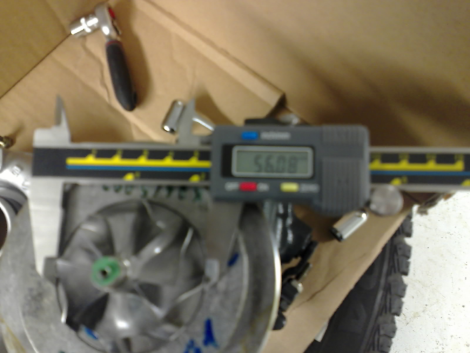

There is a BIG diffrent of the to turbo on the picture..
I thourght a RS4/RS6 turbo was the right turbo, on the picture..
But here is a picture of the one they send me.. But the inlet or what you are calling it in english 8) , is the same as a RS4 turbo.. But the wheel is bigger inside...

then it is a hybrid turbo, RS4 housings with RS6 core. Just like they are telling you??
Easy for us to say, but what you have is a good deal. The turbos you have will very easily make 450bhp.

Yes I got A RS4/RS6 HYBRID turbo 8) But I still dont understand why they send my that picture of the to turbo showing the diffrent.. But as they are saing... MARTIN PICTURE IS PICTURE :roll:

I agree with you, you've not got what you expected. What you have should be more than capable of your target, unless you have larger targets next year?
Obviously the picture isn't their normal hybrid turbo. It might be a RS6 turbo next to a RS4 turbo (I have never seen a RS6 turbo and so wouldn't know)
I'm sure someone else will recognise it if it is a plain RS6 unit in the picture.

yea you got rs4/rs6 hybrid, exducer the part you are measuring is just as they said, and the fins on the inducer are same as rs6, must be that the one in the pic is a straight rs6, there are pics of rs6 turbo's posted on the forum somewhere so you may compare...

this post has been a bit confusing... but you got what you wanted.
KO4/RS6 CHRA's are hybrids. KO4/RS6 are also remann'd RS4 turbos machined to accept the RS6 CHRA. 2K GBP aint that great of a price tho.
