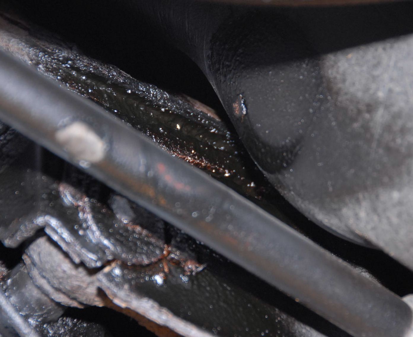

Some pictures of a 98 avant, spotted during a service.

Yep thats the same place as mine but mine has gone both sides.
only 1 side of yours has gone where the washer is steve..the otherside is just a split and a crack on the ARB bracket plate

Oh right i was made to thik that it had gone both sides. See u Sunday Si.

Post by s4woody » Fri Feb 08, 2008 12:24 am
it had gone both sides but 1 side was just a crack and the other was a complete break..

Just checked mine.......Phew.....Its ok.

<beep> and mine.. i seem to have a knocking from the rear as well.....

I've got cracks both sides where the ARB support attaches to the subframe :-(

Looks as though this is becoming quite a problem then. Is there anyway of making sure this does not happen again?

Managed to fit my Apikol rear diff mount today by dropping the exhaust mounts. In doing this I had a better look
at my subframe and it looks fooked. I am going to complain to H&R but I don't suppose it will go anywhere.
Other vendors are shipping support brackets with their stiffer bars.
This car has turned into a serious money pit over the last few months...
