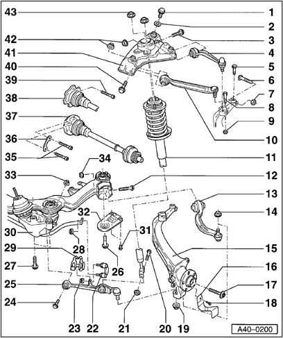

Anyway.. they've noticed a lot of wear in one of the anti roll bar bushes, and suggest replacing it, although they're not exactly sure that's the one. Speaking with Audi to get the replacement part they are asking whether it's inner or outer bush, and if it's the outer bush, you need to get a part that looks like a C bracket that has the bush built in.
Anyone got a picture of outer and inner bush, or the diagram from Bentley? I've lost my cd....
