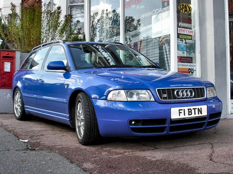

Post by f1 » Wed Oct 08, 2008 1:25 pm
Now that is interesting. I remember speaking with TD in the past and they said they didn't do them. Any idea how much the shaft speed is reduced using the K04 compressor wheel? Would be very interesting to see the RR results. I would have thought it would be suffering from back-pressure top end. Well done if you make the magic 400.
Ok have spoken to td about your question they have said that the shaft speed would be lower but considering ive turned the boost up it hasnt really made any difference,they firgure it might spin upto 10k rpm slower with the same boost!
Anywhoo here's a pic of how it looks this morning,brakes and arb's to be fitted next!
Will try and get an appointment on the rollers next week!

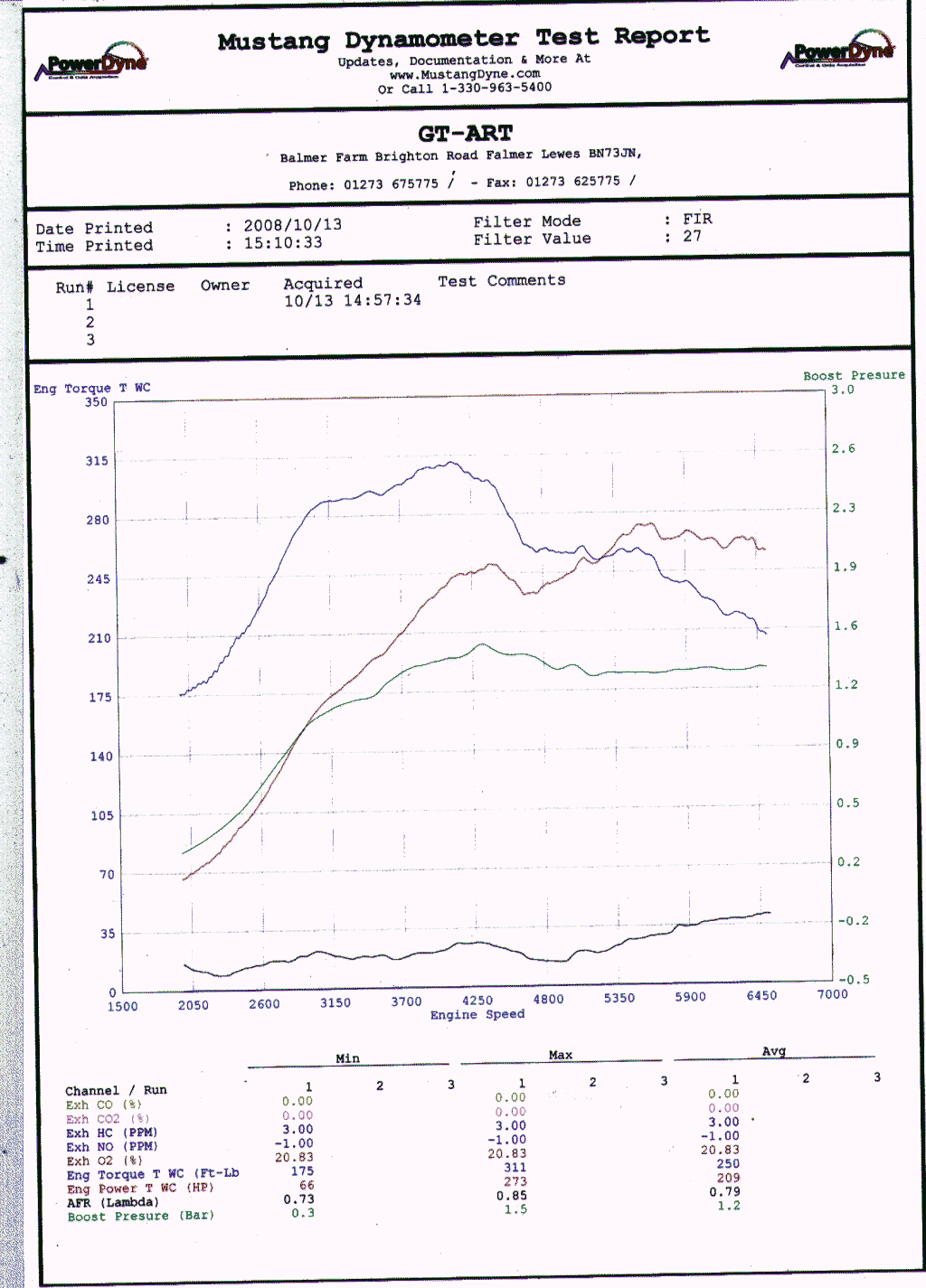

Post by f1 » Mon Oct 13, 2008 5:17 pm
Ok guys we have had the car rolling roaded and the figures are differcult to work out because its at the wheels not fly + all rolling roads are relitive i guess!
Also the printout shows a dip in the power torque which is not noticable on the road!
We should have hooked up vag-com and taken the readings when it was on the rollers but alas we didnt think of it!
Anyway im fairly happy with the results but am bemused by the graph tbh,
The car will continue to be developed as we feel there is more to be had yet!
MGR
Posts: 31
Joined: Mon Aug 25, 2008 10:20 am
Post by MGR » Mon Oct 13, 2008 7:22 pm
Whats the benefit of these hybrid turbos ? Are they much cheaper ? Why would this be a good option compared to a K04 for instance ?
275 at the wheels. Thats quite a lot of power. 225 at the wheels translates to about 290 bhp in a 4wd so 275 is pretty good.
My BMW makes 275 at the wheels which is interesting, I wonder which would be quicker....
