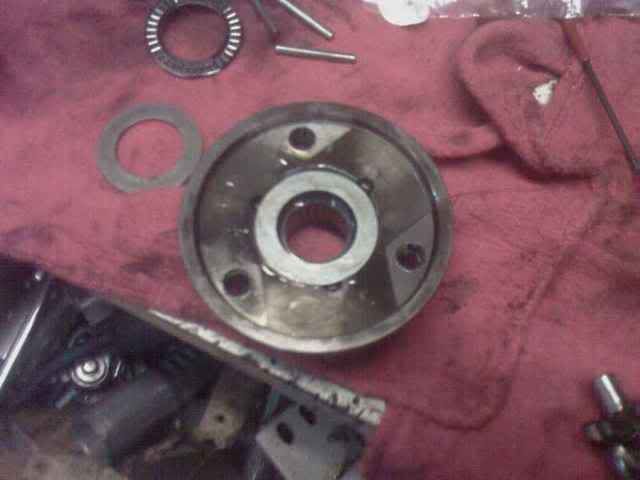

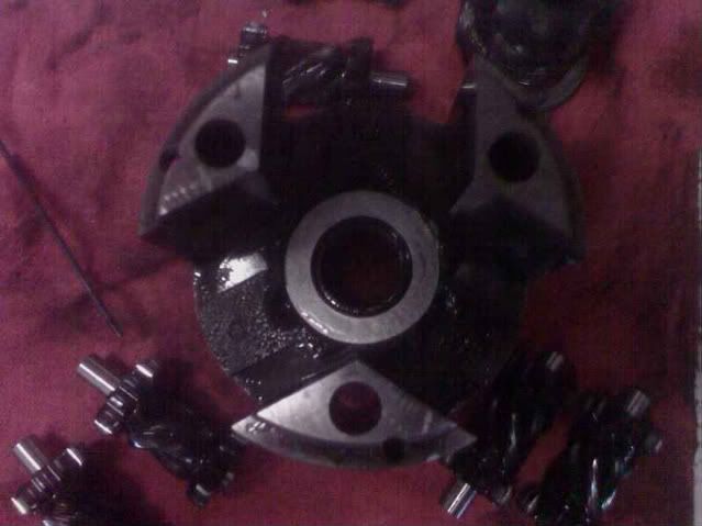

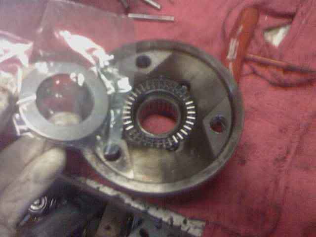

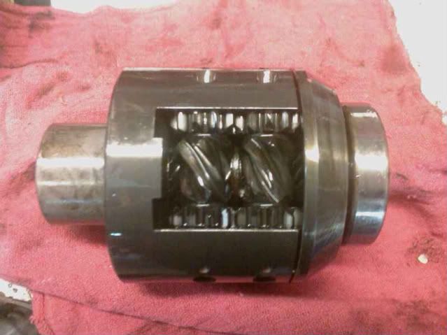

The two outside ones.
Here are some pics of a 2 pc one.

Post by Soupie69uk » Tue Apr 01, 2008 12:01 am
I have not done it yet. Those are pics I have fund on the net.
I am just getting the washers and will do it after I have finished my uni work.
