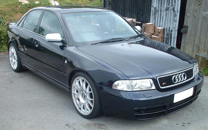

Well from PW's picc's you can fit not just the rizla paper between the caliper/spokes ... but the whole packet .... :smile_smoking:
Leon.... yr wheels probably have deeper spokes/centre vanes due to them being et50.... was at MRC today, very tight ... well locked actually ...
get them fattys on the front .. brackets to complete the conversion ... should set it back nicely .... :thumb:
Happy Days then ...... :jump:

RE: Re: RE: Need help: Aloy lfittment with B7 RS4 Discs &
Post by philipwalker » Thu Dec 21, 2006 10:09 am
Here you go..............

Note that PW's are 18's not 19's like Leon's
