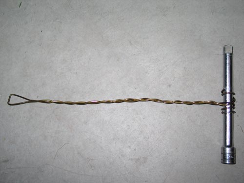

Use a bit of sturdy wire or coat hanger....
yank it up into place

Post by fil » Fri Mar 02, 2007 2:04 pm
time too make a new tool for the tool box :D
