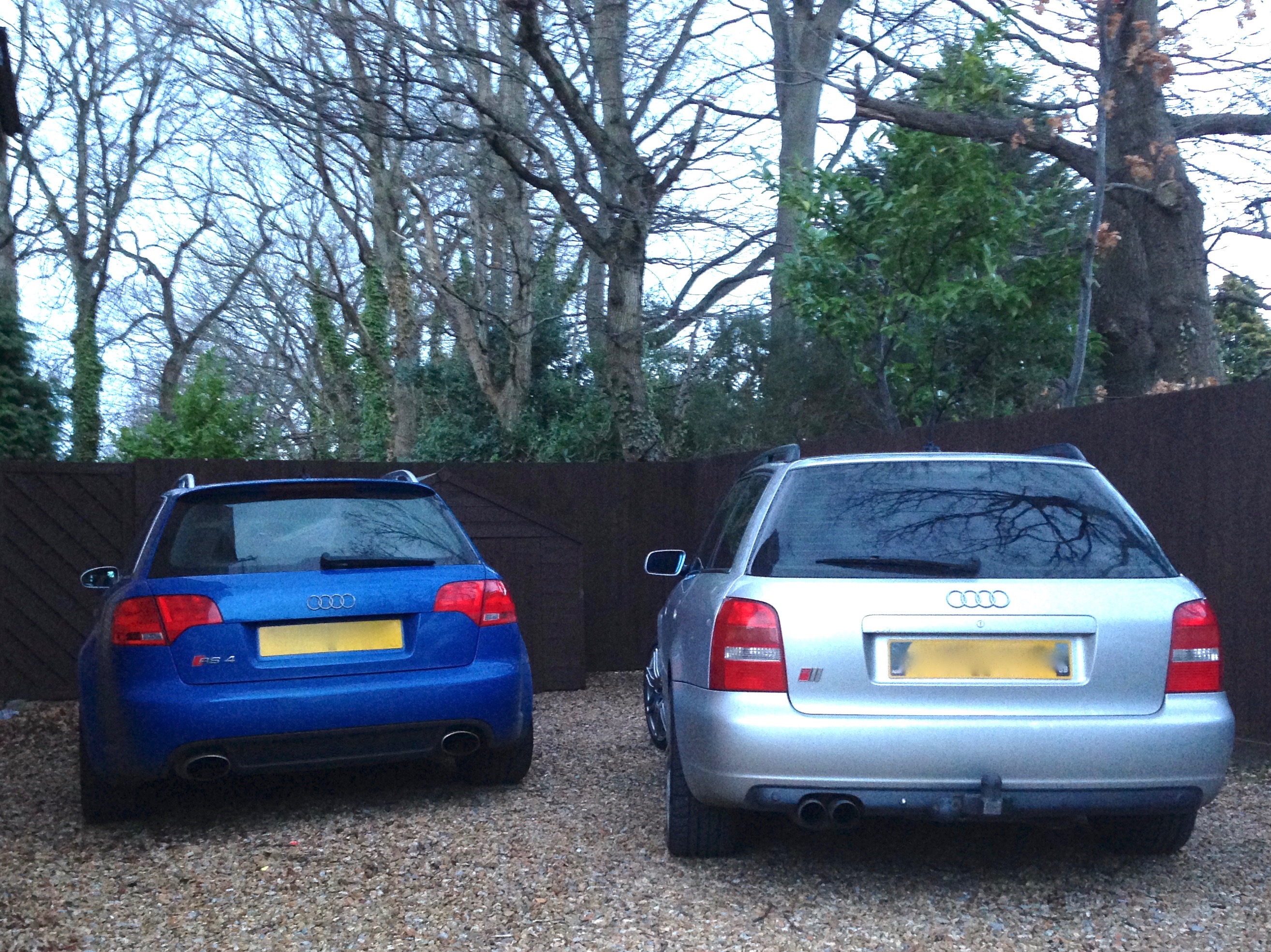

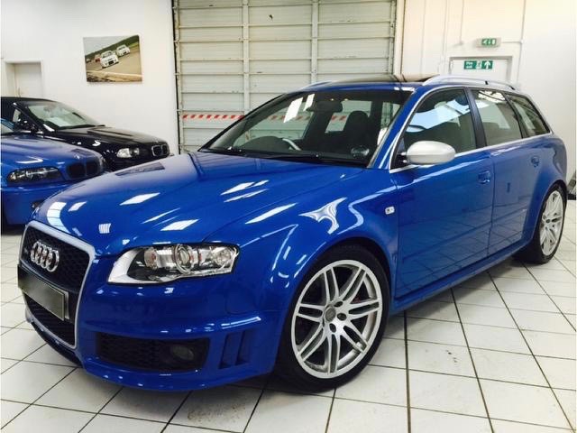

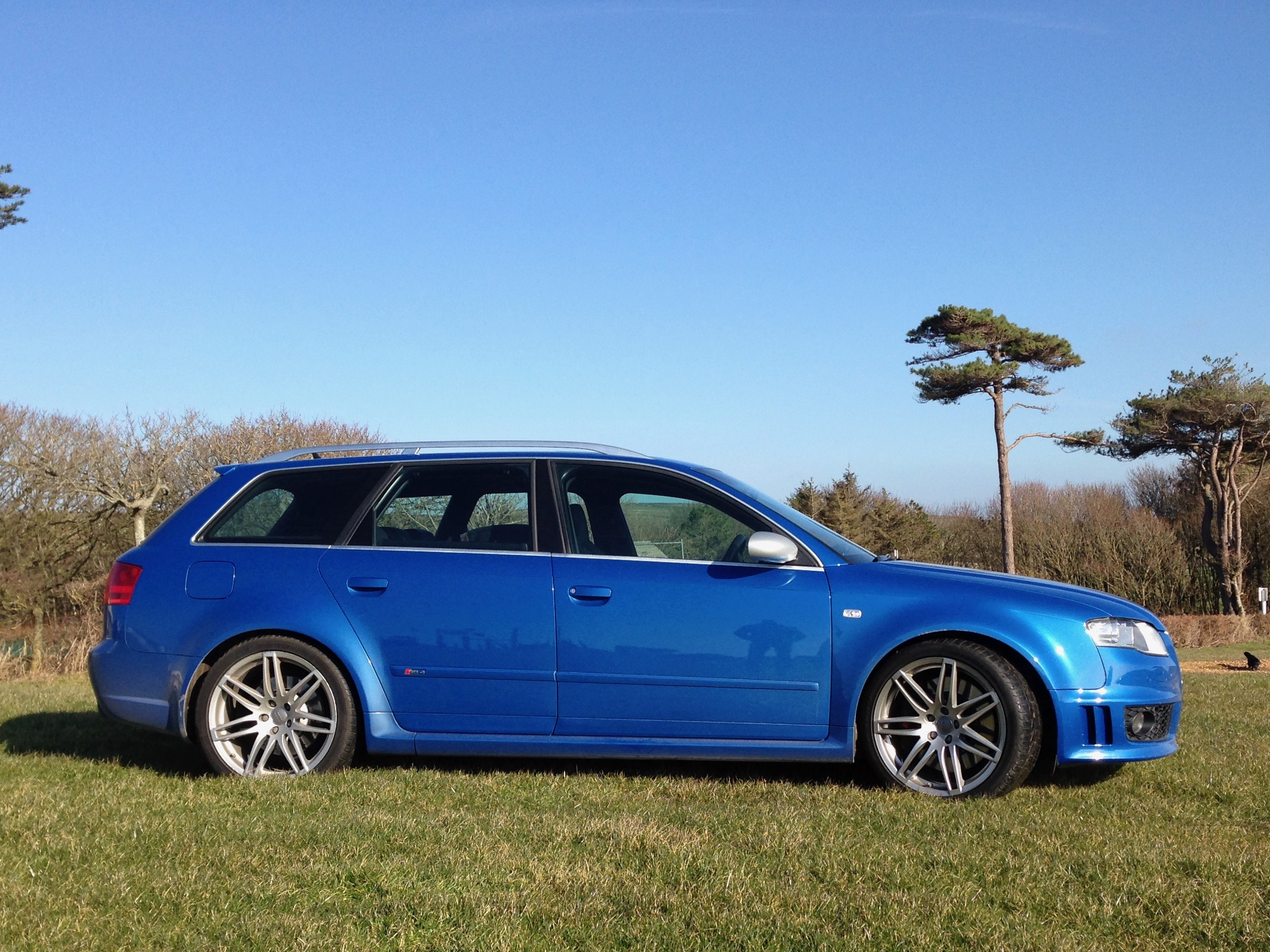

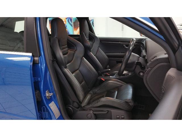

Here it is the beauty.
It's such a good feeling to have it all working properly again.

Very smart
