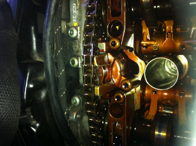

Plastic guide on tensioner is completely gone, as seen in image.
Guides can be bought separately from ebay etc, or should I change complete tensioner?
Is there way to check that valves are ok?

Check the valves? Heads out, which means the engine out.
Maybe using a borescope camera would help to check the valves, but not sure, the view is limited and you would need a very flexible cord to bend it upwards inside the cylinder to see the valves.

Chain guides normally wear due to slack chains
Re: Strange ticking sound (video)
Next plan is to change guides and chain, is there anything else that should be done at the same time?
