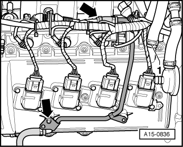

is it this one which has to be flexed?

Post by Mr Footlong » Mon Apr 16, 2012 2:55 pm
Might be being thick but from the picture that pipe looks like it has easily reachable clamping/replacement points by the 2 arrows so wouldn't have thought so?

Posts: 20285
Re: Rocker cover gasket
Post by Shoppinit » Mon Apr 16, 2012 9:34 pm
Yeah, can't see the fuss. You have to move it to get the plugs out (see FAQ).
