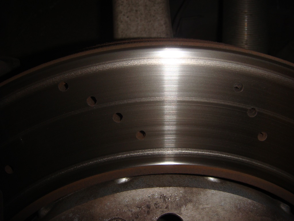

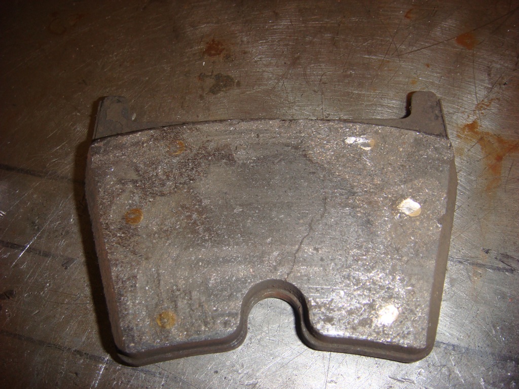

This is what kills your disks. Another knobbly bit, but hidden inside the pad material this time. There are about 6 per pads and they groove the disk even though there is at least 8mm of pad left. If you are still running the OEM Pagids, then you need to keep an eye on your disks.

Ben, you are killing me here................ I have all my new discs sitting here for me to poss fit on Saturday and I have a set of Pagid pads that did approx 100 miles before I won them for a whopping £23 on Ebay! On top of every other part of that car that is financially deep filling my bunghole currently, I not have to be cautious of that? I knew about the 6 metal studs in the pads but thought they were far deeper in to the pads than that! There is a pic here from the Yellow Dog Racing brake change page that I have attached - http://www.yellowdogracing.com/Audibrakes.htm
"The old rotors. You can see where the brass brads in the brake pads have marked the rotors." - Erm, yep!
