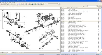

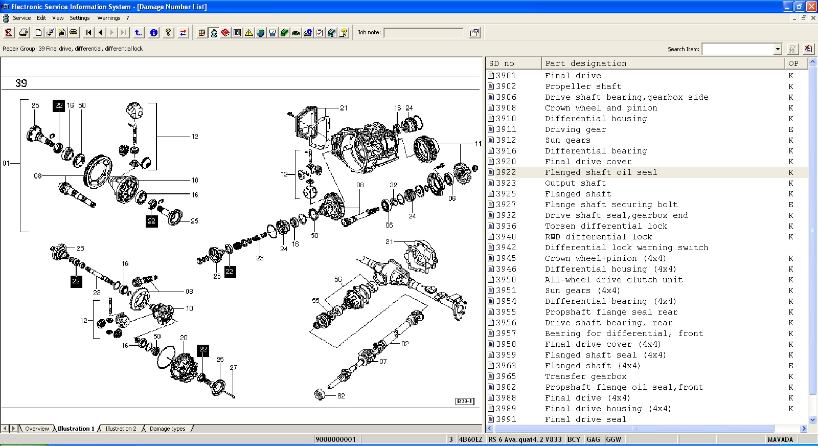

Re: Rear gearbox/driveshaft seal
this is what they replaced...
Mugello Blue C5 RS6 Avant
Viper Tuning ECU/TCU
Yellow Koni's
Yellow Koni's
Which bit?
sorry, 22
