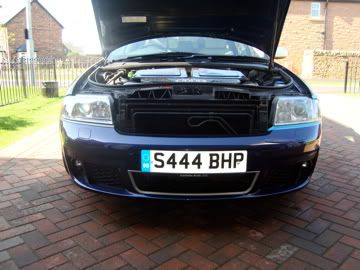

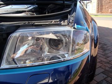

Front - difference between old and new lamp lenses:
New lamp is of course immaculate:

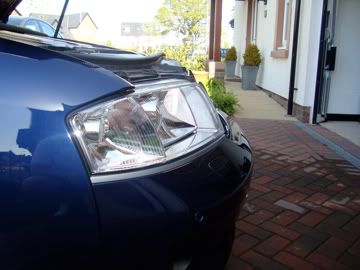

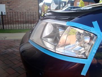

Old lamp, trim already masked off and its scratched and aged appearance:

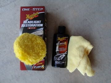

The Meguire's Kit:
Kit contents:

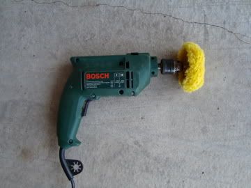

Polishing head attached to drill:

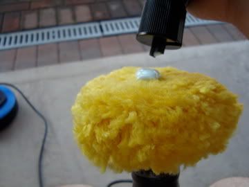

Applying Plastrx gel to the head - several applications were required:

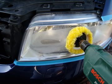

Applying to the headlamp lense - again several applications were needed as it's a gentle polishing gel - not too abrasive:

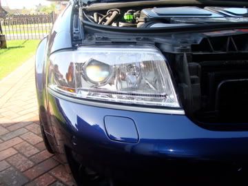

Old lamp now shiny and bright looking:
