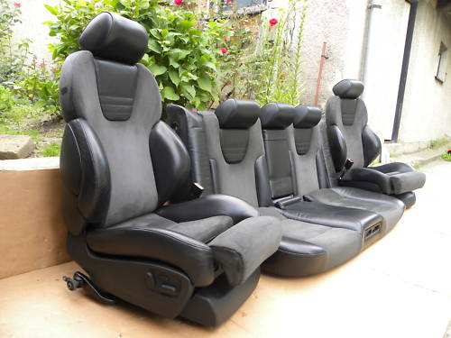

Hi guys been looking at this interior for my 04 Rs6 maybe not everyones cup of tea but i've fell in love with it as i have complete leather and the alcantara would match my head lining a treat, here's the bad news that could break my heart it's form a left hand drive car same year and both with the same functions heated, adjustment and bolster, i know it hasn't got RS6 embossed but i think i could live with that as the previous owner didn't take great care of the leather in my car, SO will it fit in mine i ask :?:
Thanks guys over to you for some good news for me i hope! Sean

I'm 99% sure it will fit. I'll have a look at the part numbers.

I don't see any difference in the part numbers for left and right hand drive. For other parts that are handed, it always says whether it's for RHD. I'd say you're good to go.
Very nice looking interior that. Why hasn't it got RS6 embossed? Did it not come from an RS6?

I believe so? All i can say is that it is advertised as so! did the european models come with it embossed? It has the recaro embossed i can see in the other pics i have but no RS6. Not sure i'm bothered tho i love it!!! The same combo i had in my Q7 nice looking leather with no sweaty ass! :jump: Thanks again shop you have sorted me out again! Where do you search your part numbers as i looked for an hour today and nothing. Cheers. Sean

Try vagcat.com. You'll need to register. Or ETKA if you can be bothered to source it. The truth is out there...
All RS6 (other than north american market) have the embossing. Maybe it's from an A6 or S6. Doesn't really matter. I'd actually prefer mine not to say RS6 on them because I like to maintain a low profile.

It will fit.
The only thing that would cause problems is if there are matching door cards due to the controls on the drivers side card being on the passenger side.

@Silversea: you're quite right, the door trim at the front is rhd specific, but I got the impression that the interior that was being talked about was only the seats. If sean's got black leather then he can leave his originals.

Some S6 seats came without embossed logo, so they're S6 or A6 sport seats. They'll fit.

Hi guys yeah it's just the seats in the pic, my door cards are black/leather so hopefully going to look qqqqwwwuality??
