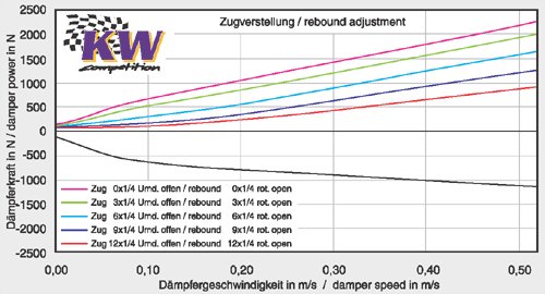

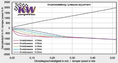

Are these graphs specific for the RS6 or all KW V3 dampers?

As for the charts, I think they are for all the v3's with minor differences for a specific car. I got them from the main KW web site a few weeks ago. I'll have another look later and get back to you on that.
