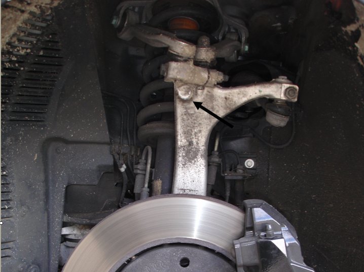

Watch that suspension... I have had 255/35/19's rub the suspension, as tyre batching tollerances are very poor, you can see where it rubs from an old photo of mine below:
Present:...
Past:

I think i will let the wheels go, i dont want to open a can of worms with tyre tollerences etc.....
The wheels are 19" 235 35 at the moment i think , i also think we will just keep them that way for now. I only got the car on Saturday and im already totaly smitten, love it love it love it.......
