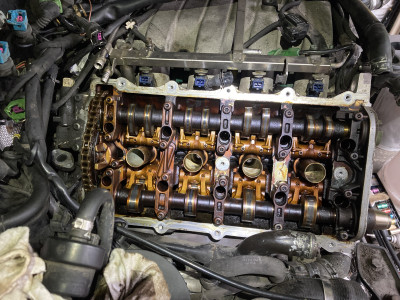

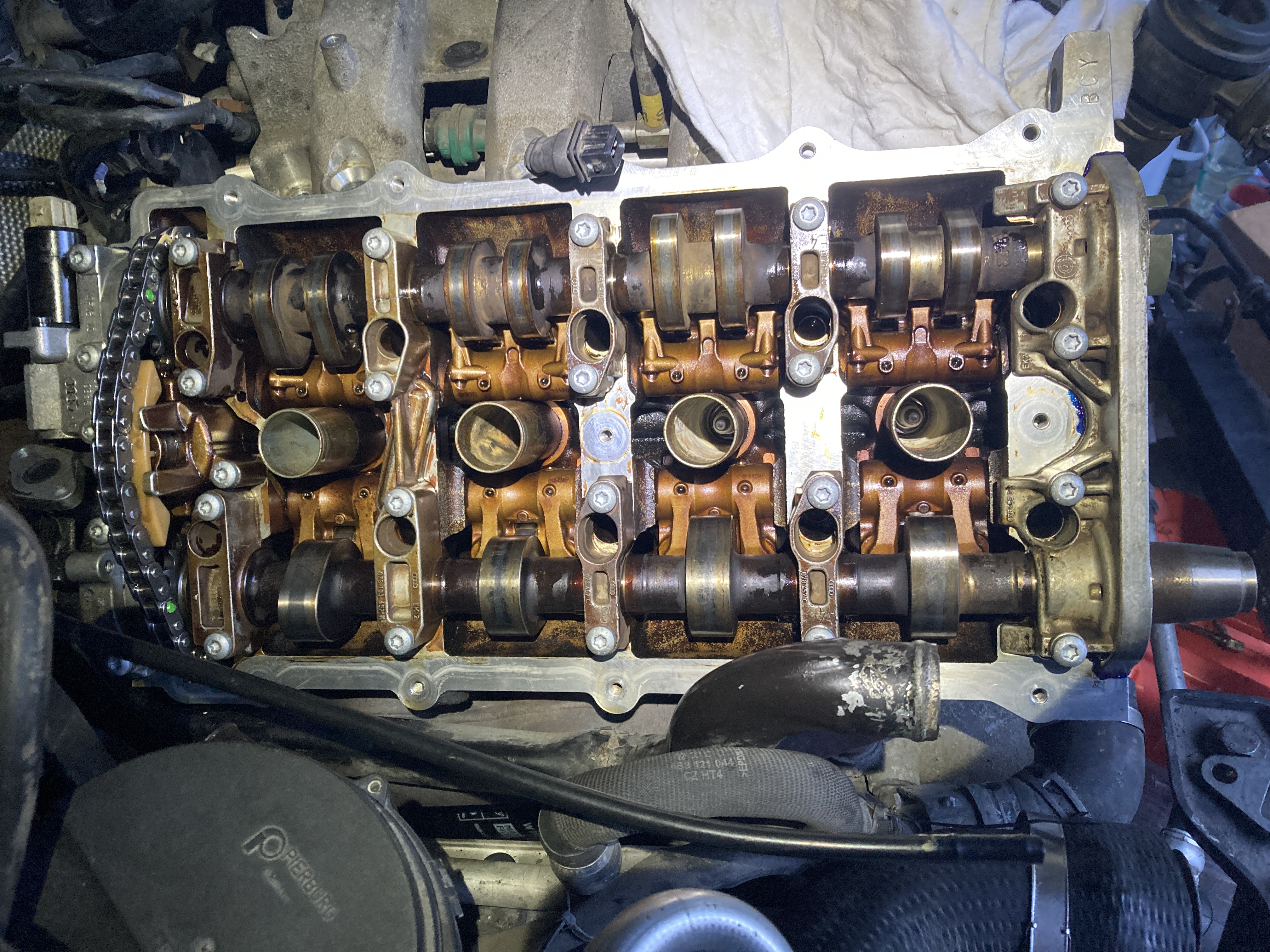

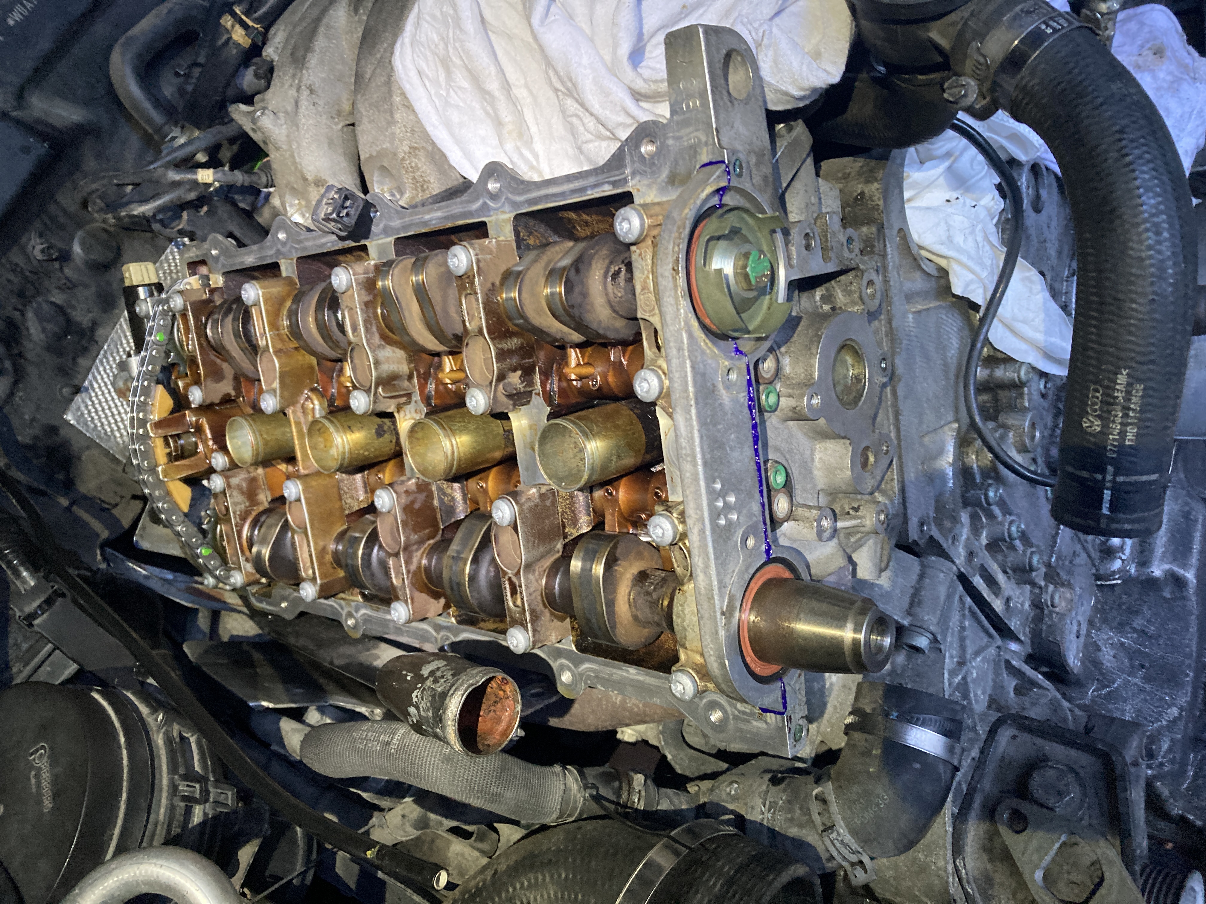

Yeah, the water pipe has a bolt under the valve cover, remove it and move the pipe carefully out if the way enough to get the cover off. On same side it helps to remove the fuel line along with the fuel rail (first pictures, last one is with the fuel rail partially loosened ). Combi valve as well, but it’s a pain to put back. I cut a Allen wrench to fit in there…

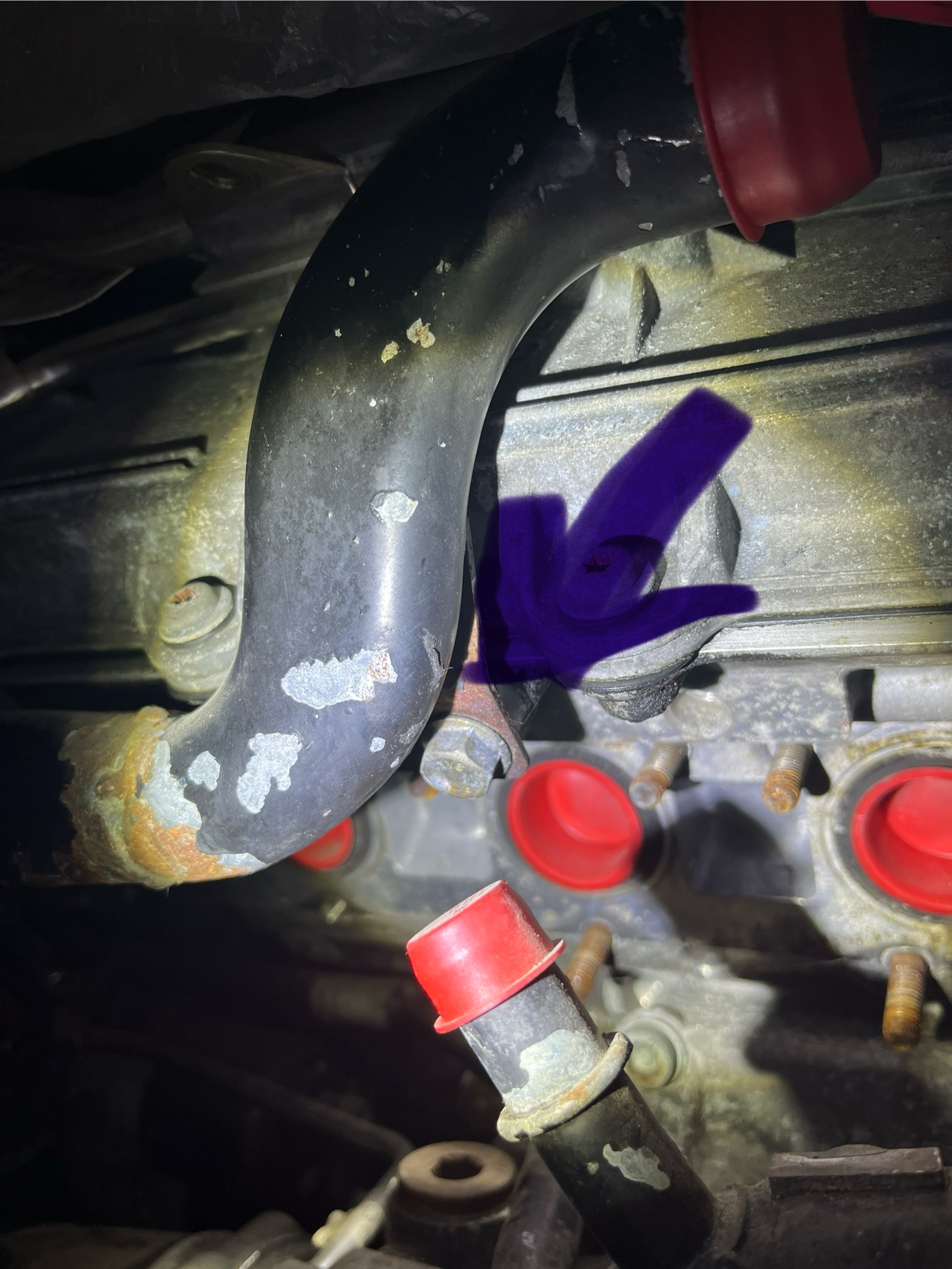

I am currently in the process of doing this myself, a couple quick questions, the bolt for the water pipe, does anyone have a picture of where its at? I have tried searching the web and can not find any good information on it. Do you have to put the car in service mode to reach it? Also, kind of a dumb question, but after removing the 4 bolts holding the fuel rail in and disconnecting the pipes, do it just pull out with the injectors attached? I feel like its really stuck in there any dont feel like breaking anything....yet

You can loosen the back 2 bolts holding the fuel rail enough to have some play, but to answer your question yes, there are 3 Allen bolts plus one ground nut/bolts setups to remove if you want to remove the entire fuel rail. The service manual calls for new rubber seals if you remove the injectors. I would definitely blow some compressed air before you remove the rail and clean all the injectors/seals/seat holes really well (I used a sound wave machine for cleaning jewelry to clean the injectors) after you remove them. Or you can use a small brush (old toothbrush) with clean gasoline (petrol in U.K. I believe) to clean everything . Also use engine oil on the injector seals prior to re-install for ease and per service manual
Anyway here’s a picture of the bolt… engine is removed, no exhaust manifold and other bits in the way (just for picture reference, and no need to put car is service mode for valve covers I don’t think as I did a full service with timing belt so the end was off but come to think of it maybe you can get away without).
