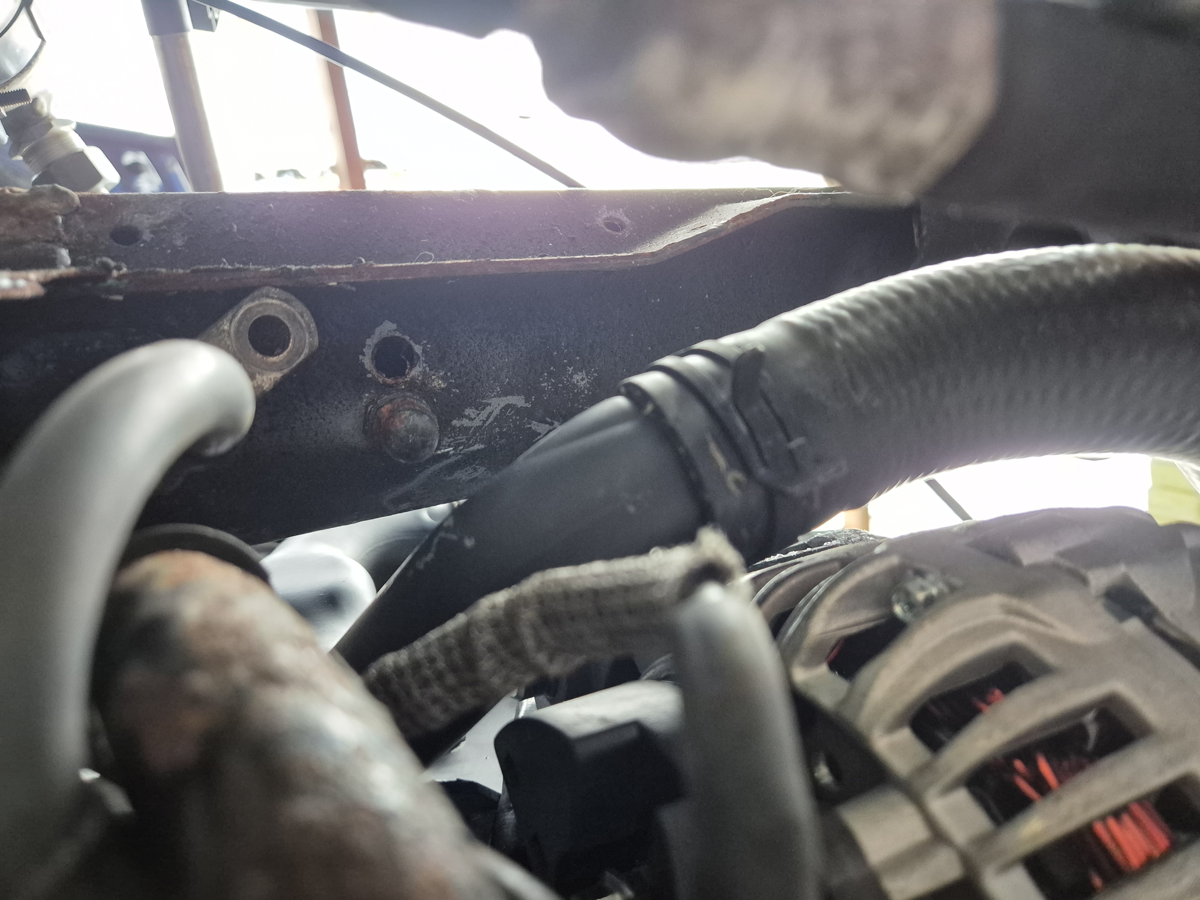

bilko1
Posts: 1872
Re: ground wire
Post by bilko1 » Tue Jan 14, 2025 6:05 pm
It goes from the rear of the starter bracket to the chassis leg above the alternator. I've just removed the alternator as it decided to pack up after doing the cambelt :audibash: :audibash: :audibash: If you need better pictures I'll get them when its light.

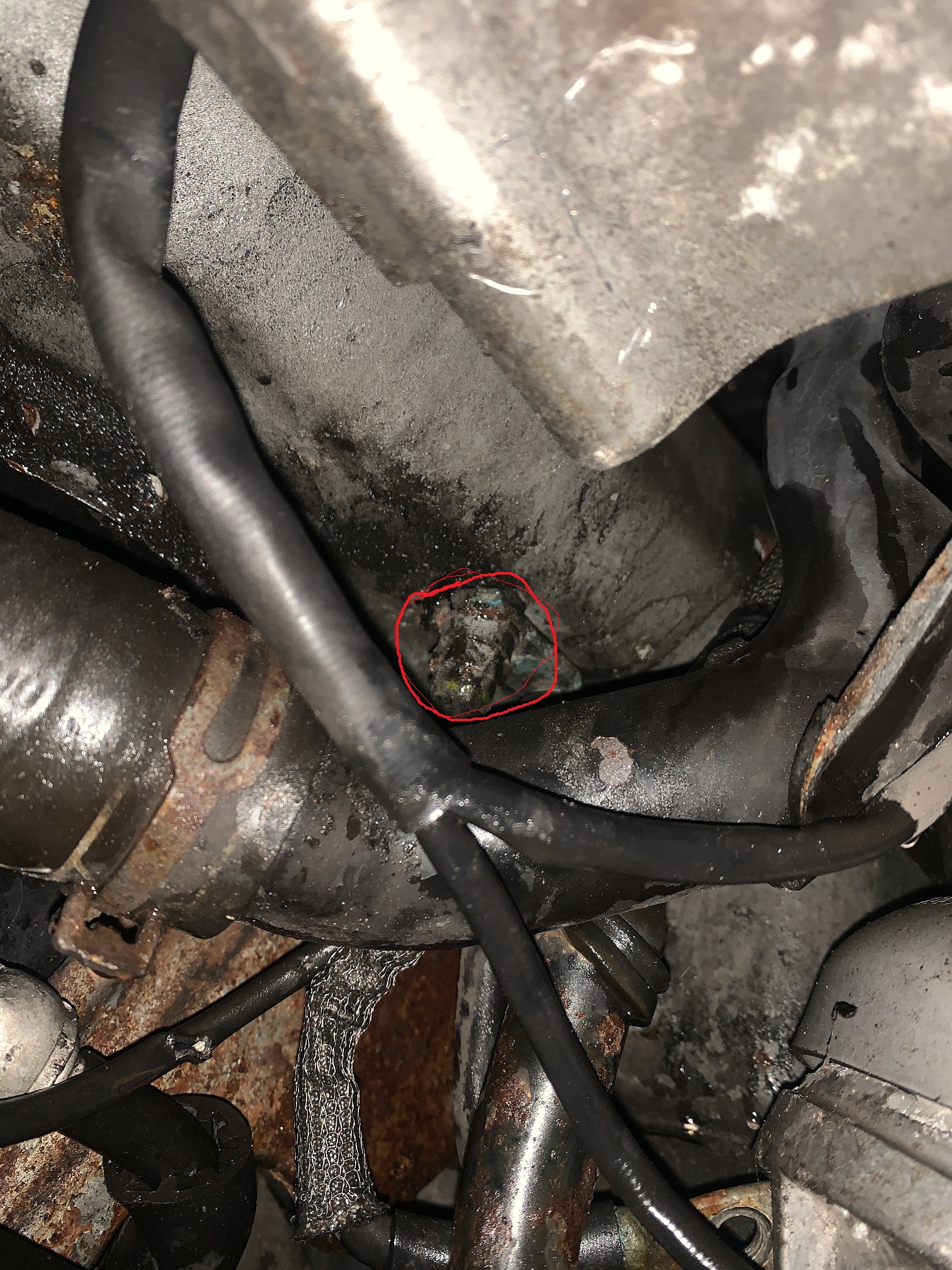

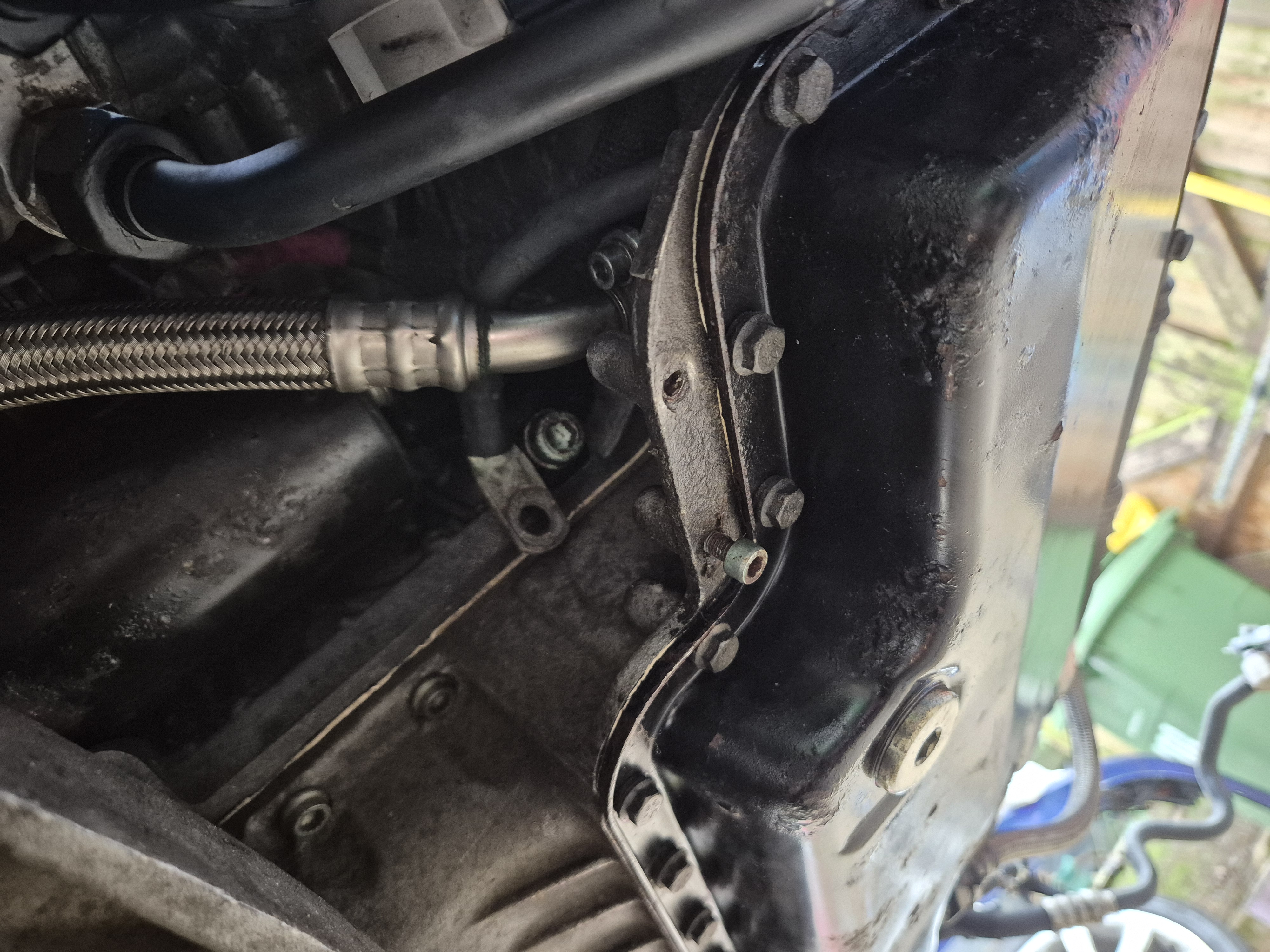

111marc111
Posts: 69
Joined: Tue Aug 02, 2022 7:22 pm
Re: ground wire
Post by 111marc111 » Tue Jan 21, 2025 4:32 pm
Sorry for the delay. Not had chance to get near the car. See pics if you havent found them and solved it already
