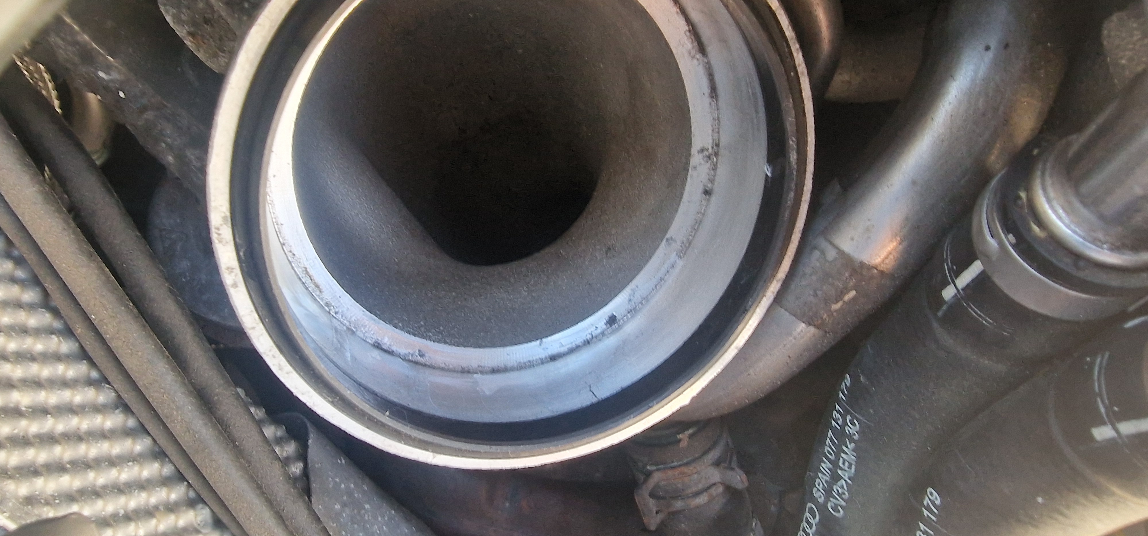

heres an alternative to the very expensive audi gaskets, these are hydraulic wiper gaskets and they hold much better than the audi offering,
£14 A Pair.
Its not rocket science do it yourself.

Hmm Interesting, my seals are in quite good shape and I used a small amount of rubber grease on them last time around. One of the biggest challenges is getting the airbox to sit nicely as the looms get in the way and try to push it up (at least on the LHD cars.)

these sit well, you need to clean off the ally with some brake cleaner and scuff it up with a scotch pad then a bit of glue gorrila is good, ill post a link when i get back to my laptop,

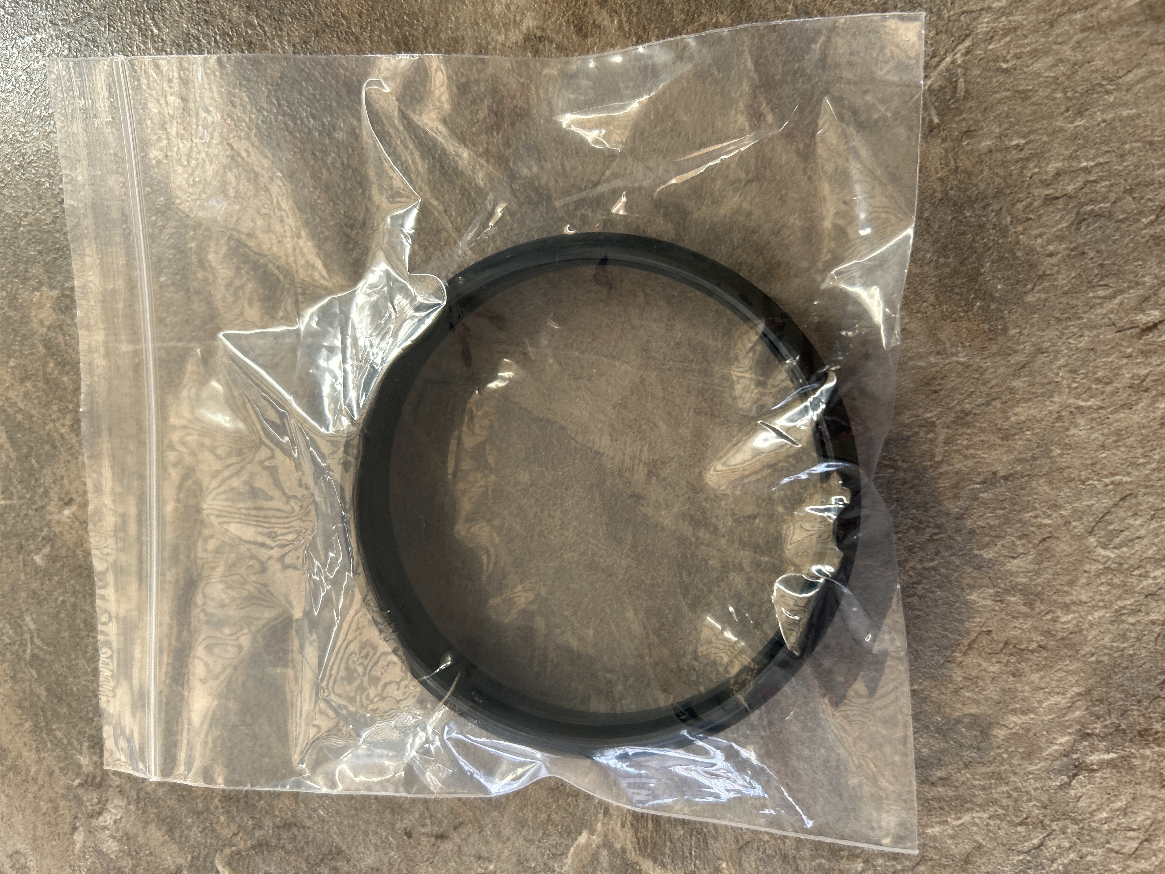

Just been on their site in Cork Ireland. About 16 in stock at the moment.
I have Ordered two. Very reasonably priced £14 including delivery.

Seals arrived today. They look good for the price.
