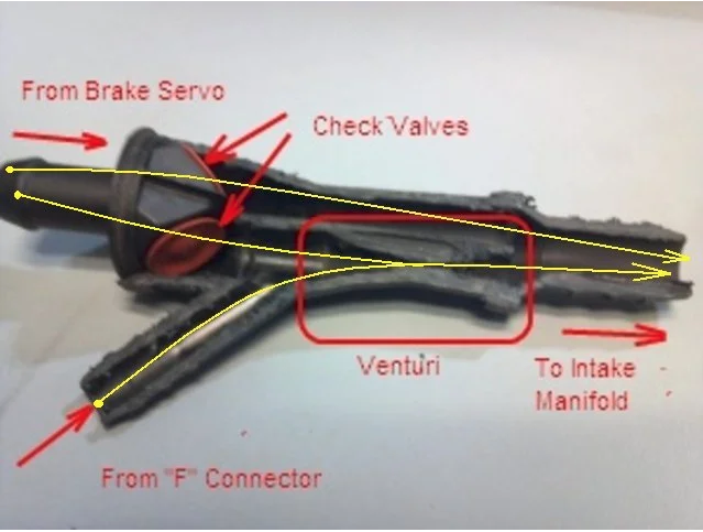

TOPMAN
Posts: 235
Joined: Wed Mar 09, 2022 4:41 pm
Location: Finland
Re: SJP continued
Post by TOPMAN » Thu Oct 03, 2024 2:10 pm
steve2003rs6 wrote:
Thu Oct 03, 2024 1:53 pm
suction jet pump = brake booster valve ?
Are they the same thing.
A brake booster valve in the traditional sense is a one-way vacuum pipe valve connected to the booster. The role of the SJP is different in the way that it uses the venturi effect to improve vacuum when you first take your foot off of the accelerator pedal.
