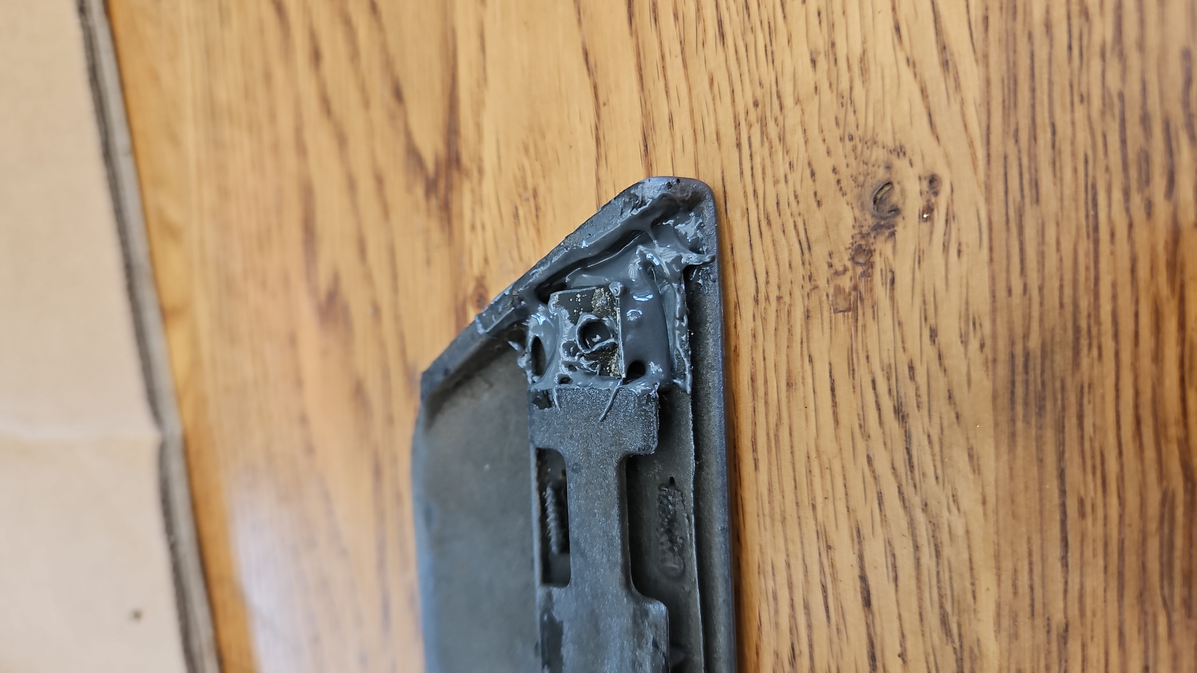

Panic over ,once I seen how much a set of blades where on eBay I thought I'd best nip out and see if I could find it , retraced my drive and luckily i found it just passed a speed bump not far from the house , speed bump must of dislodged it.
Will have to investigate the tabs as I think some have broken ,might see if I can 3d print some replacements and epoxy them on.
Re: Door blade disappeared

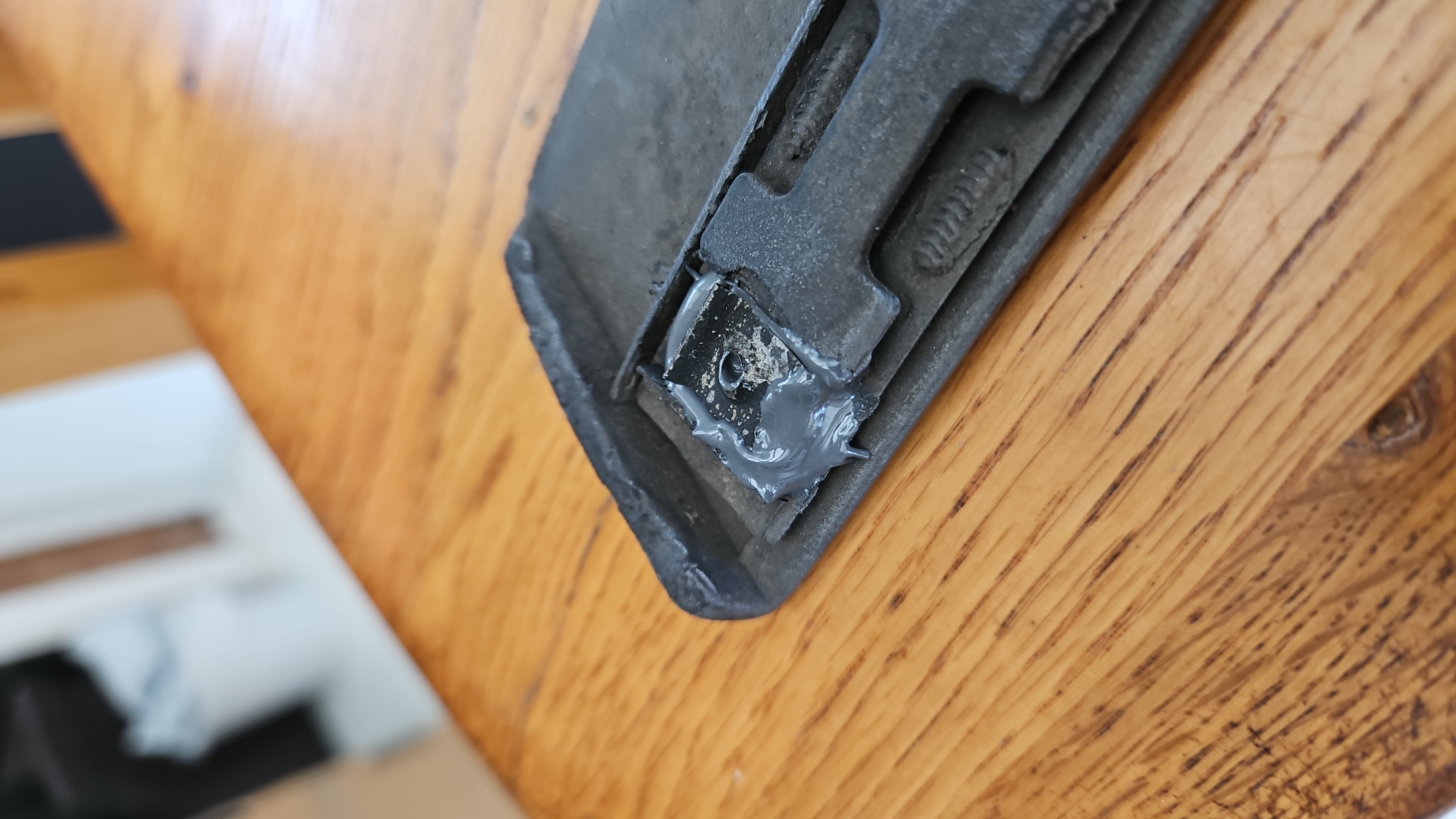

Once I found the missing door blade I noticed that it had been siliconed on rather than screwed in , where the screw receiver's fit onto the door blades is missing , its broken.
Once I looked at the door I could see that the screw holes where full of silicone where the previous owner had tried to use silicone to adhere it to the door.
So I broke out the epoxy I had left over from sealing the intercoolers and epoxied some screw inserts in to the mounting points so i could use screw again to secure it to the door.
Its not pretty but the door blade is now securely fixed to the door. I think I need to remove and repair a few other door blades as they seem to be loose.
Hope this might help anyone who needs to repair a dodgy door blade.
