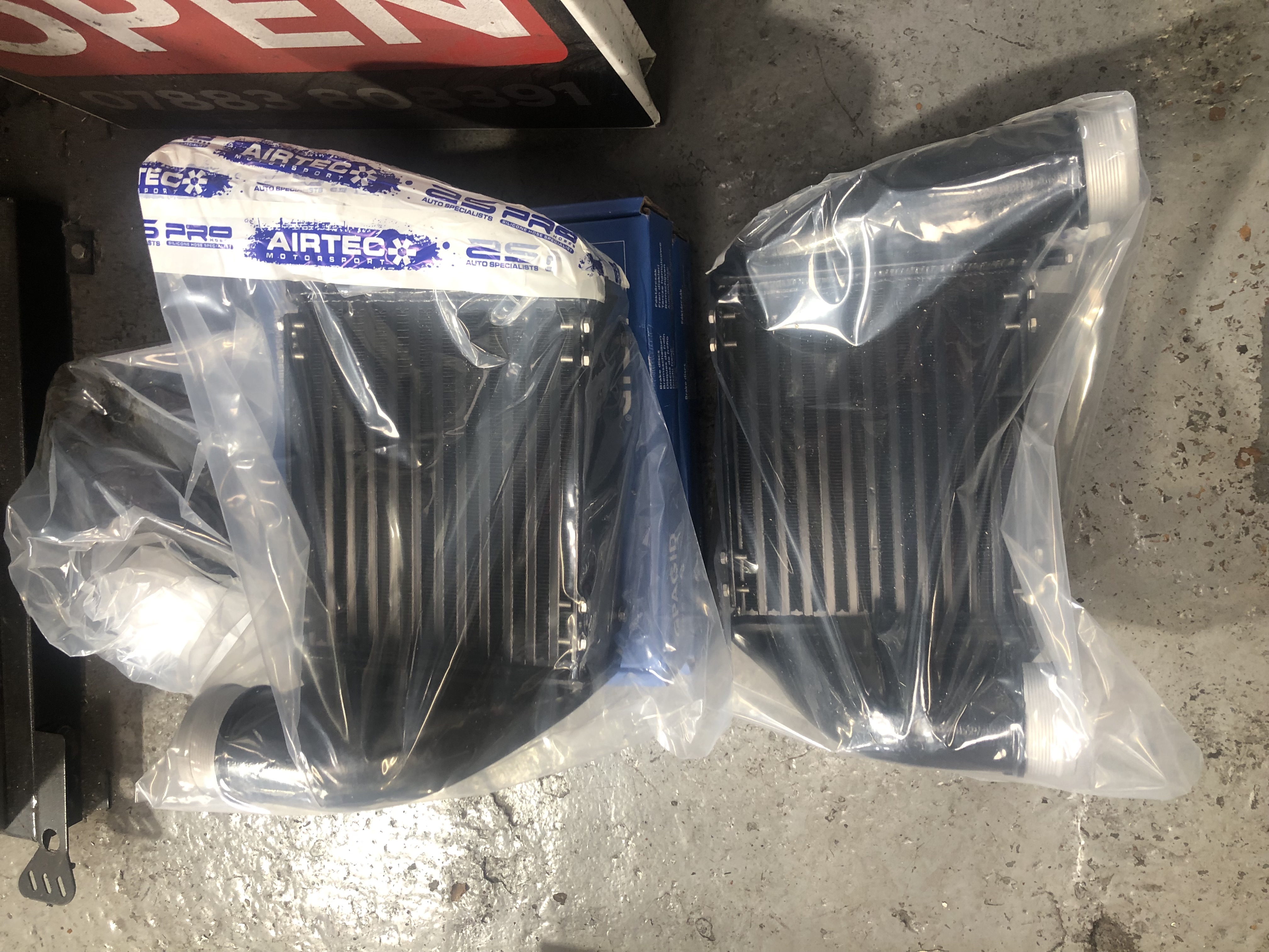

Had the Airtec fully refurbished intercoolers for a while now. They did a great job.

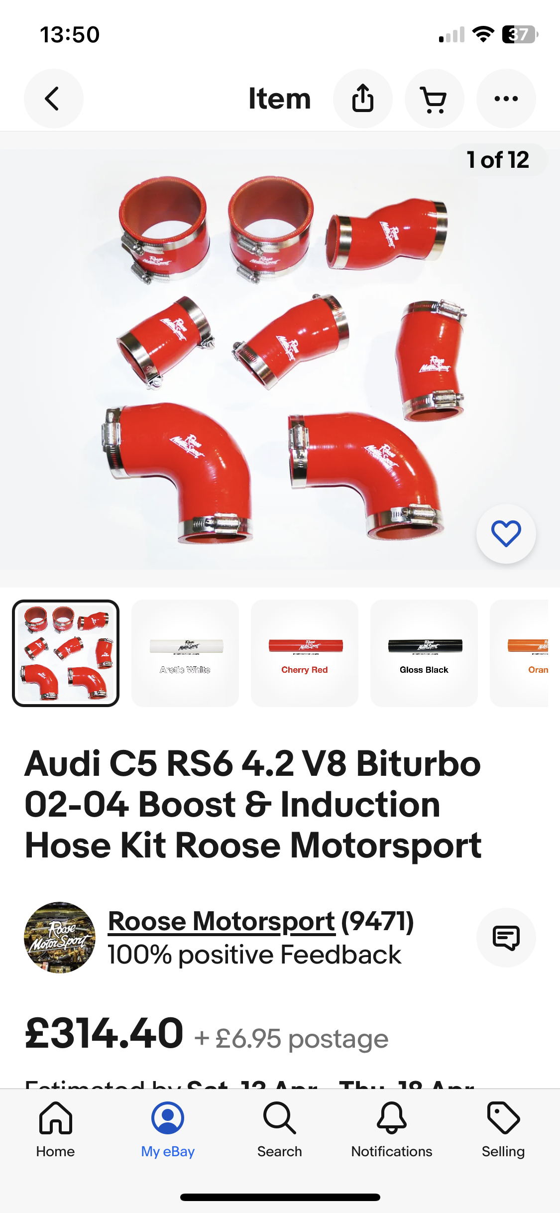

Just received the Roose Motorsport silicon hoses and s/s clamps. Similar to those in photo but mine are black.

Those Roose motorsport hoses are nice. The only upgrade I recommend is switching the hose clamps for the BLACK stainless steel mikalor W3 ones - they look great on the red hoses.

Hi Matt. My silicon hoses are black not red mate.
I wanted to replicate the original black hoses.

Update.
Today the original inter coolers that were fully refurbished by Airtec were installed. A little bit of modification required as the coolers are now a bit wider than their original sizes.
The Roose motorsport silicon hoses and stainless steel clamps were installed, which are a nice upgrade from the original rubber hoses.

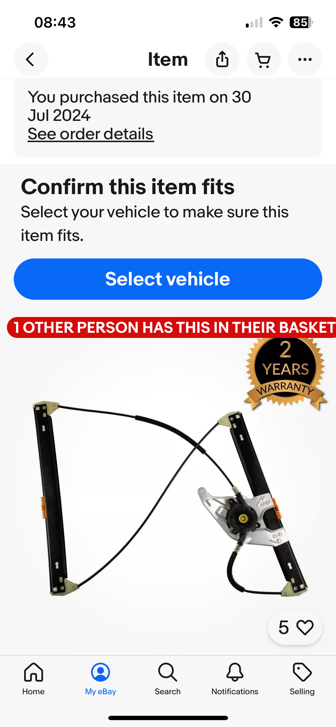

Last week the front passenger window was playing up.
The faulty regulator had to be renewed which is riveted in place with 4 rivets. Had to order the 4 special sized rivets. I thought they would come with the regulator, but no they come separately.

This was the regulator I went for as it was in stock and cost about £25.00.
