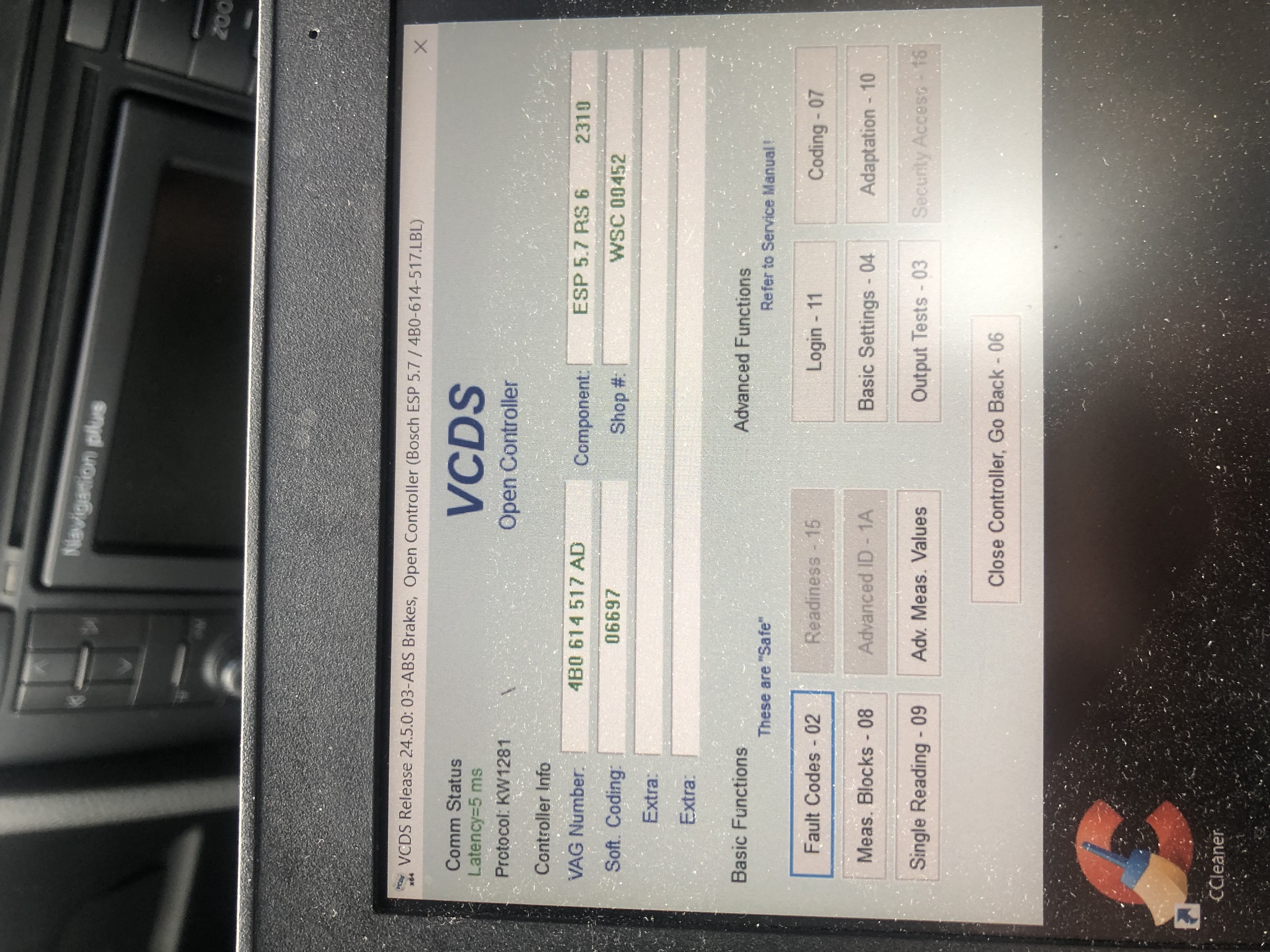

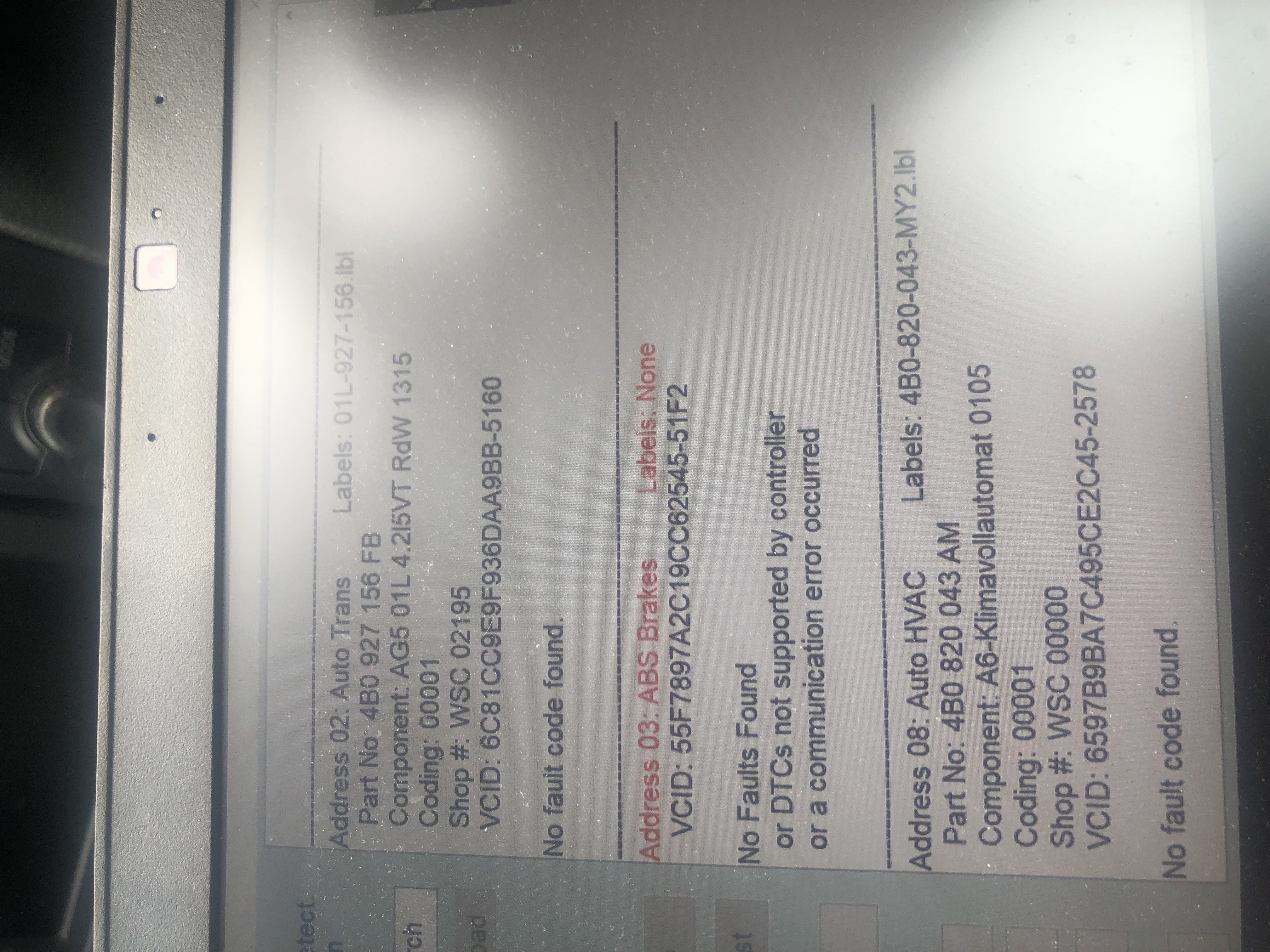

Anyone know what this means.
Re: Brakes-vcds flag
Hasn’t found the label file for your ABS controller.
Might be an issue with your VCDS installation.
Try updating to latest version after uninstalling the one you’ve got.

Have you installed or updated your antivirus recently? Try installing your AV and/or firewall and seeing if you can connect then. Obvs don't use your laptop on the internet without those things running.

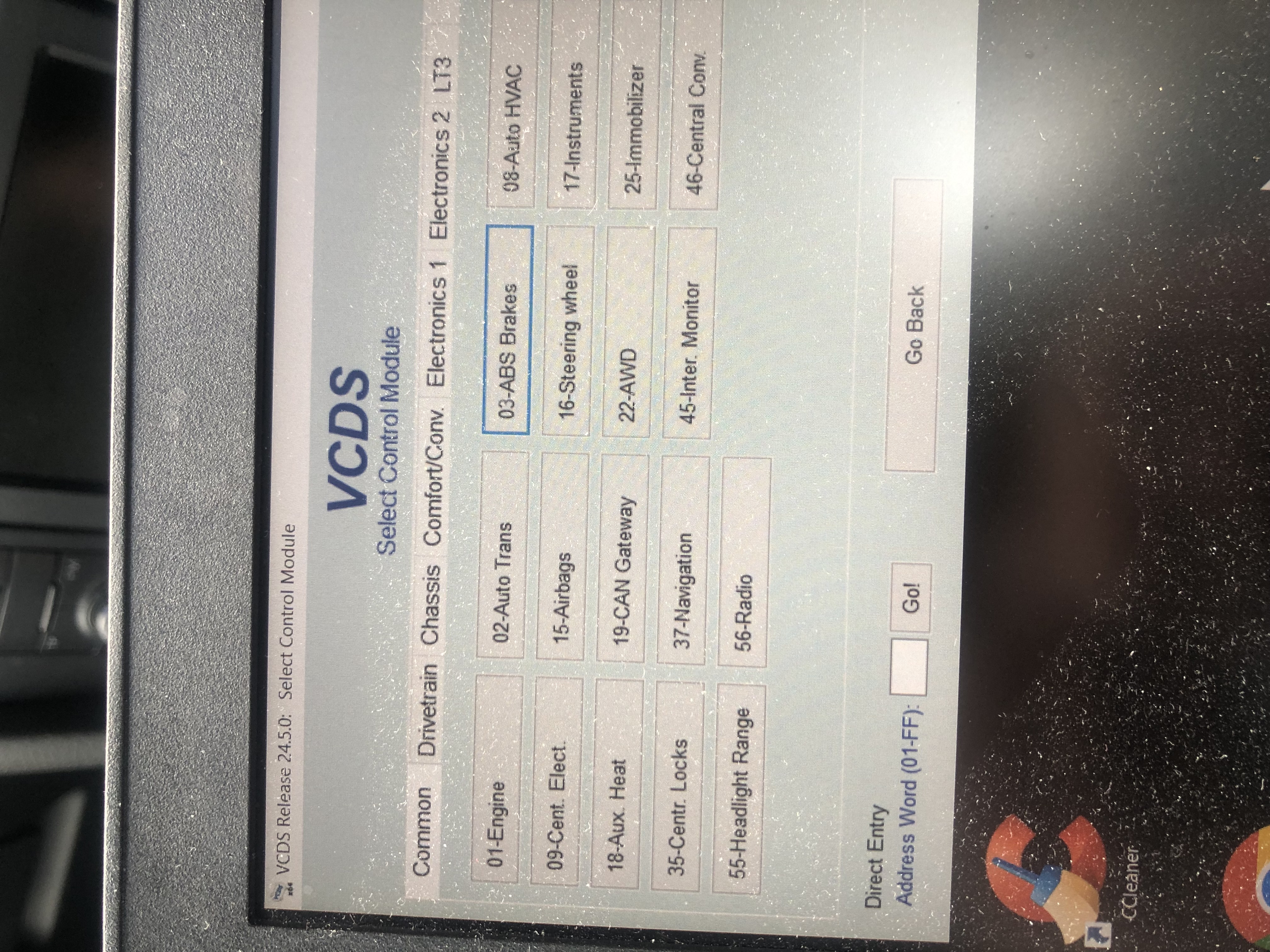

If I go into control module then select abs brakes the brakes are recognised.
Sounds like the autoscan settings are off then. Maybe you've checked or unchecked an option. Since you have a genuine cable, you can contact VCDS support on their forum, too.
Whenever updating a version of anything it's always worth checking through all the preferences to make sure they haven't been fiddled with. Annoys me endlessly when this happens.
- Posts: 2955
It was ok before I updated to version 24.5.
Yep. They'll have changed something. It's just a matter of working out what. I'd email them and see if they have had other people encounter the same issue.
