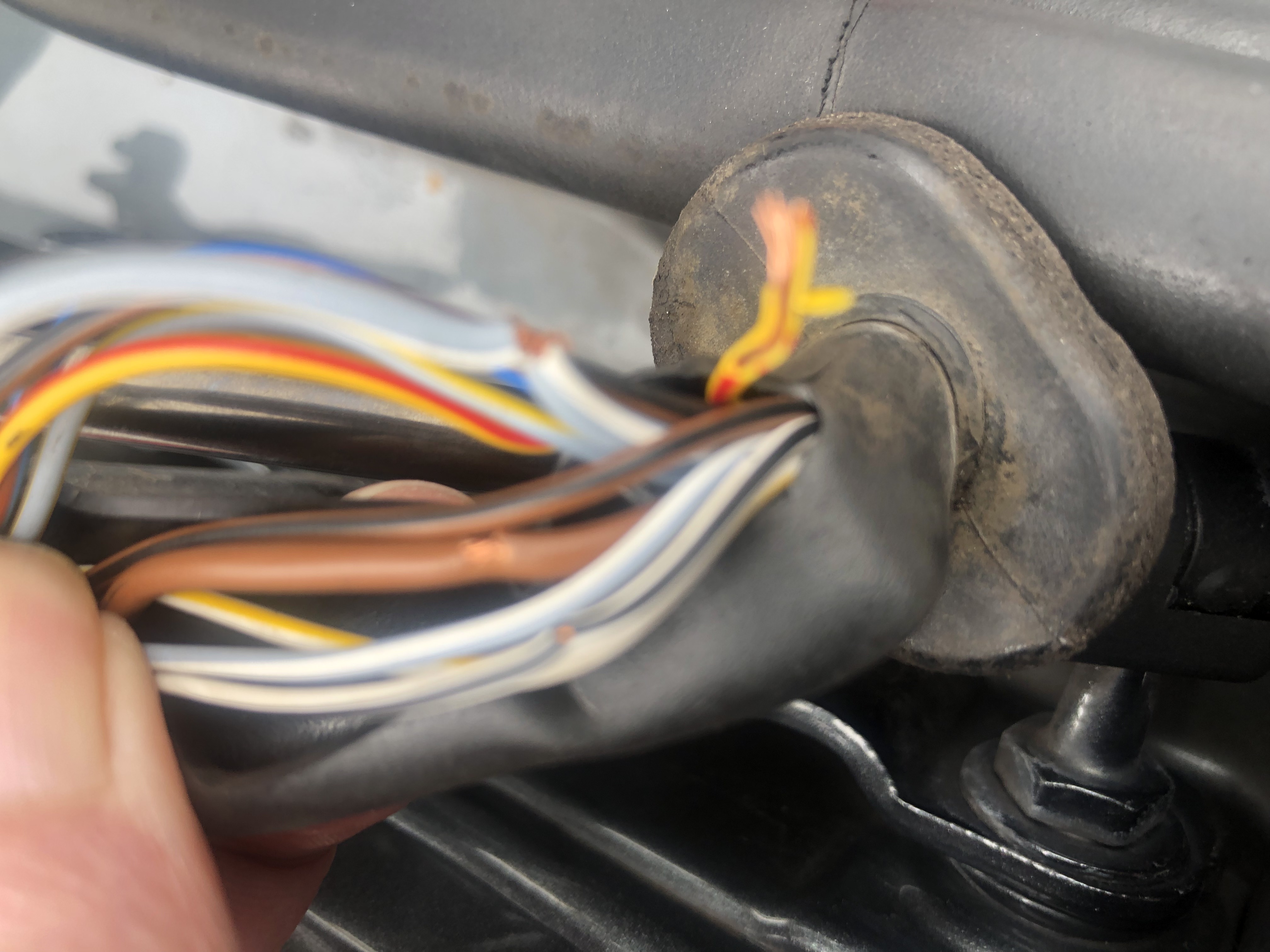

As I see it. The car failed on a non working fog light bulb.
The front pads wearing thin was a advisory.
If I get chance I will pull the bulb and fit a new one.
Ps. What a faff to replace a light bulb on a saloon. The whole boot lid trim has to be removed.

I was hoping it was a fuse ? No such luck so I will have to remove the trim to gain access to the bulb.

Finally found the problem. 4 wires cut through due to opening and closing the boot over the years.
Thankfully job done.

Good find. Can be a real pain in the ass trying to find broken wires.

Knowing what you’re like with your car Steve you’re probably contemplating rewiring the whole car now.steve2003rs6 wrote: ↑Sat Apr 06, 2024 1:02 pmIMG_0810.jpeg
