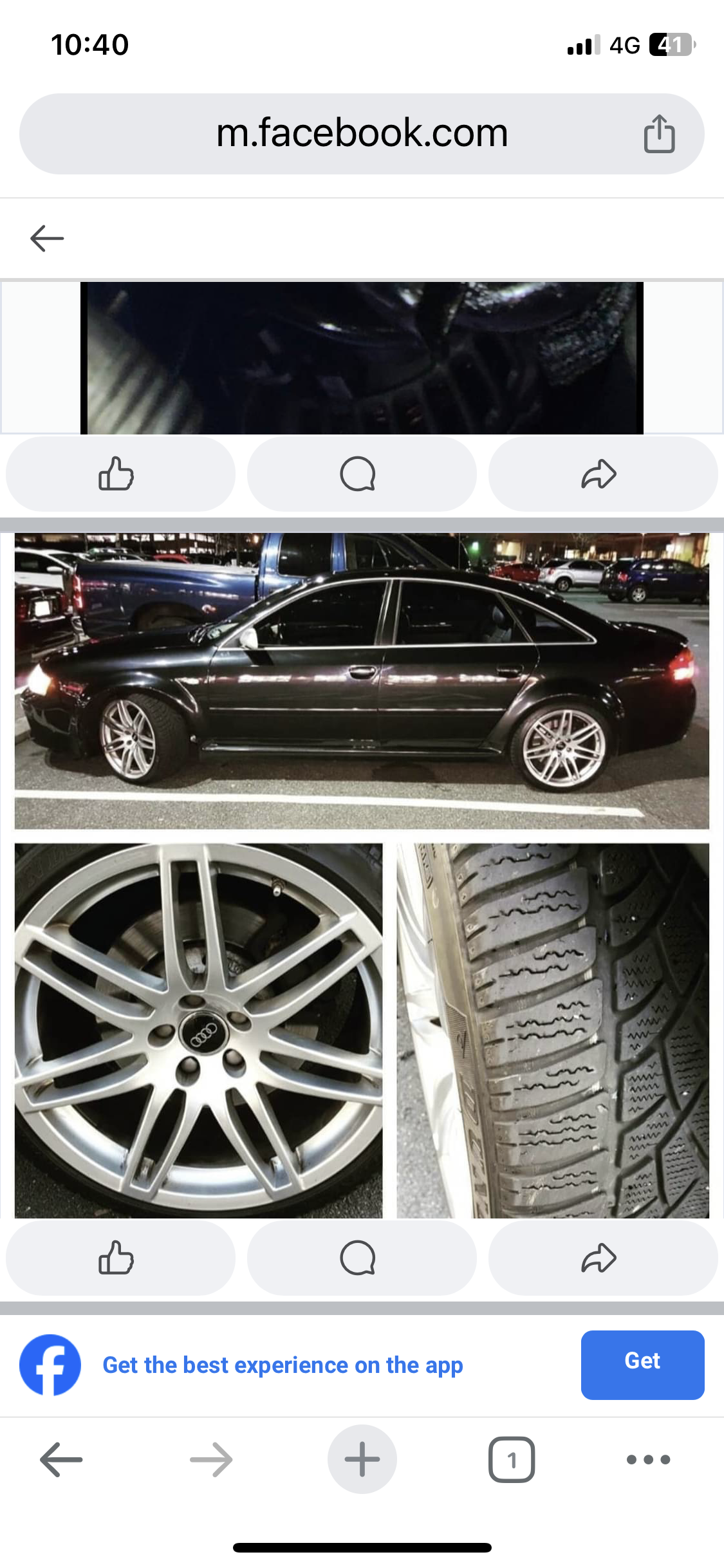

Re: Fitted new TPMS - TX-S001 Direct Fit TPMS Sensor
Hopefully something similar.
Many thanks for your help.
Ps not my car. Similar alloys.
RS4 B7 Audi Le Mans alloys
19x9
Et 29
Perfect fit. No spacers or spigot rings.
Ooh. Those look quite good. My alloys are a bit sad looking. How much do a set of 4 normally go for?
Hi suz. I have been after a set for ages then these came up in gloss black with 1 wheel needing a refurb.
The et on my original wheels was 35. Very close fitting with the front brake caliper.
These are et 29 so stick out a further 6 mm giving extra clearance on the front caliper.
The best bit.
A direct fit no spacers or spigot rings required.
When doing the test fit it was evident that all wheels required powder coating. So opted for a colour change.
Don’t get me wrong the wheels were in great condition but they were not perfect.
There are a few on eBay for sale but genuine Audi RS4 B7 Le Mans with the right et are far and few between.
I paid £550 and £250 for powder coating
I won’t install them until I get some new rubber.
I love them.
