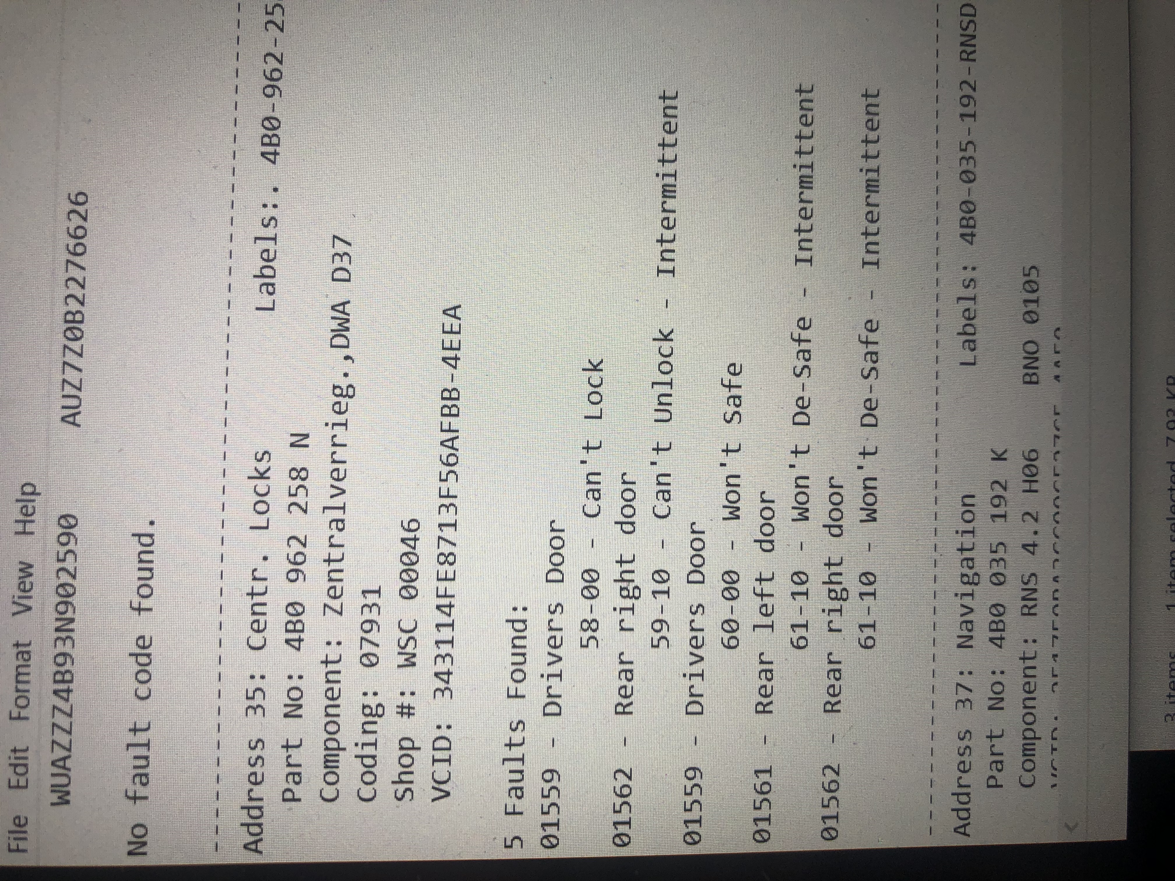

I have changed the door locks three times. Still the errors persist.
Going to change the comfort control module next to see if that sorts it. The one under the passengers carpet.
I have bought a module so just need to have it installed.
