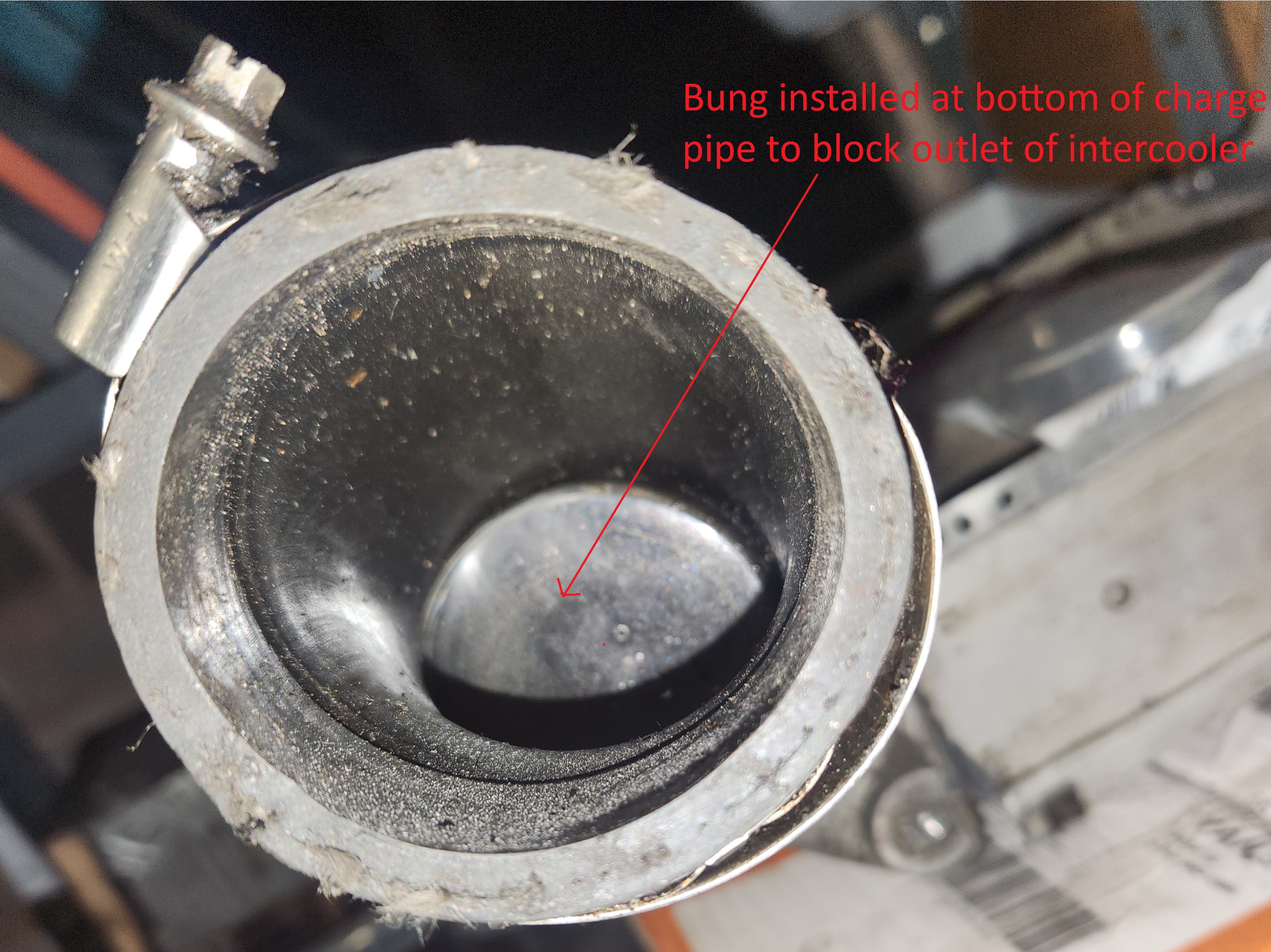

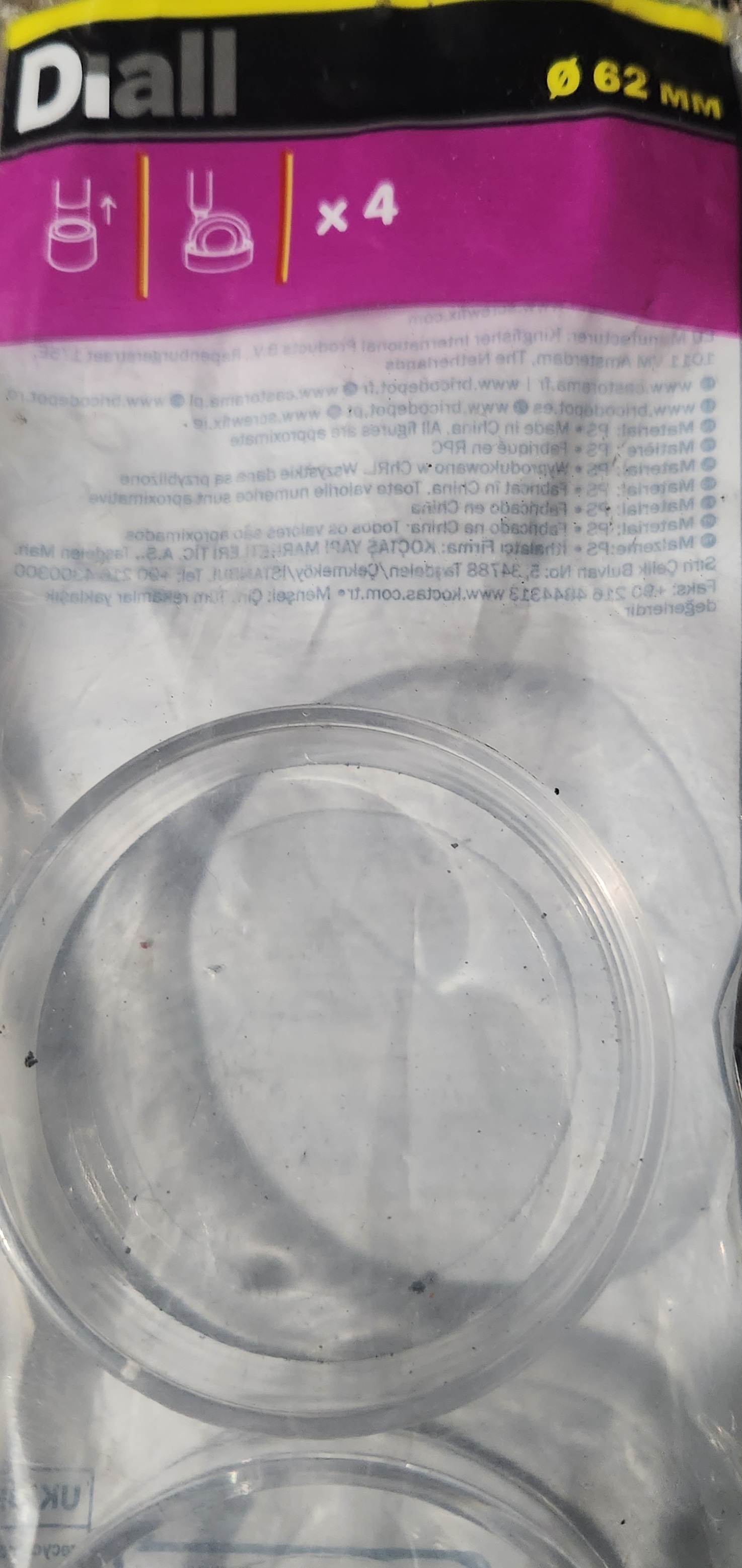

In B&Q they sell plastic cups that you put under the feet of tables etc but they are a perfect fit in the large ends of the intercooler hoses , I used these to seal the hoses to do a pressure test

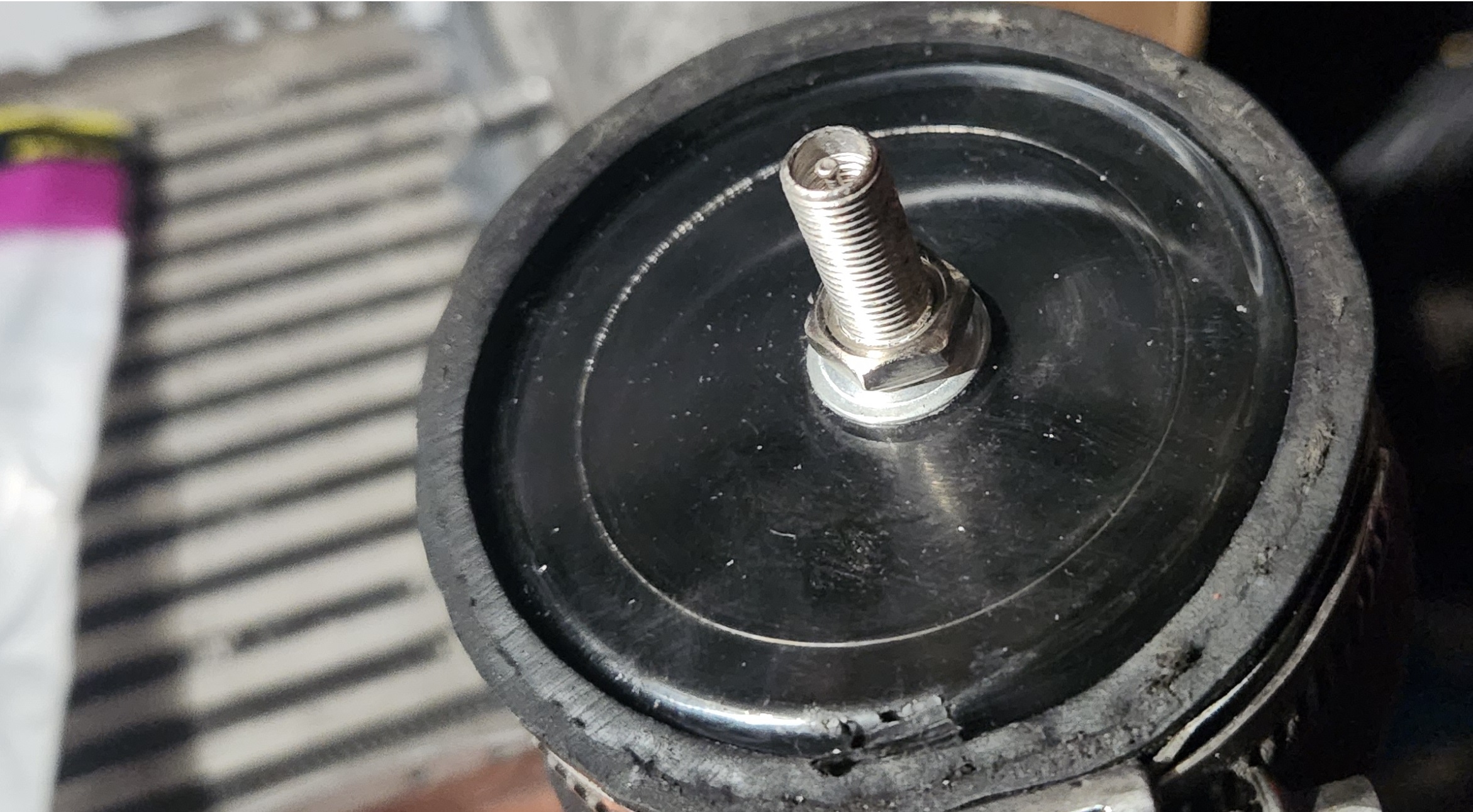

I then bought some threaded schrader valves from amazon
https://www.amazon.co.uk/Emma-Motocycle ... 09&sr=8-17
With these 2 parts you have this
It fits perfectly in the large end of the intercoller hose

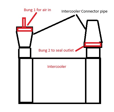

Both hoses have a big and small end , so one hose has a large diameter free and one has the small diameter free , on the small diameter hose side the blank has to be fitted inside the hose by the intercooler output flange
the basic diagram below shows what I am trying to get across
You can use a stand up bike pump with a gauge as this should provide enough pressure.
Dunk the intercooleres in a bucket of water and pump away!!
