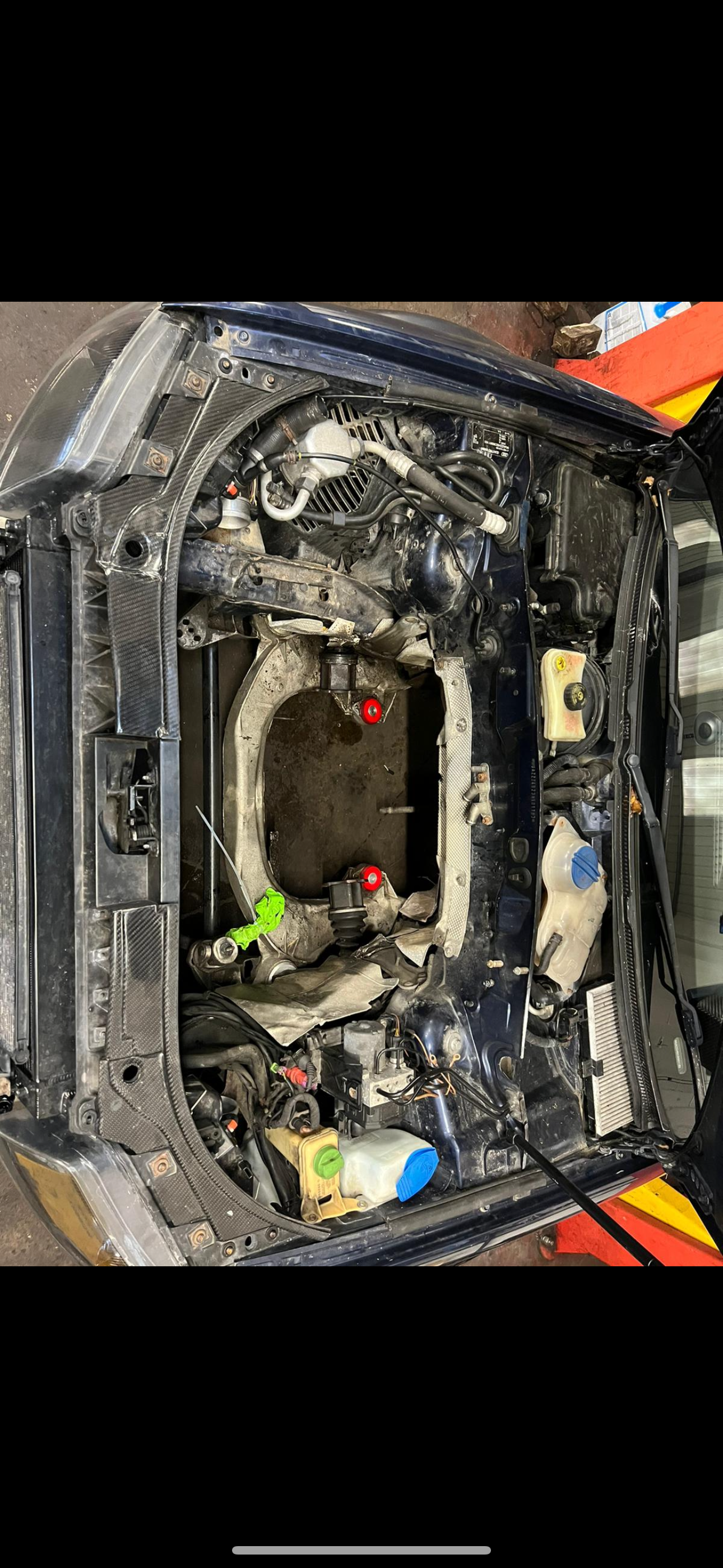

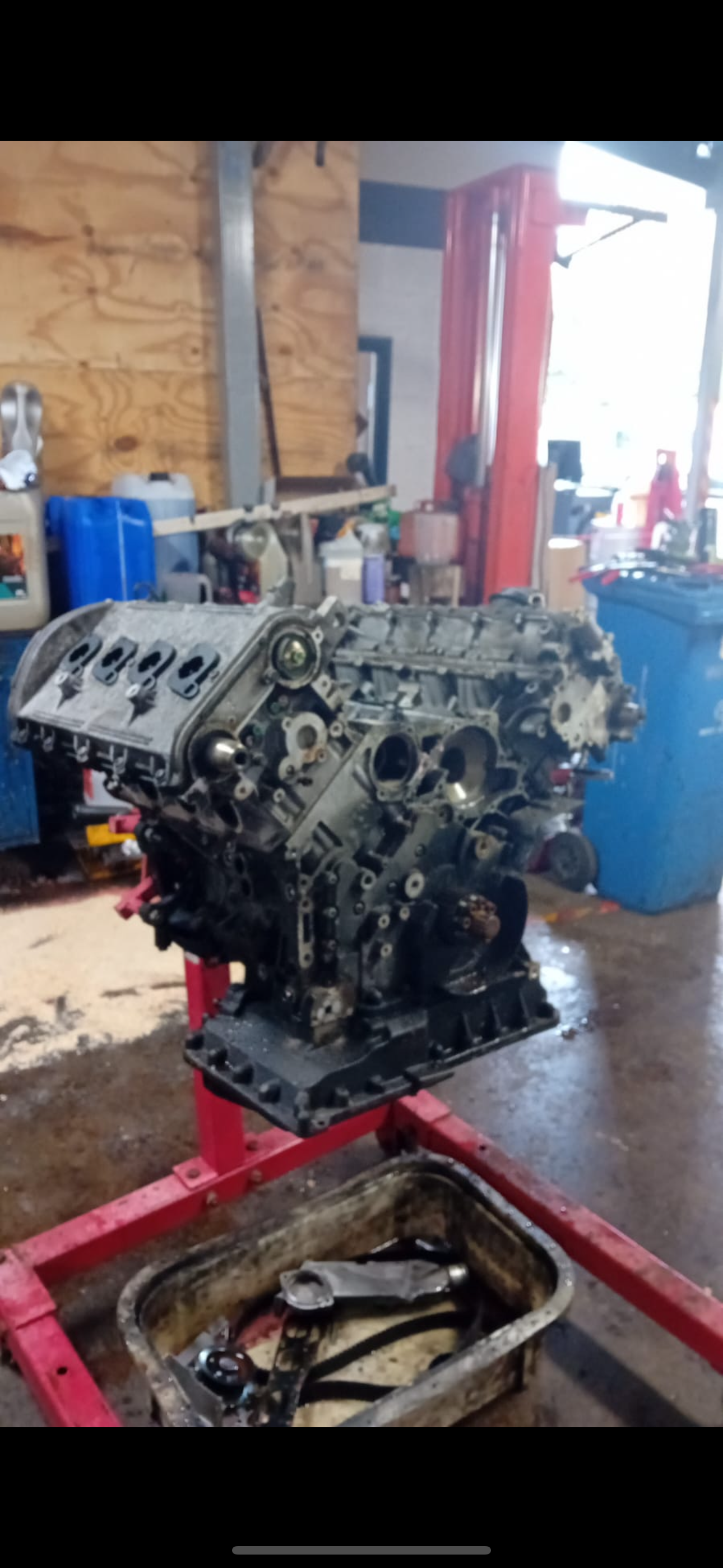

All of the ancillaries have now been removed from the engine.

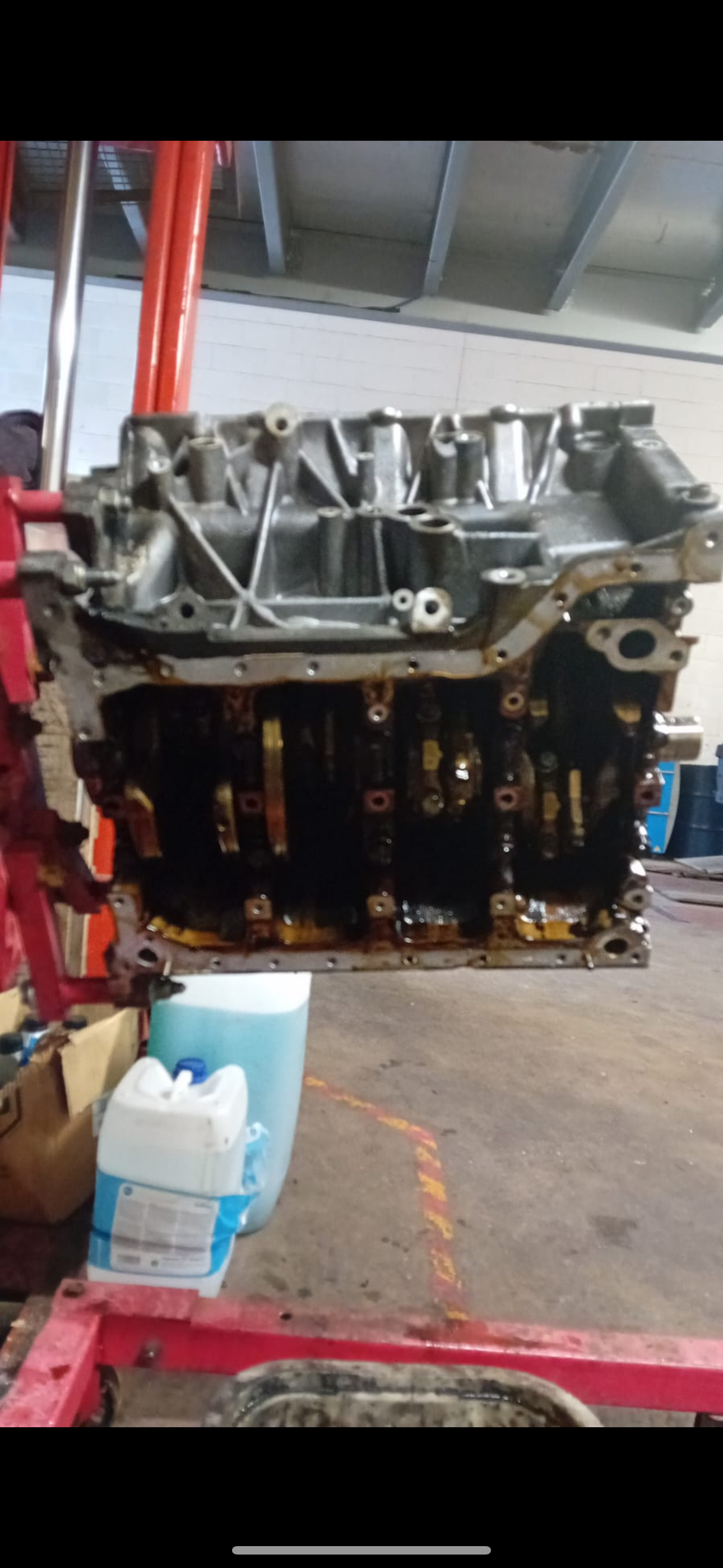

Everything else has been removed from the block. Apart from the crack, rods & pistons.
Its was taken to the machine Shop today along with my new forged rods and pistons. The bores are being re-honed and the crank, rods and pistons are being lightened and balanced before reassembling.

The bottom end was dropped off at the machine Shop. Then upon inspection they aren’t 100% happy with the boars. The boars are Nikasil coated from factory and they have some signs of wear, so we are having them re-nikasil coated.
I also received another parcel this week with all my valvetrain components.
