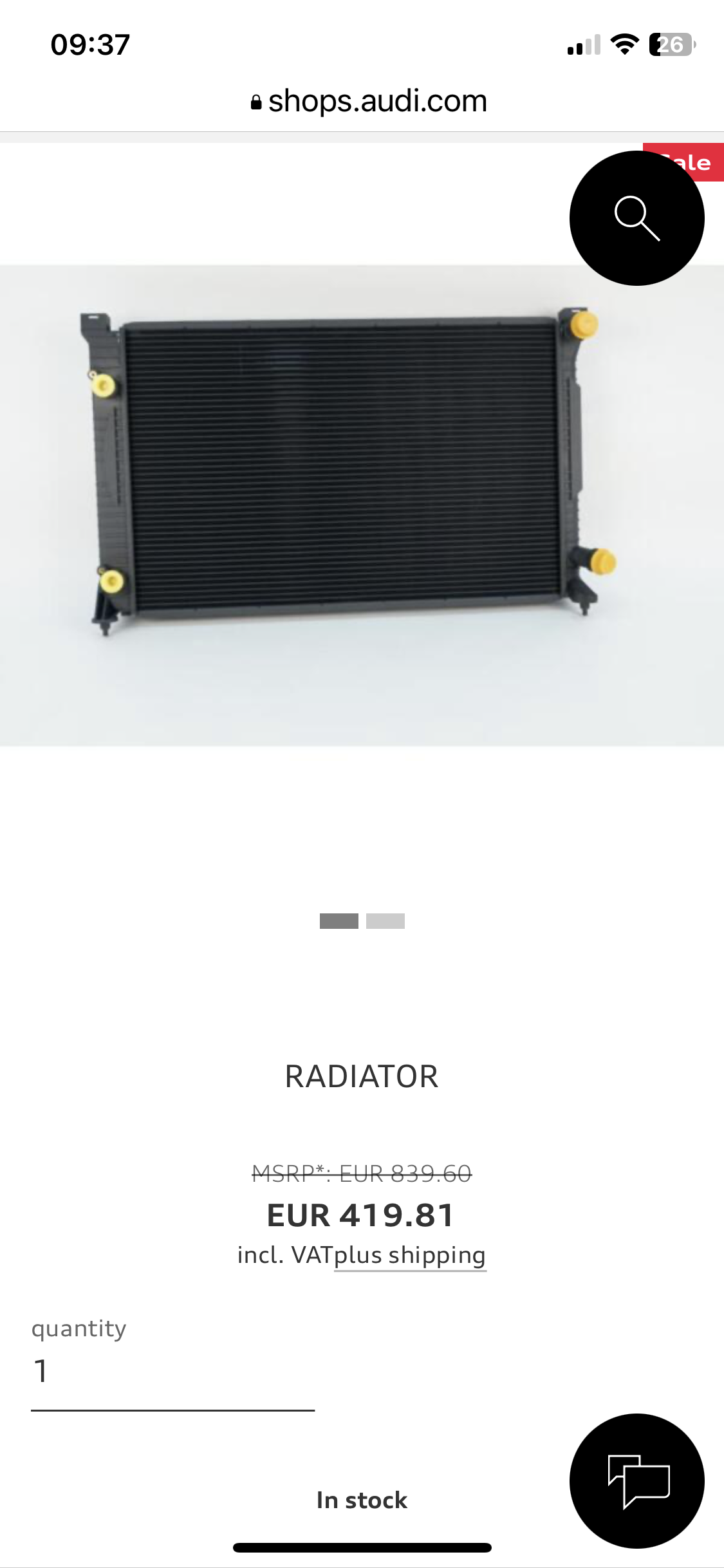

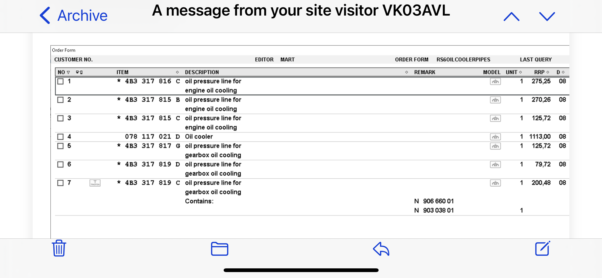

This might help.
My car has a separate gearbox oil cooler which sits below the radiator.
The rad came from Audi tradition
Hoses from RS Components.
