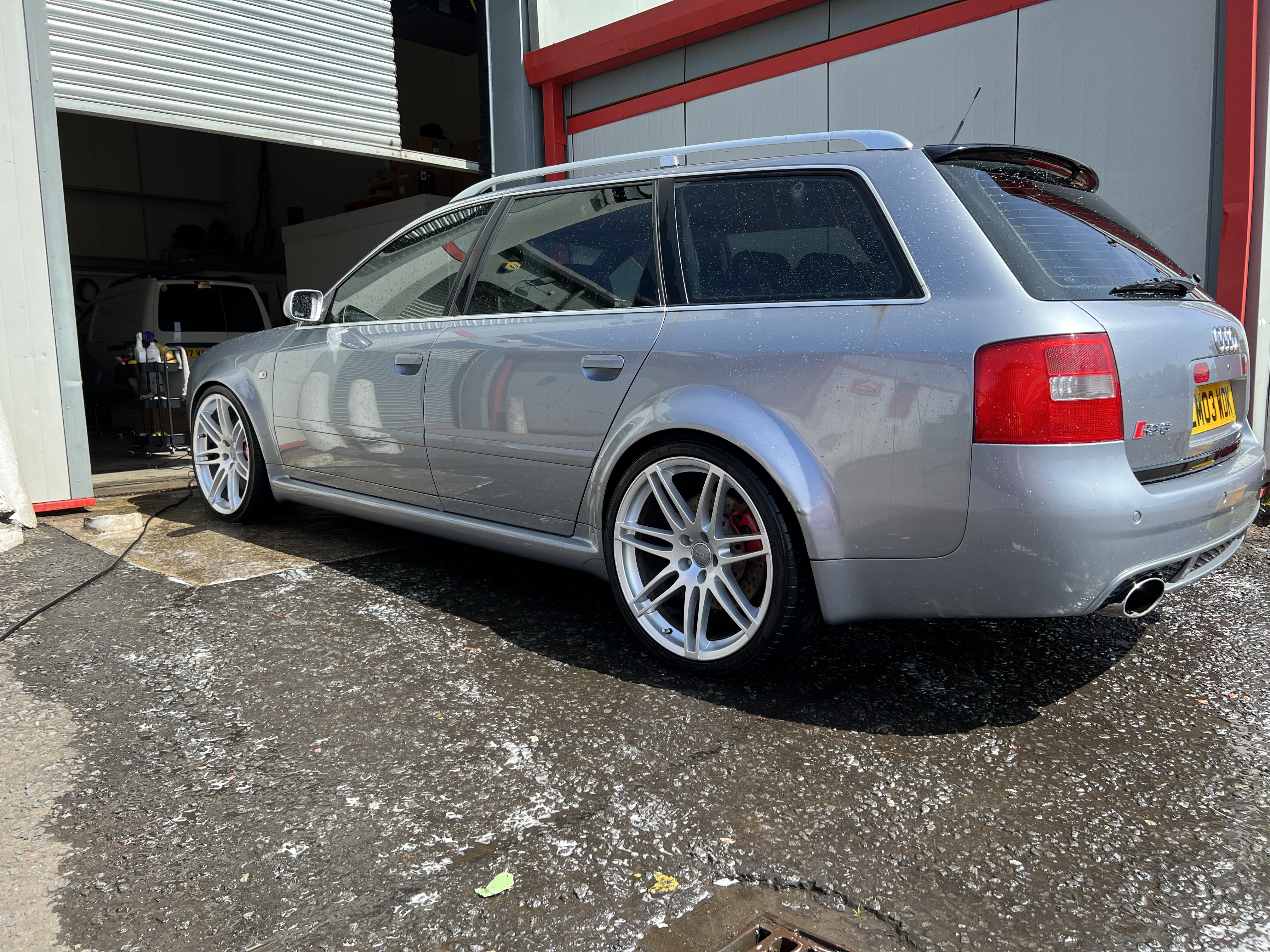

These are great looking wheels and suit the C5 nicely, I find.
Re: Wheel ET question
Foxmeister , there the same wheels as mine , but i think my ride height is far to low , could you tell me the distance between the centre of your wheel to the arch , luckily my 6 has has decent coilovers fitted so i can adjust the ride height as currently theres no space between the tyre and the arches ,my plan has allways been to add more ride hieght but I dont know the original ride hieght.

If they are the ET29 wheels then they fit pretty bang on, should be 255/265 tyres to suit and mine clear everything, no issuespwack wrote: ↑Sat May 13, 2023 2:03 pmFoxmeister , there the same wheels as mine , but i think my ride height is far to low , could you tell me the distance between the centre of your wheel to the arch , luckily my 6 has has decent coilovers fitted so i can adjust the ride height as currently theres no space between the tyre and the arches ,my plan has allways been to add more ride hieght but I dont know the original ride hieght.
I’m on Bilstein PSS9’s and they are set a bit lower than standard but I like it, those pics don’t show it great as the gradient where I’m parked is skewed, but I’ll try get some flat ground and measure for you
