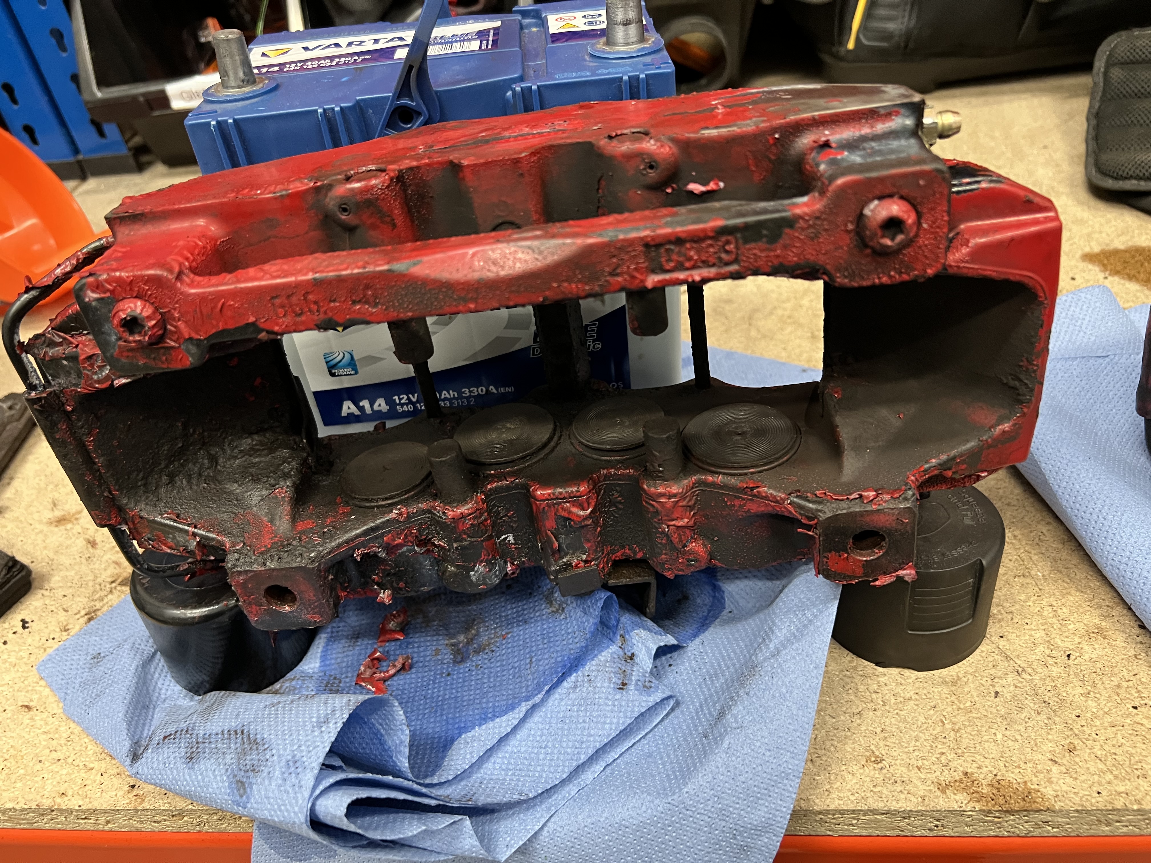

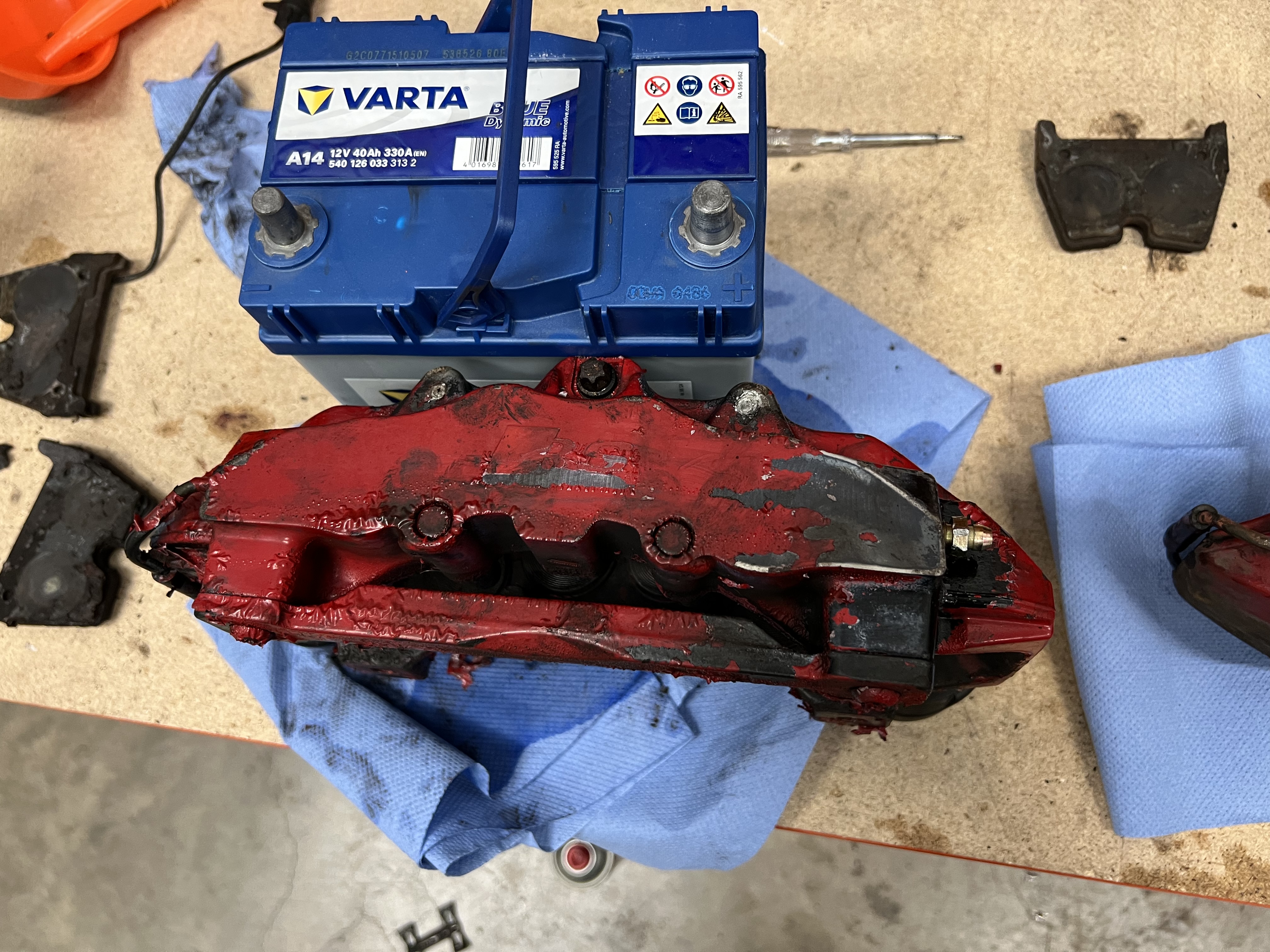

So I had some issues with the caliper bleed nipples around a year back when it was discovered they were seized, I had a garage look at them and apply heat, but they said no joy also, not long after it was due an MOT and passed fine on brakes so it was left for a while
Until last week, short drive to the gym, all fine, leave the gym, now pedal feels like it’s dropping… took the car up to work to inspect and found one of said nipples was leaking, took a spanner to it and was free, weird, but I had replacement ones in the car from back then so tried a new nipple as old were rounded etc, but unfortunately a thread stripped out when doing some bleeding, bastard, almost a free repair on an RS6, unheard of
Anyway, decided they were coming off and getting sent away for a full strip and rebuild with powder coat etc aswell as the nipples need done
Looking a bit sorry for itself here

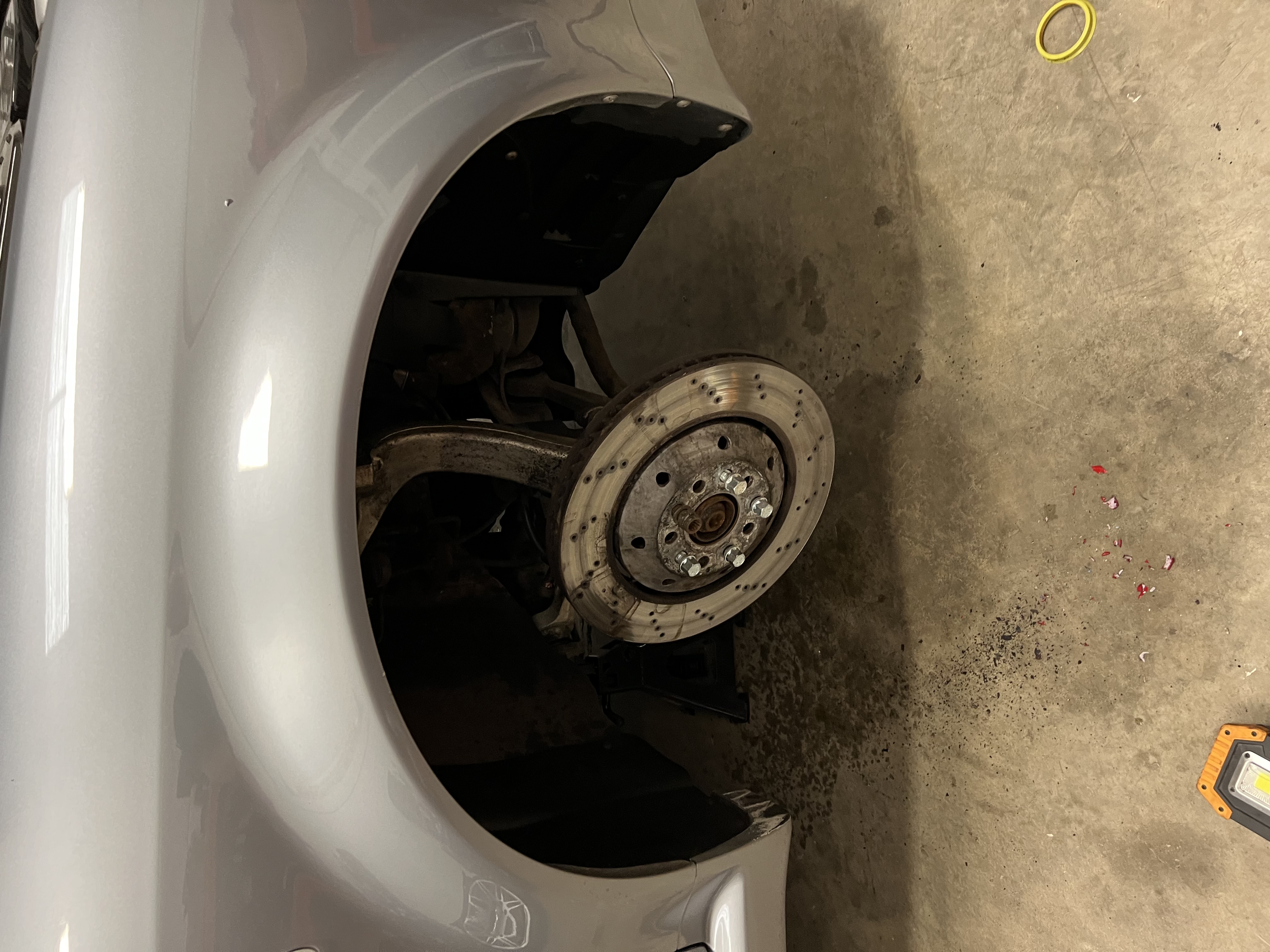

I am also doing the droplinks whilst im in here, had these for a while so finally getting my finger out

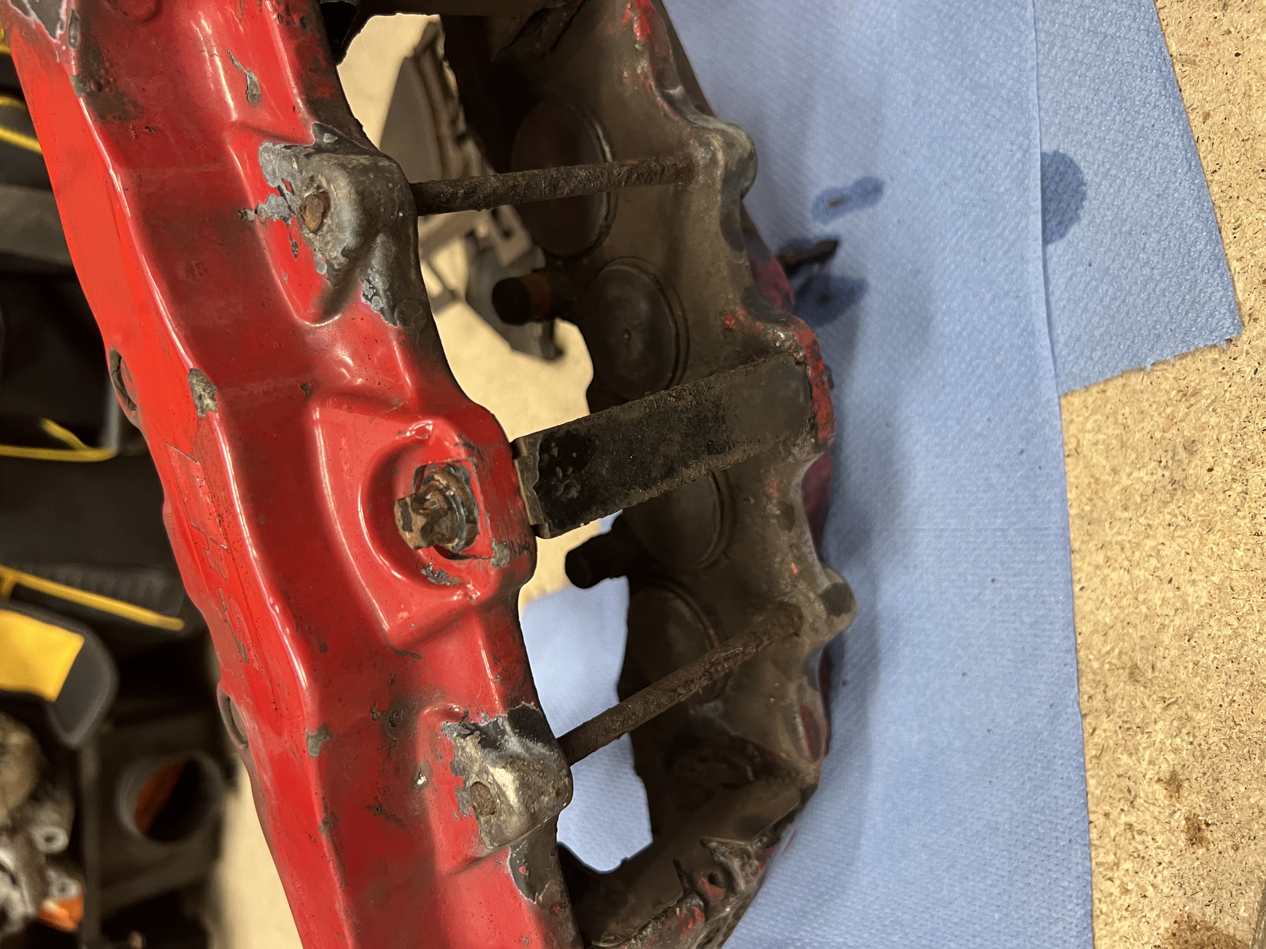

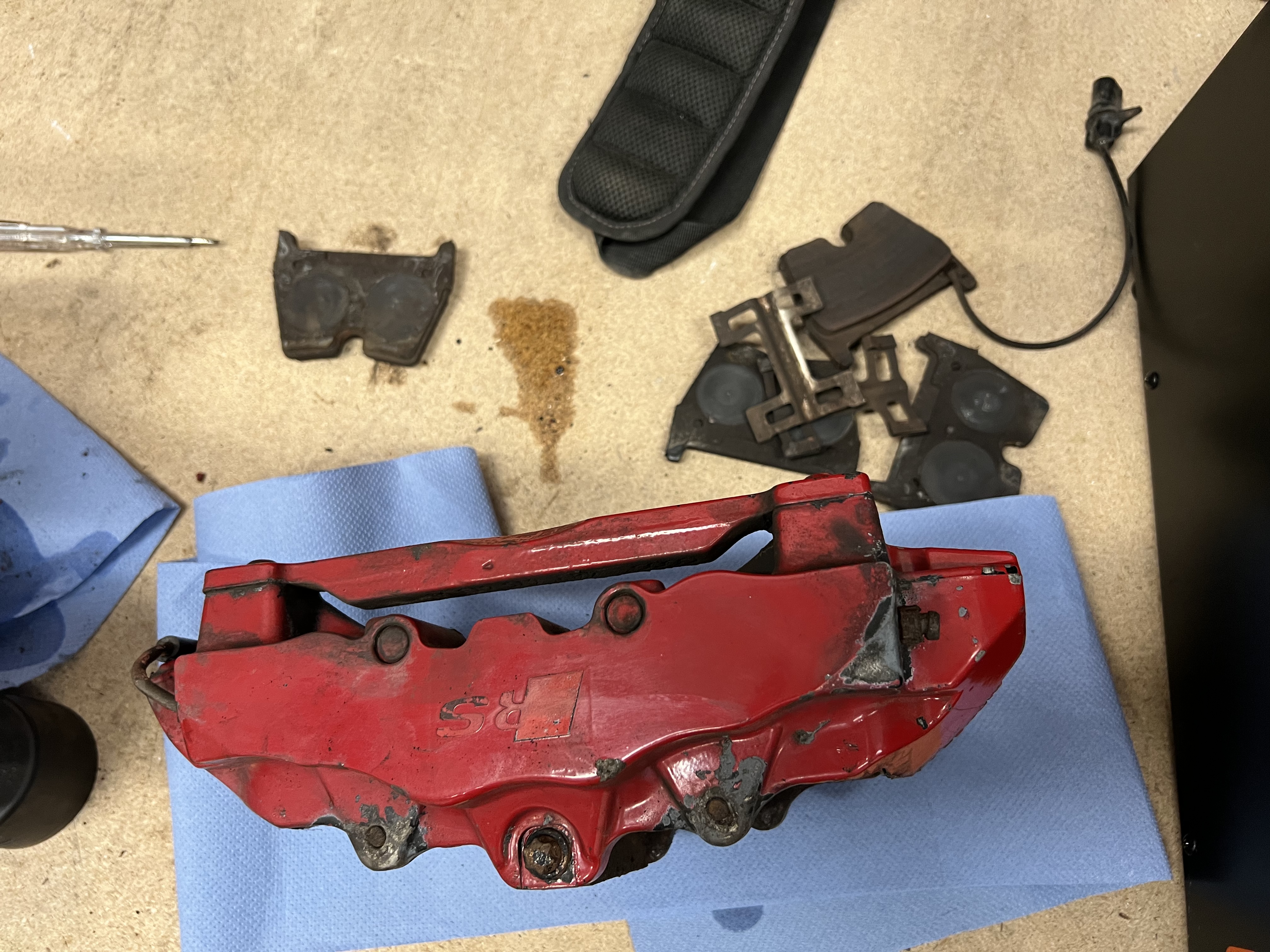

It looks to have Pagid pads in currently, am i right in assuming these are the standard pads or should they have Audi logo on them?
I found these to be quite bad in dust terms, but i have also found at least 2 pistons arent fully retracted, so possible seizing also
Re: Refurb time
I would expect them to have the logo, perhaps they are the Pagid ones that ECP sell. If they are ECP ones they won't be the same compound as OEM.
Re: Refurb time
The OE pads have no Pagid marking.

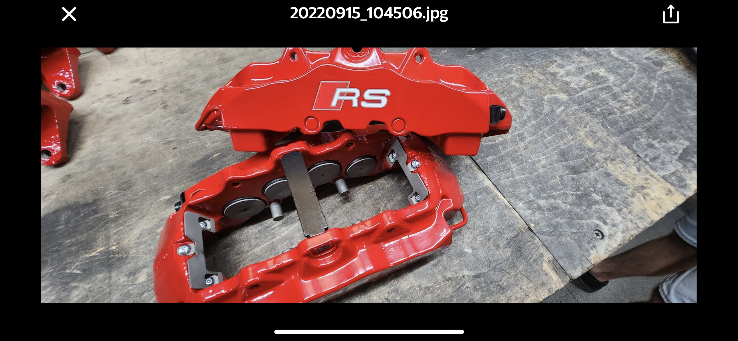

Steve, i am sending mine to a company called Godspeed Brakes, have saw previous work and finish was really good, pricing is fair also, its £400 for a standard strip and rebuild with powdercoat colour finish, then extra works are chargeable, so its £80 per nipple thread repair work etc, if you email and speak to Ian, he will advise you better im suresteve2003rs6 wrote: ↑Fri Aug 19, 2022 1:17 pmBought my last set of Genuine Audi pads online.

what about the RS logo on the calipers? I am keen to have my calipers done but reluctant to loose the logo...

Theres no mention of logos etc, so not sure if its a service they offer, i have bought some myself and will apply and then lacquer over the face a few coats when i get them back

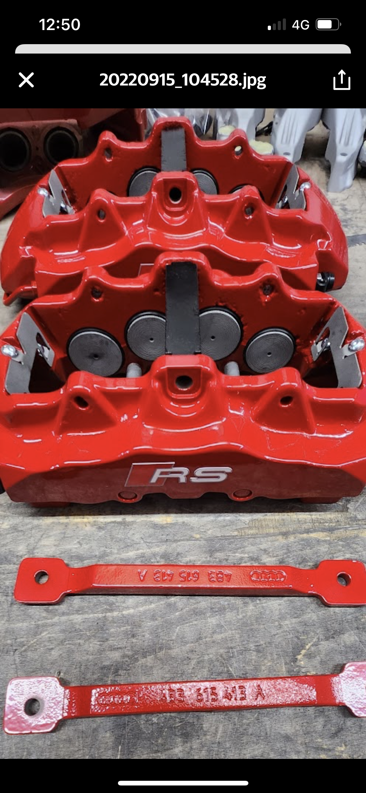

Calipers fully refurbed, all nipples reworked and replaced and being sent back to me tomorrow, chuffed with how they look
Just need to find new pads next

Re: Refurb time
I'm not a fan of coloured calipers, but that looks like a top job.
Did they do the RS logo unprompted?
As for the pads, there are some good Brembo pads and some completely crap ones made from floor sweepings. There was a discussion recently on alternatives to OE pads. I found the DS2500 to be pretty good but they're not technically road legal.
/Also, IIRC the RS4 b7 pads are identical. You could try to see if those are available at Audi / TPS.
