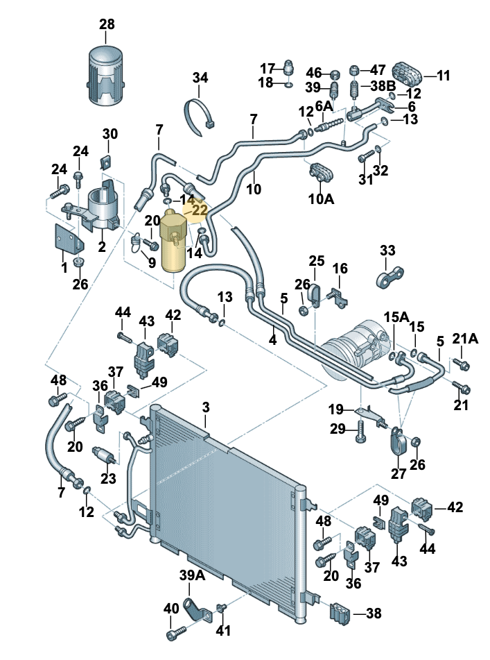

Digging this old thread up hoping someone can point me in the right direction. My air con has packed up due the drier leaking (split housing) Nobby, did the alternative from Autodoc fit? looks like the male and female threads are reversed in the pictures. Does anyone know where I can get one please?
Hi Paul
So you need this part in yellow? (see pic)
Part number 4B3820193A
Ping me on the FB messenger, I'm quite sure I know of a good one for sale from a low mileage UK car if needed.
