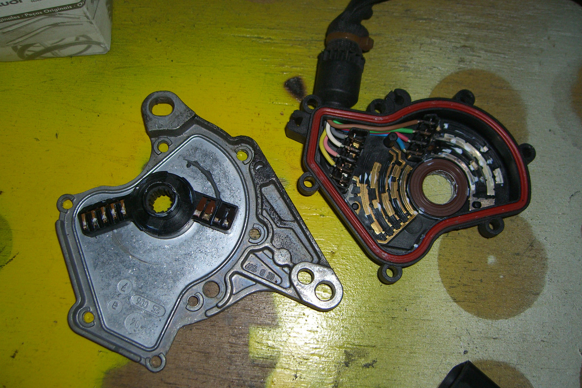

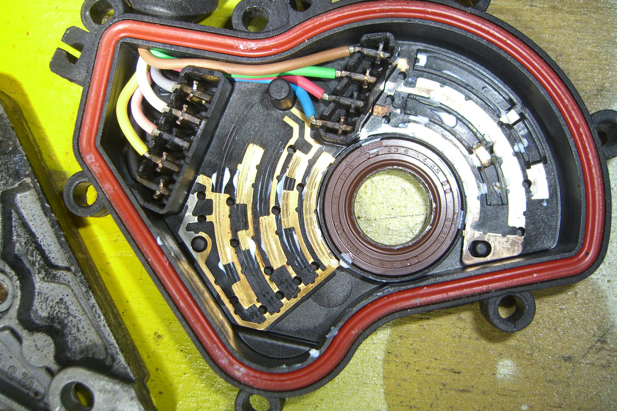

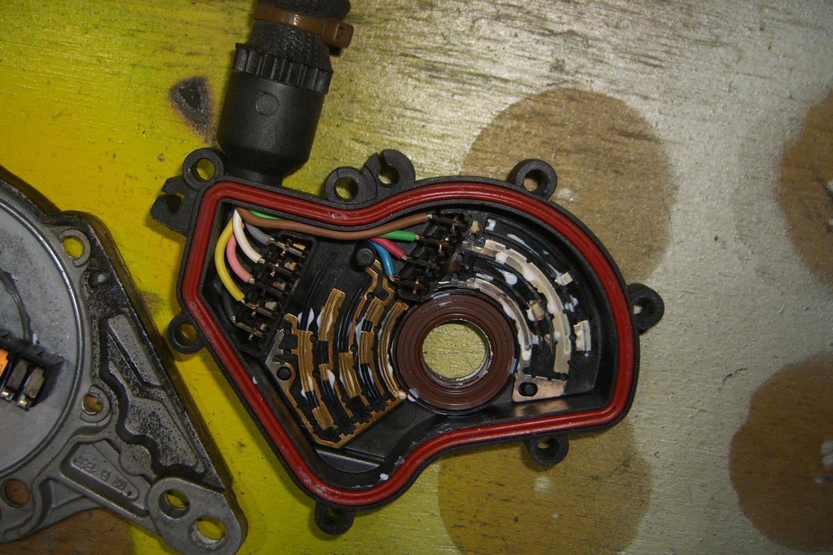

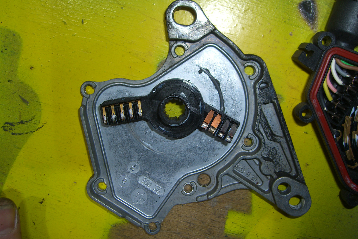

Below is a picture of the F125 I opened this afternoon. As can be seen some of the electrical contacts are quite dark looking, but I don't know what might have caused this. I already buzzed all cables through with the multimeter and all tested fine for continuity, the same for the rails - everything appears to be OK, but I would not re-fit this without a full clean etc.
So, if you did this, what did you use? A chemical, a light acid solution, fine sandpaper? What grease did you use?
Looking forward to suggestions. Here are the pictures:

You sure it's the tracks and not the connector?

The connector looked perfect, but I will give it a thorough check when back in the shed. My continuity tests showed nothing unusual.

I wonder what the tracks are made of. I think if I was going to have a go I’d use some Autosol on the tracks and contacts. Then wash in lots of isopropanol. Not sure I’d put any lube on. Was there any on the one you took apart? I suppose this stuff might work:

I'm not sure you'd want conductive grease, you might risk shorting between tracks?

I've repaired a few switches before using Brasso and Duraglit that I've had for about 25 years, works a treat as long as theres no pitting.

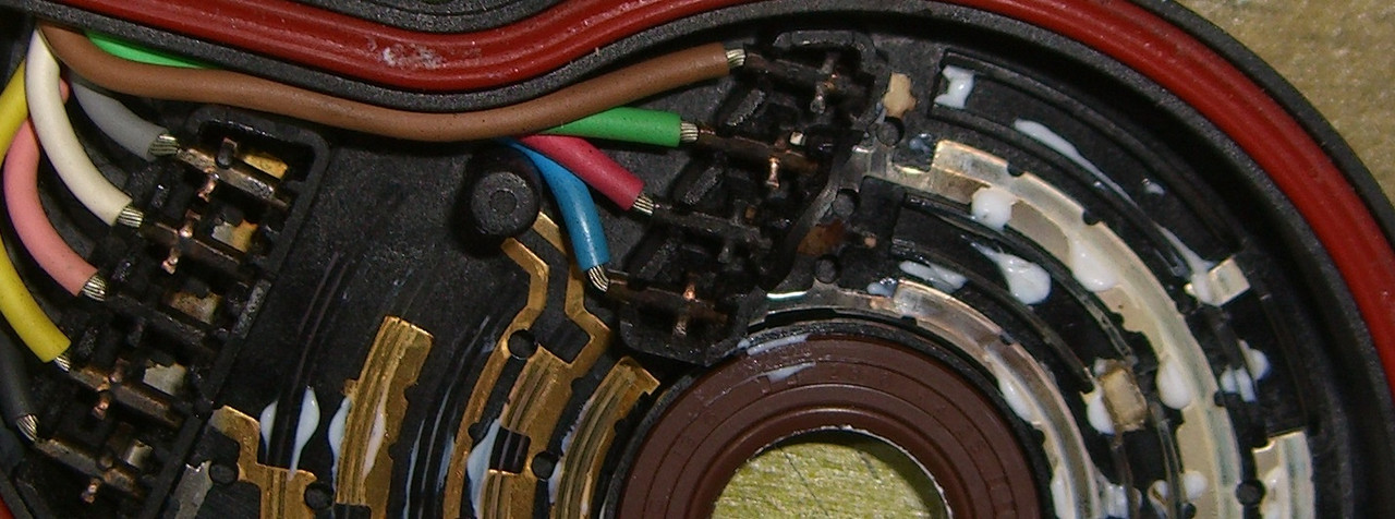

Yep, definitely grease, you can see the residual white grease blobs in the pictures.
You can see the grease here:

Sounds pretty good to me, might work using cotton buds etc, so will probably give this a go.

Could the grease be silicon grease?
I’d also look at whether there is any play in the shaft of the selector. It looks like it been or touches the back of the casing (from the grease stain). If it twists and there could be a wider gap between the contacts.
I’ve repaired a few wiper motors which have similar problems - the contact wears out and you can solder a new one in. Last time I just fashioned one out of some copper washers.
