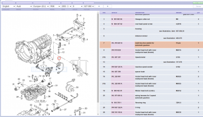

On the F125 switch, reading this forum the part number (seems to be) 01L 919 821 B, when I google it the results come up as 01V 919 821 B
Is that correct?
Mɐʇʇ
Posts: 2725
Re: F125 Switch or TCU - or something else?
Post by Mɐʇʇ » Fri Nov 12, 2021 6:09 pm
Looks like there's still stock too, should work out about 180ish quid
Duke Thrust
Posts: 19
Joined: Fri Nov 12, 2021 12:05 pm
Post by Duke Thrust » Fri Nov 12, 2021 6:29 pm
Thanks - from Audi?
(Searching reveals two different connector types, one round and one oblong - both seem to have ten pins.

Mɐʇʇ
Posts: 2725
Post by Mɐʇʇ » Fri Nov 12, 2021 6:31 pm
Yes.
