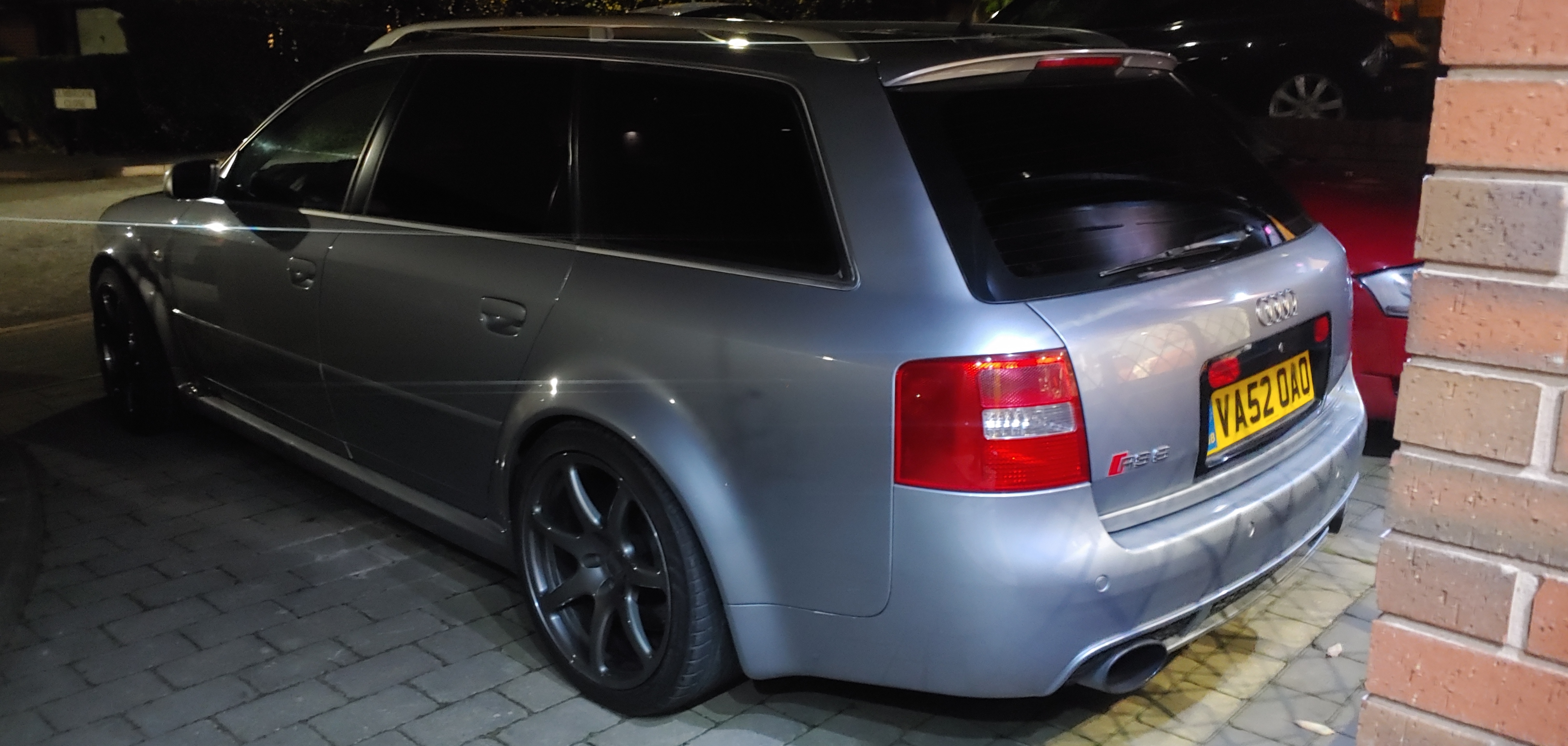

Hi all, finally bought one and picked it up earlier.
It drives great, took it for a spirited drive and the power is just immense! It just keeps on going, unbelievable.
One think I'm disappointed in though is the sound system. It has Bose with an aftermarket head unit by Pioneer and there is hardly any bass. Will have to look into upgrading that.
Sorry about the rubbish picture but it was dark when I left the garage - spent 50 minutes on the phone to Co-Op banking trying to get my bank transfer released.
Will get more pictures tomorrow, the alloys are growing on me:

Excellent! Milltek on her too by the looks

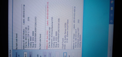

Did a scan on VCDS earlier, had a load of faults relating to the battery dying at the garage which they replaced with a brand new one on collection.
Rescanned and it came up with 2 faults, one to do with the radio (it has an aftermarket Pioneer) and one to do with the air con:
Well happy with that!

It's only the air quality sensor, not the aircon. Lives under the bonnet somewhere in the incoming ventilation airflow (others will know where on an RS6).
IIRC there are two basic sorts in Audis of that era, only one is reliable....
And you can open them up and clean them VERY carefully without contaminating the sensor surfaces.
Had the same fault on my 2002 S8 just over a year ago and cleaned it away with a very delicate artists brush.
Oddly the D2 S8 part number is 4B0907659B whereas I think the C5 is 4B0907659A. No idea if they're compatible.

They are junk. You can safely ignore that error code. Mine has had the same code for the last 10 years.

HVAC error. Mine was a sealed unit. Just bought a new one from Audi. Relatively inexpensive. Been on a while now and still ok.
It’s connected to the front of the cabin air filter.
Rear of engine bay to the nearside.
Be careful when removing. The lugs on the housing are very brittle.
Push the sensor downwards to remove. Lug and groove fitment. And it can only be removed one way.
Insert the new sensor from the bottom and pull it upwards.
Other way round and it will break. I know from recent experience. I had to install a new filter housing which is a bitch. There is a hidden nut at the rear of the housing.
