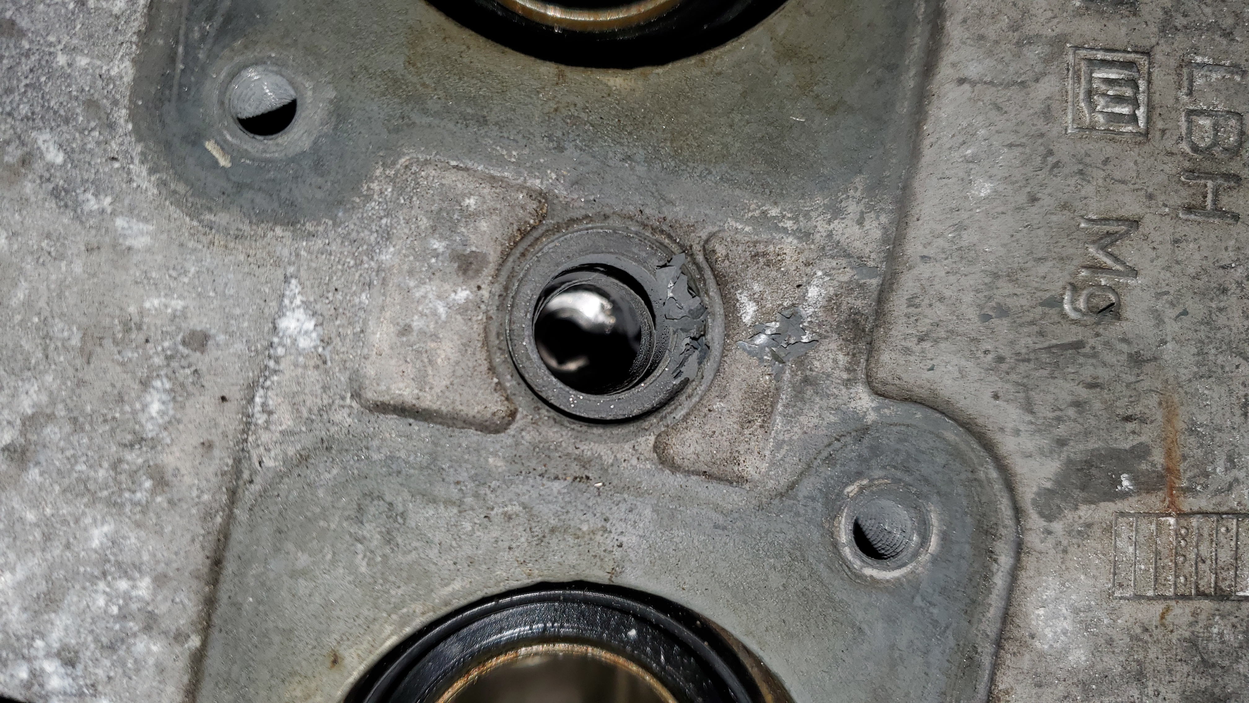

Its really straight forward, no risk to the coolant pipe unless you sit there wiggling it back & forward. Id recommend getting inspection mirror (the small telescopic kind) just to make sure its the covers.
Lastly the one thing to look out for if you're doing it yourself, or making the talking to the technician is to keep an eye on the cover bolts in the centre (2 each side) as well as the spark plug holes. With mine there was thin slivers of corrosion sitting loose and ready to drop onto the cams etc. Blow/vacuum these holes out when the bolts are removed - before taking the cover off.
