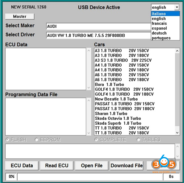

  • If you are running a stock tune, this is simple. In my case, bought a Galletto 1260 cable and software off ebay.
  • Would a generic OBD cable work - I don't know, maybe. You can certainly download the software for free - although I bought a cable too, since it was cheap!
  • The Galletto software is super easy to use and lets you download, or upload, a tune.

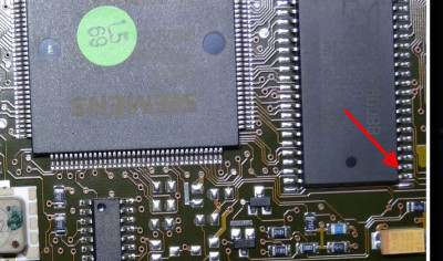

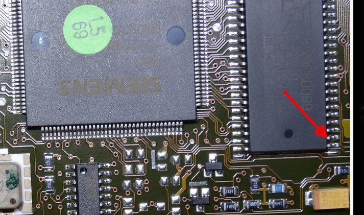

  • You can unsolder the eprom if you wish, :bigblink:, but it's also possible to jump the ECU at boot time which puts it into boot mode.
  • This works around the lock.
  • I can't remember the exact pin you need to ground when you turn the ECU on, but I think it's this one.
  • If you need boot mode, google it - but this is pretty close to being on the money.

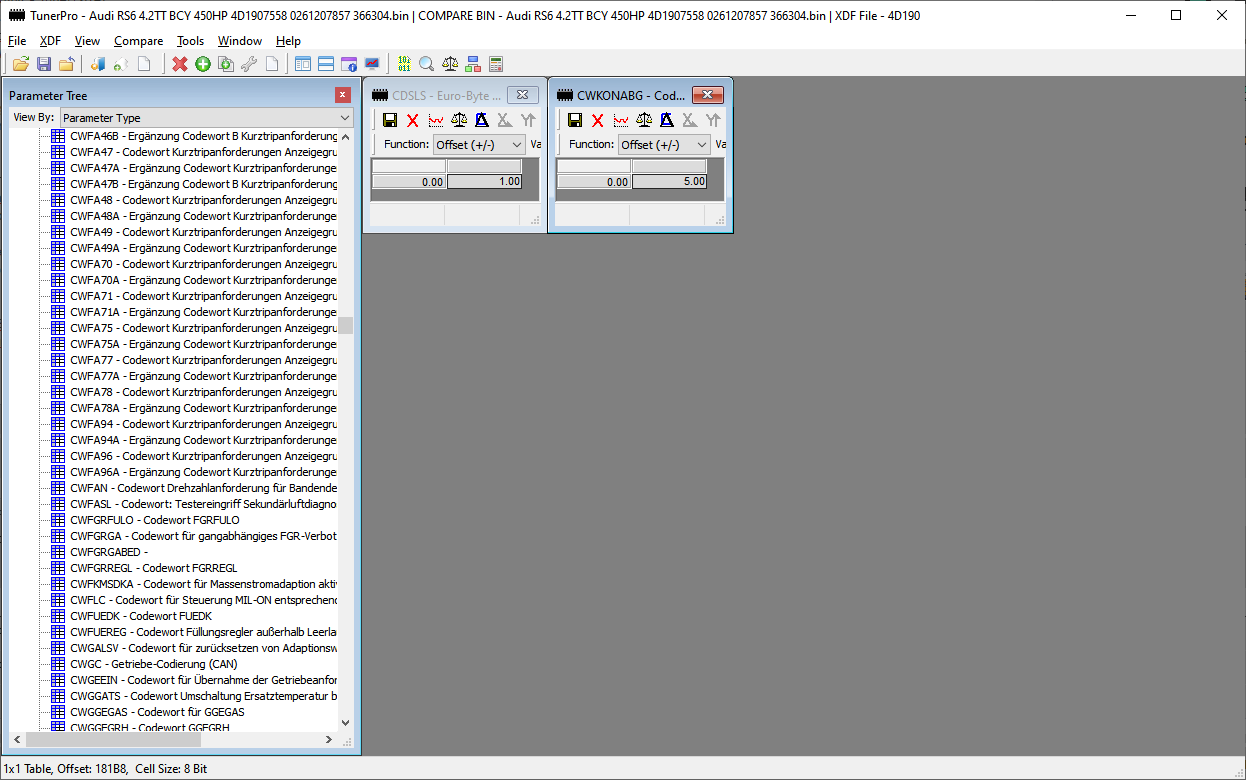

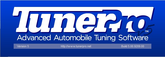

  • For editing, I used TunerPro, which is free.
  • To make this work, you need both the bin file, and an xdf template. See linkies below.
  • To disable SAI, I turned off a couple of codewords:
  • Which in TunerPro, you can see here :
  • Just these 2 enables you to remove all your SAI plumbing with the exception of the electrical connection as noted above.

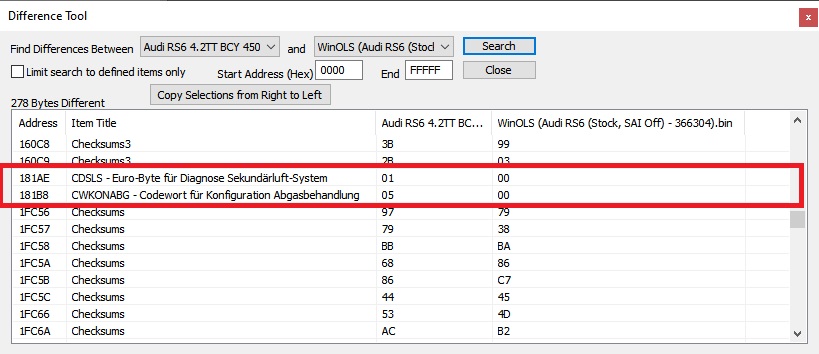

Checked the file I pulled of the spares car ECU and it's the correct version. Address 181AE is already 00
Address 181B8 is 05.
Next I will pull the file from my car and see what is on it.

Cool - you spotted the exact addresses in the screenshot - thought that would be useful to you.
Don't forget the checksums need resetting too after editing, as evidenced on the diff screenshot.... :)

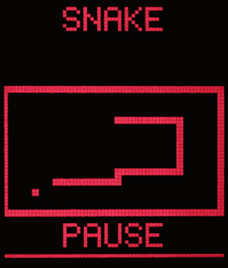

Personally, I still want fis-control.de installed so I can play snake. That is priceless.
