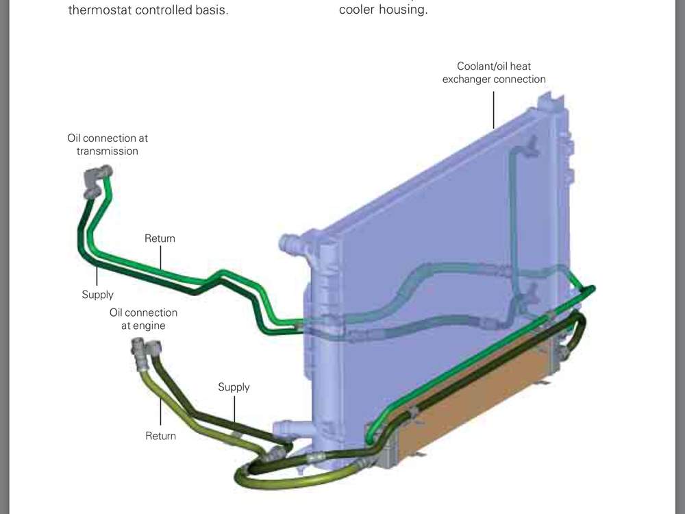

Post by IchBautAuto » Tue Aug 25, 2020 11:15 am
Yep, got the twin cooler up front. I haven't had my radiator out yet (blessed by the fairies) but from what I can see it looks like this with the auto trans oil lines routed through the end tank of the radiator as well.
No idea if this is common with all RS6 variants but it was a point of difference between the B5 RS4 and all other B5 manual gearbox models that I am aware of. Certainly the radiator is different and twice the cost in that model. All the pictures of the RS6 radiator that I can recall seeing have a tank on one end and a threaded boss top and bottom. Any idea what they would be for if not oil?

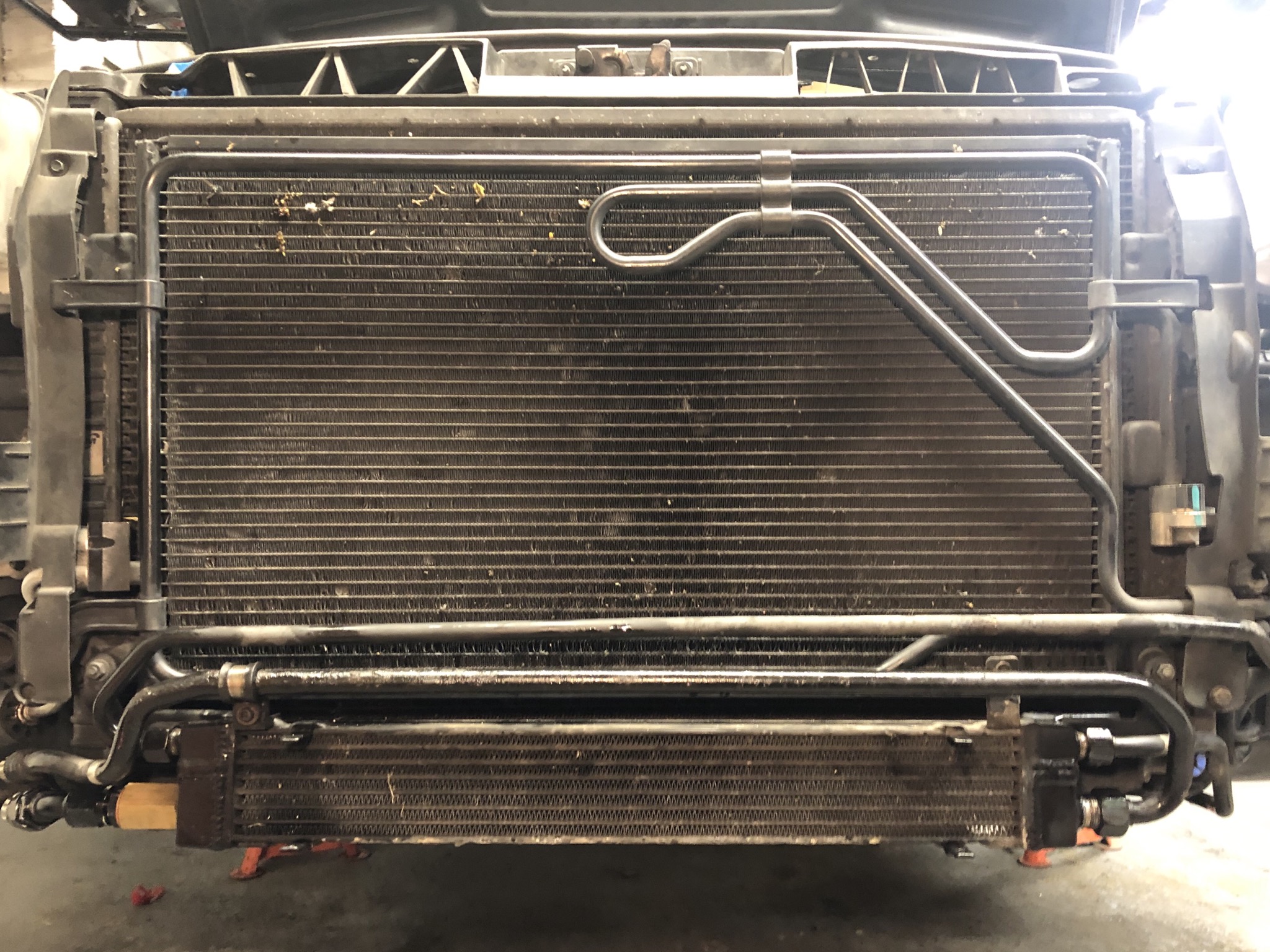

This is mine, only ran briefly (250miles) before I discovered the head gasket is less than perfect. The little cooler up on the right is transmission, the big one at the bottom is the new 2 pass engine oil cooler (setrab),and the pas loop is a pov spec A6 massaged at the ends to fit. Gearbox oil temp comes up fairly quick.Image

Had mine redone completely as well - similar to puggie's one but I got two coolers side by side

Are you not worried about the reduced flow of air going through the water coolant rad?

Post by Puggie » Wed Aug 26, 2020 8:20 am
ChrisA wrote:Are you not worried about the reduced flow of air going through the water coolant rad?
Not really, that trans cooler is a Goodridge (PWR I think) generic motorbike radiator. Its maybe 3/4" thick and not very restrictive to air. That heat would be going straight into the rad anyway, so I've taken thermal load off the water coolant system, it shouldn't have to work as hard.
My main drive for this was that when I dropped the engine i had the torque converter refurbed on MCRs reccomentadion (was told over 100k they are passed their best if you plan to remap). The company that refurbed it warned me I had coolant residue in the torque converter, so I had a leak from coolant to gearbox oil. That is not good for the torque convertor or the chocolate gearbox! So I moved to all separate coolers.
