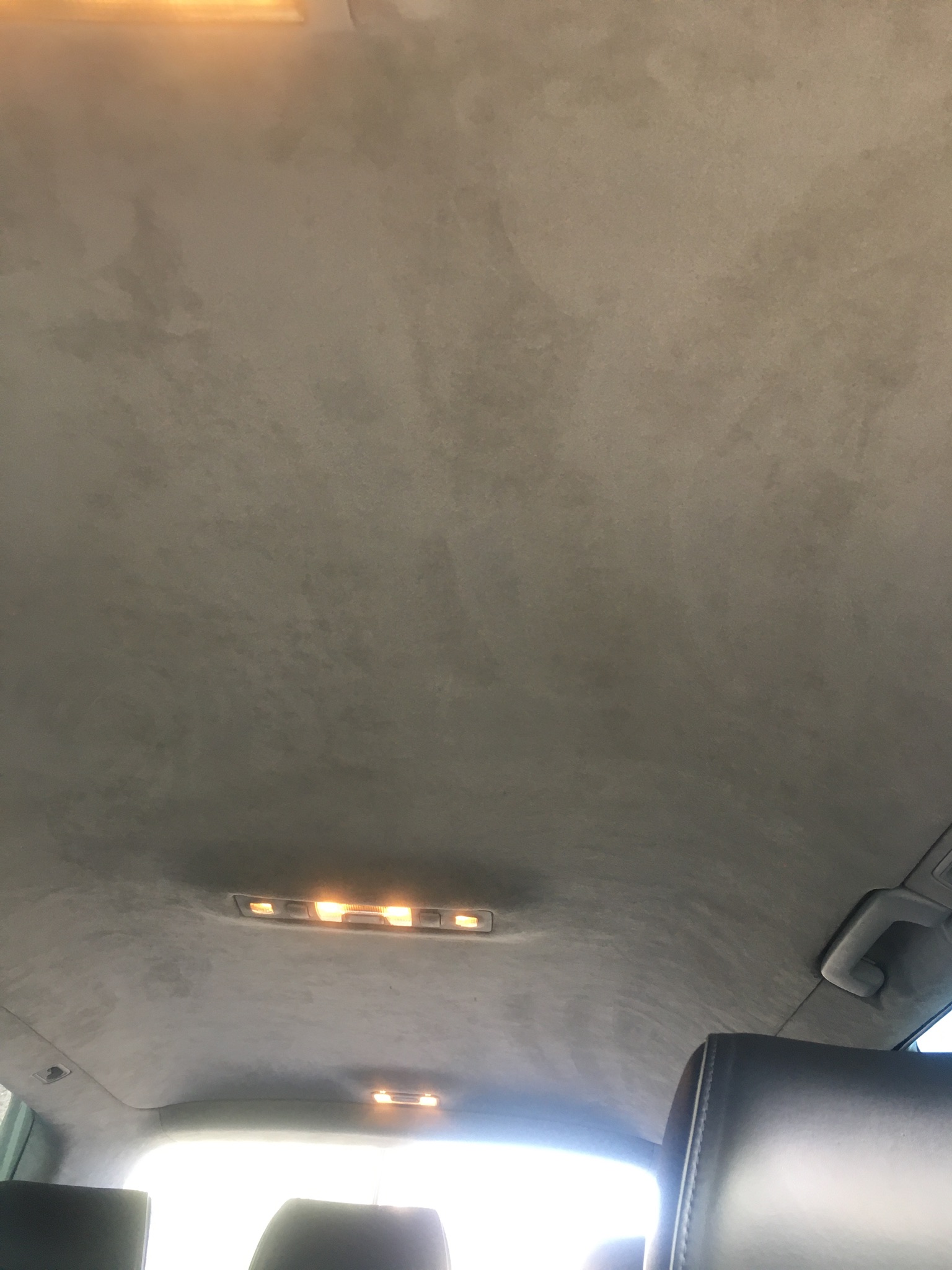

I need to get my headlining repaired or replaced as its sagging.

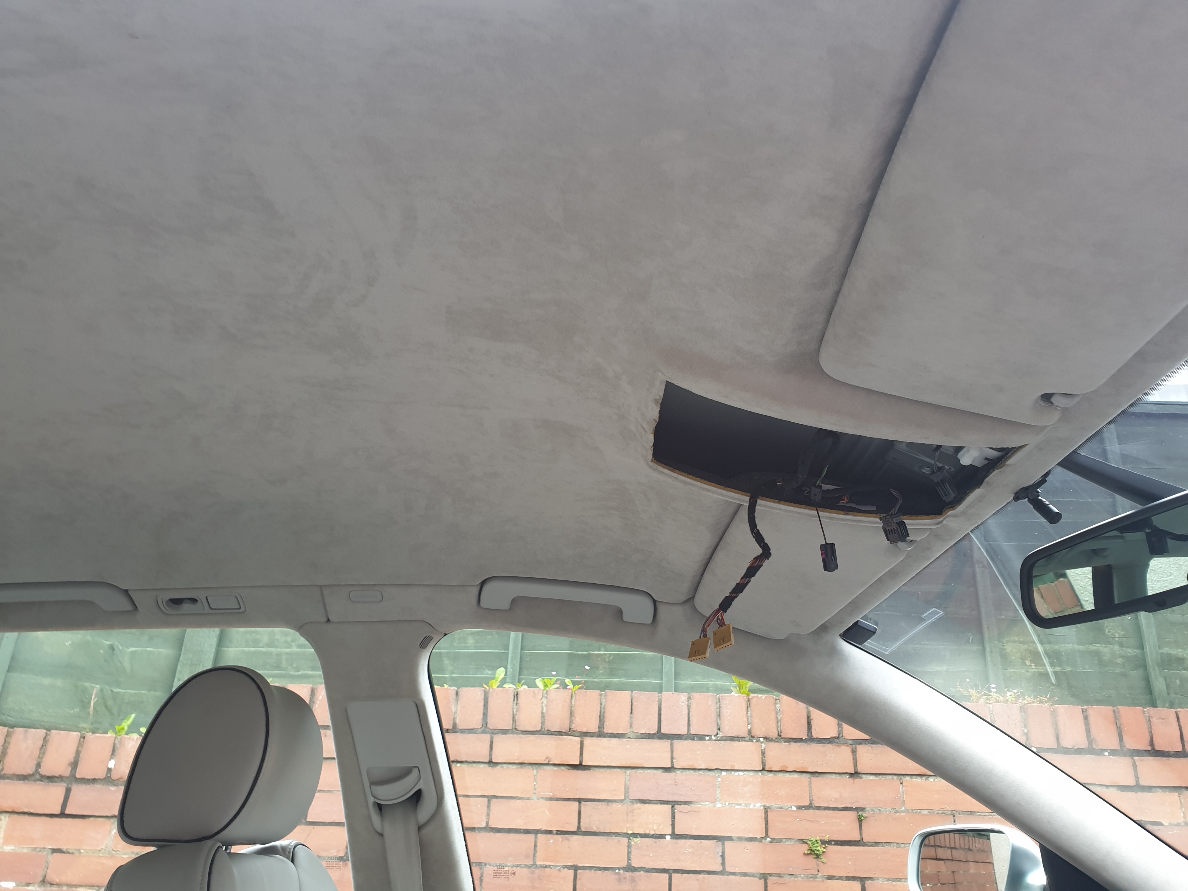

Hi mate hope you’re well you could do it yourself if you can find a decent secondhand headliner it took me two 8 hour days, i did it by myself if you got a friend to help might be quicker, total technic do a video tutorial on YouTube You will have to buy for but think £10 which is really helpful, I’m still in the same situation as the headliner that I replaced it with is also Sagging, kinda my fault as I bought it about a year earlier of eBay and stuck it in the attic and when I got round to fit it I realised it was also Sagging as I had over a year ago I couldn’t really do anything about it so I’m also stuck with a dodgy headliner. There’s a guy who breaks the C5 RS6s I believe he’s got a dark grey sunroof headliner but he wants 700 which includes the interior trims and he doesn’t want to split.

Cheers for that. I ve used spray adhesive for now but I no faith it will last.

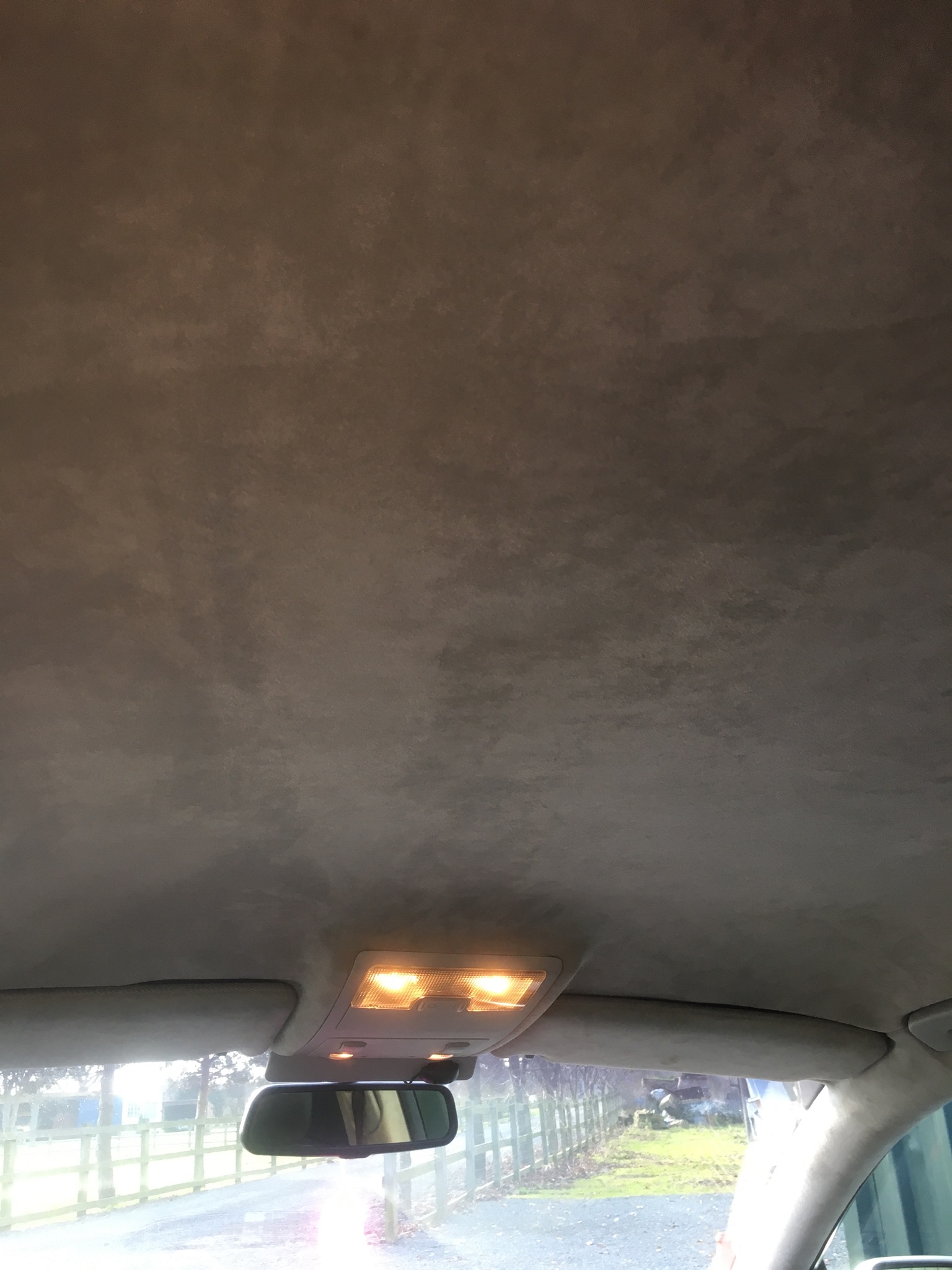

Luckily its the front part thats dropped so I ve removed the interior light unit and sprayed the area and used a roller to stick it together so far its stuck.
Only issue now is I ve got to figure out how I am going to put the light unit back because it wasnt easy to remove.

Ahh ok mines at the back so I could probably remove the rear lights, which glue spray did you use?Frazz82 wrote:Luckily its the front part thats dropped so I ve removed the interior light unit and sprayed the area and used a roller to stick it together so far its stuck.
I’m guessing it’s not showing through?

Just the no nonsense adhesive from screwfix. As long as you dont saturate the area it wont leak through.

Gents, if I were you I'd bite the bullet and get it done professionally. Having seen the state of the old disintegrated foam I can't see how spaying new adhesive is going to be a lasting fix. If you wreck the alcantara in the process, you're looking at a much more expensive fix.
Frazz yours doesn't look too bad, but it will get worse until its just the fixings holding it up.
