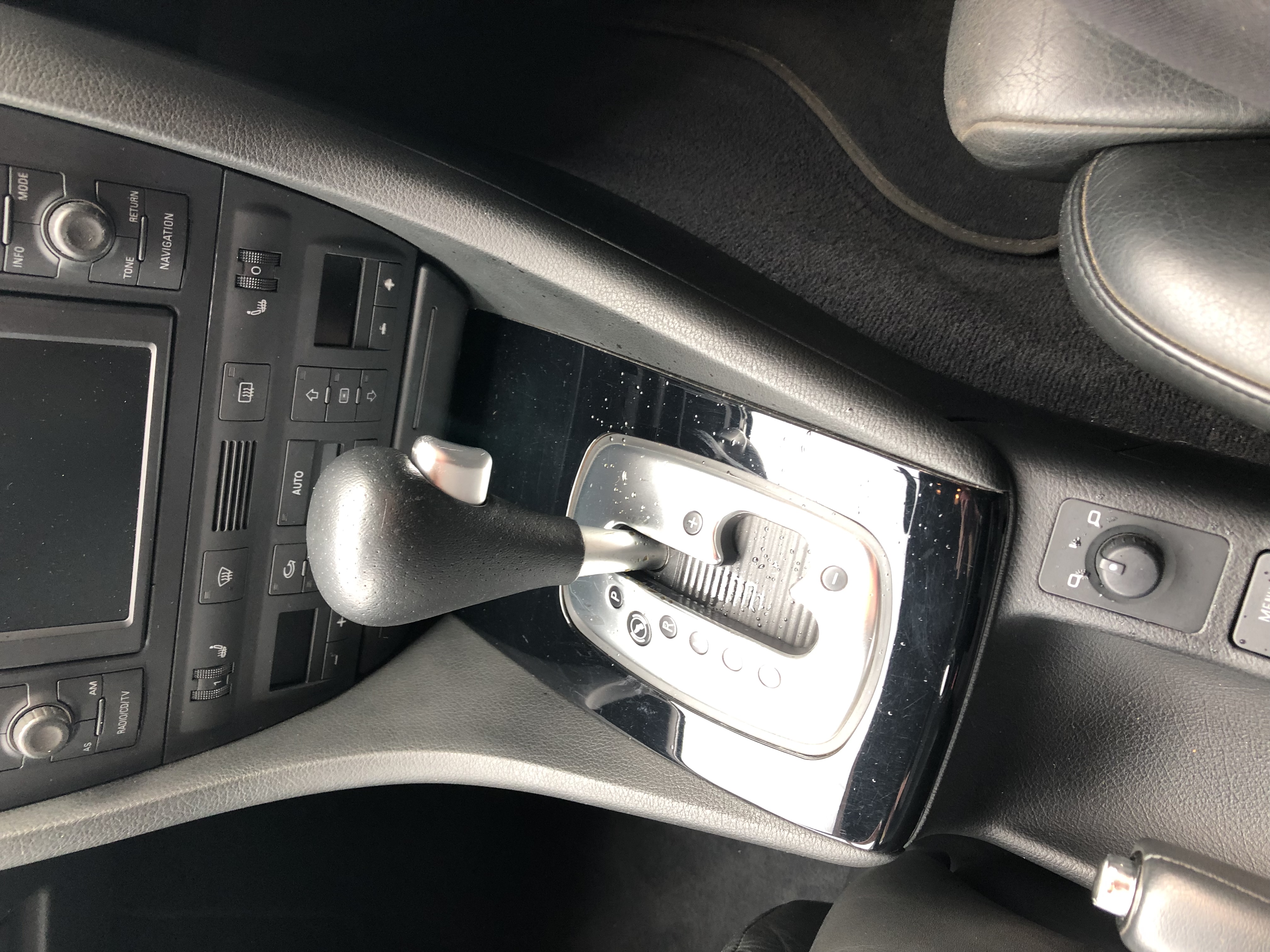

I jumped in the car and noticed what looked liked water drops on the gear selector surround.
The kids had been playing with the hose earlier and my initial though was they must have got a bit through the window even though they were playing along way away from my car.
On closer inspection the fluid wasn’t clear, then I started to worry. I tasted a little of the fluid and straight away I thought whatever this is its corrosive!
I took a quick picture (just in case I needed to ask you guys what might be going on) and got to work cleaning it up.
Unfortunately I was right, it was as corrosive. Thankfully, and very straggly, whatever it was looked to have only just happened. No damage had been caused to the piano black and gear selector surround nor the leather or leather look trim. Some damage has happened to the window adjuster and menu surround but they’re very easily replaced.
With no idea what might have caused this I was undecided as to weather or not I should drive the car. My initial thought was that maybe it was a hydraulic fluid but nothing I thought of made any sense.
Sod it, let’s start the car and brace myself to be engulfed in a fire ball or hosed down in hydraulic fluid. NOTHING!
So I decided to drive it, before pulling away I check my rear view mirror and I see a shadow. The mirror must have got hot in the and burst. I think a drip must have formed under the mirror and as I jumped in the car and closed the door the drip fell.
Has anyone else had this issue? I honestly think this could have been so much worse with the corrosive fluid taking out a lot on the interior. Currently I’ve got the mirror wrapped up until I find time to remove it. Hopefully not too hard to replace.

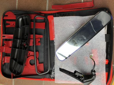

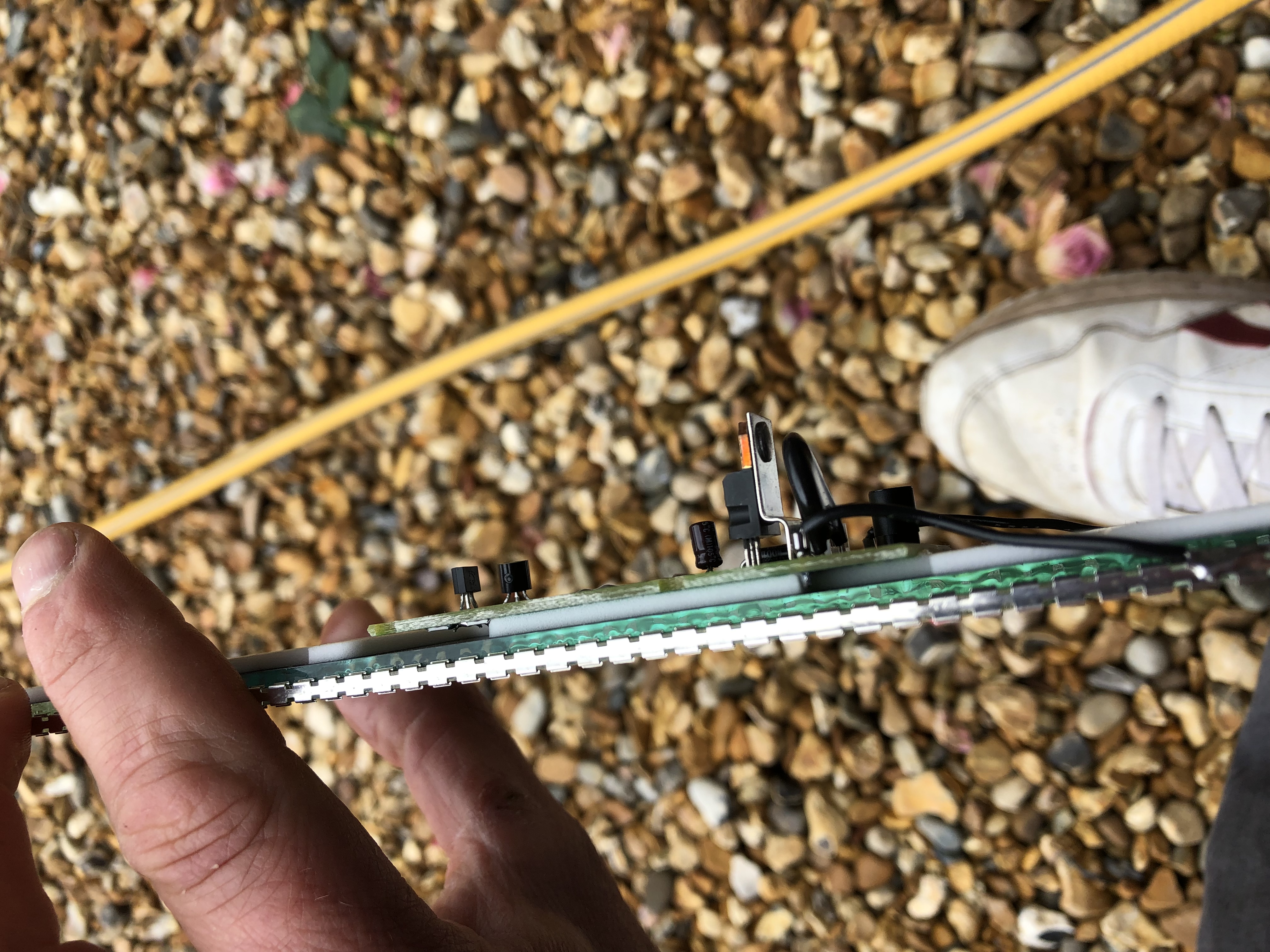

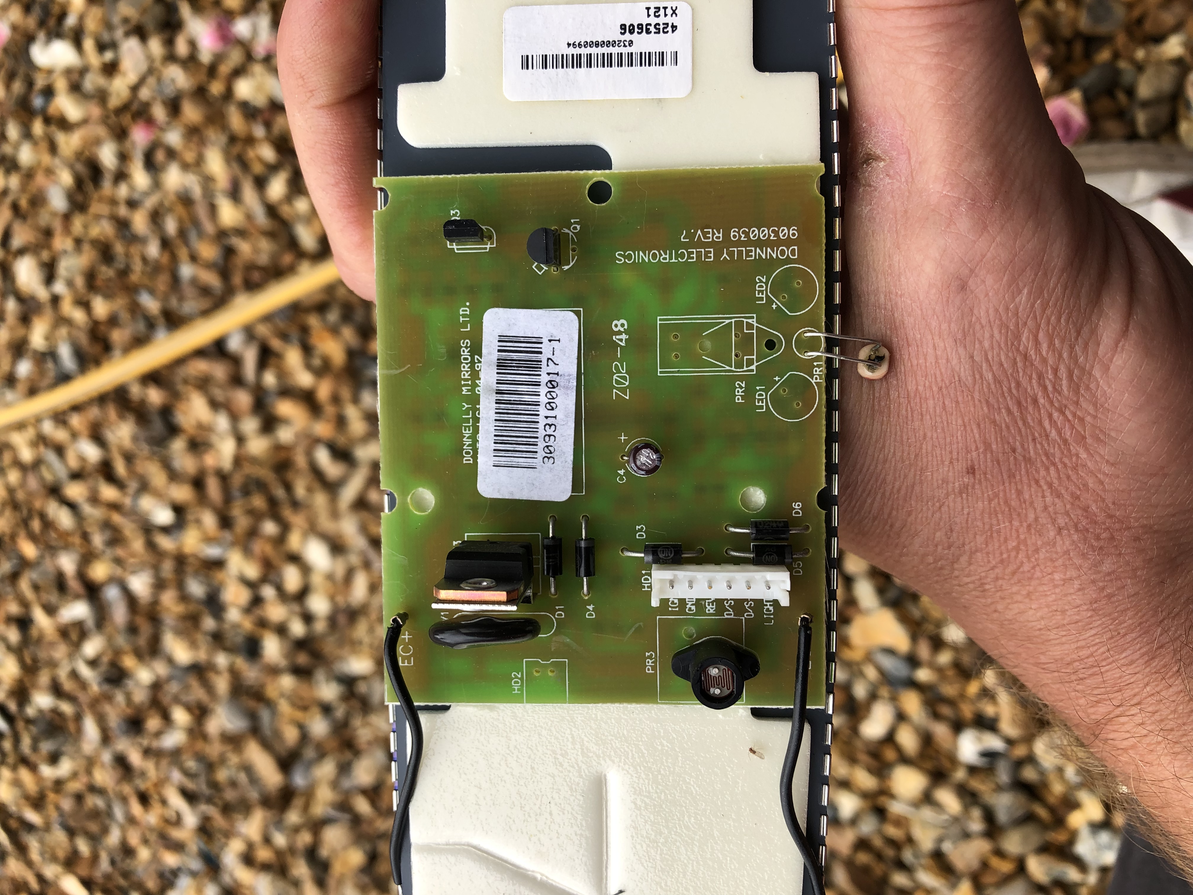

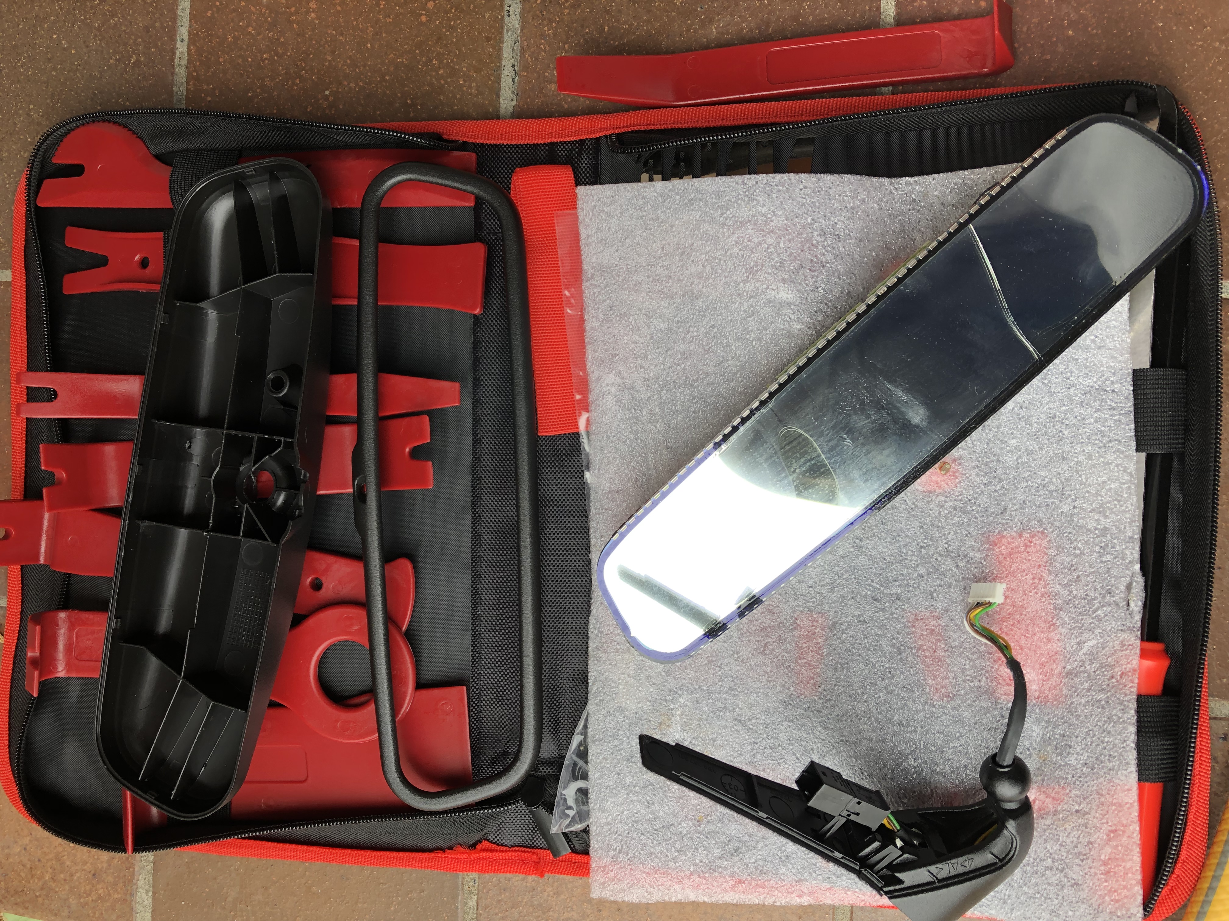

So essentially the mirror breaks down into four part after taking it off the windscreen.
I’ve now got the mirror separated and will see what options are available from here. Any ideas where to start are more than welcome.

My research has come up with a few possibilities.
1, Buy a new unit. They’re still available but cost around £350.
2, Buy a used unit. Will probably fail under the same sort of stress. (£70-£120)
3, Buy a used non dim mirror. (£15-£25)
4, Buy a replacement auto dim mirror glass.
Now to me number 4 makes sense, the obvious problem is finding the auto dim mirror glass. As luck would have it I’ve found someone who does this kind of work and oddly enough they’re members of the RS community, MirrorJohn (although he’s not been here for a long time).
I’ve contacted John through his eBay store, briefly explained the situation and invited him to visit this post and hopefully find a solution for us.
Here is a link to his eBay store.
https://www.ebay.co.uk/itm/224040938436
Fingers crossed we get a result.
