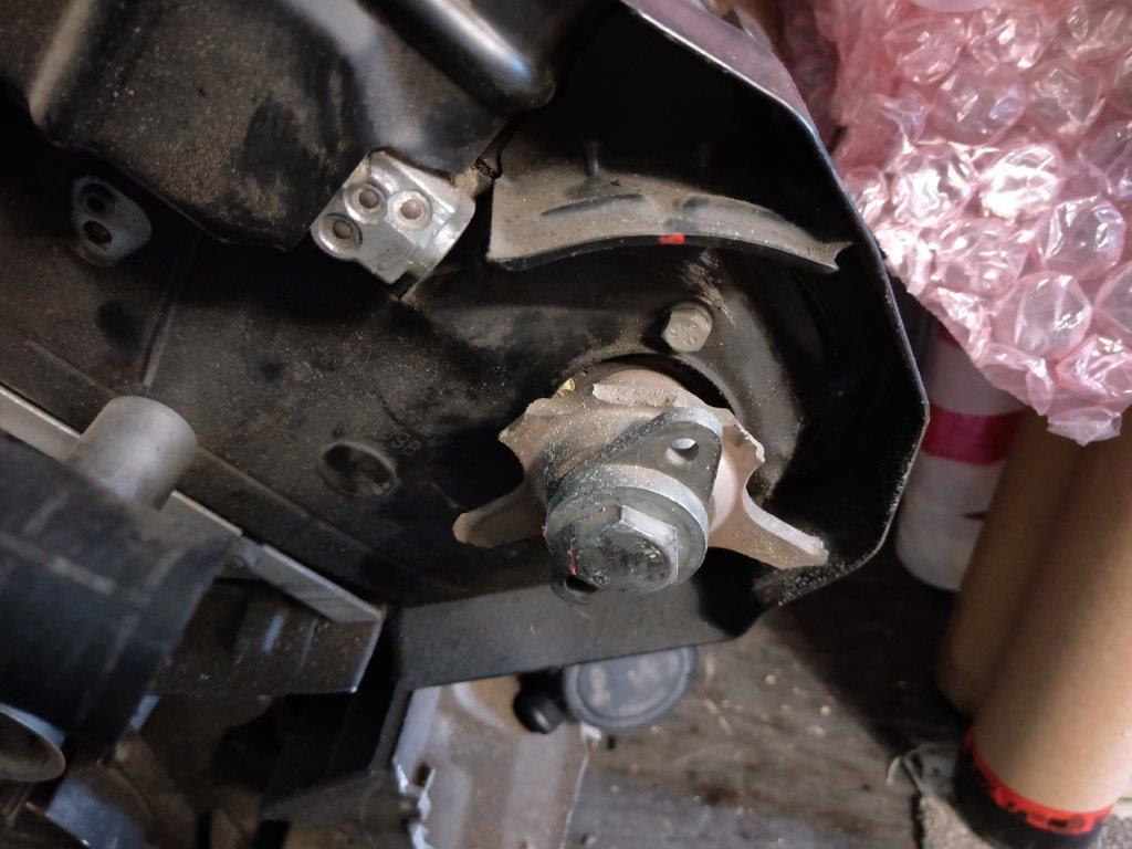

Spare parts car was crashed front left. I bet it has bent valves by the look of the cam drive.
Re: RS6 in pieces.
Picture of cam drive wheel attached this time. Anyone have a spare drive wheel?

Greg, Haven't had time to check but there is a good chance that the toothed belt pulley is the same as the 2.7 engine and that part number is 078 109 111B. If so, no RS tax and there should be plenty about. I may have a spare but not sure atm.
- simonpoulton
- 3rd Gear
- Posts: 265
- Joined: Sat Mar 05, 2016 6:40 pm
- Location: Essex
Re: RS6 in pieces.
Computer says yes!IchBautAuto wrote: ↑Wed Apr 29, 2020 2:51 amGreg, Haven't had time to check but there is a good chance that the toothed belt pulley is the same as the 2.7 engine and that part number is 078 109 111B. If so, no RS tax and there should be plenty about. I may have a spare but not sure atm.

My plan is to use this engine to get my head around the cam chains and timing belt alignment before doing my car.
After that I will tear it down and access the damage and look at if it's worth repairing. Very clean inside.
