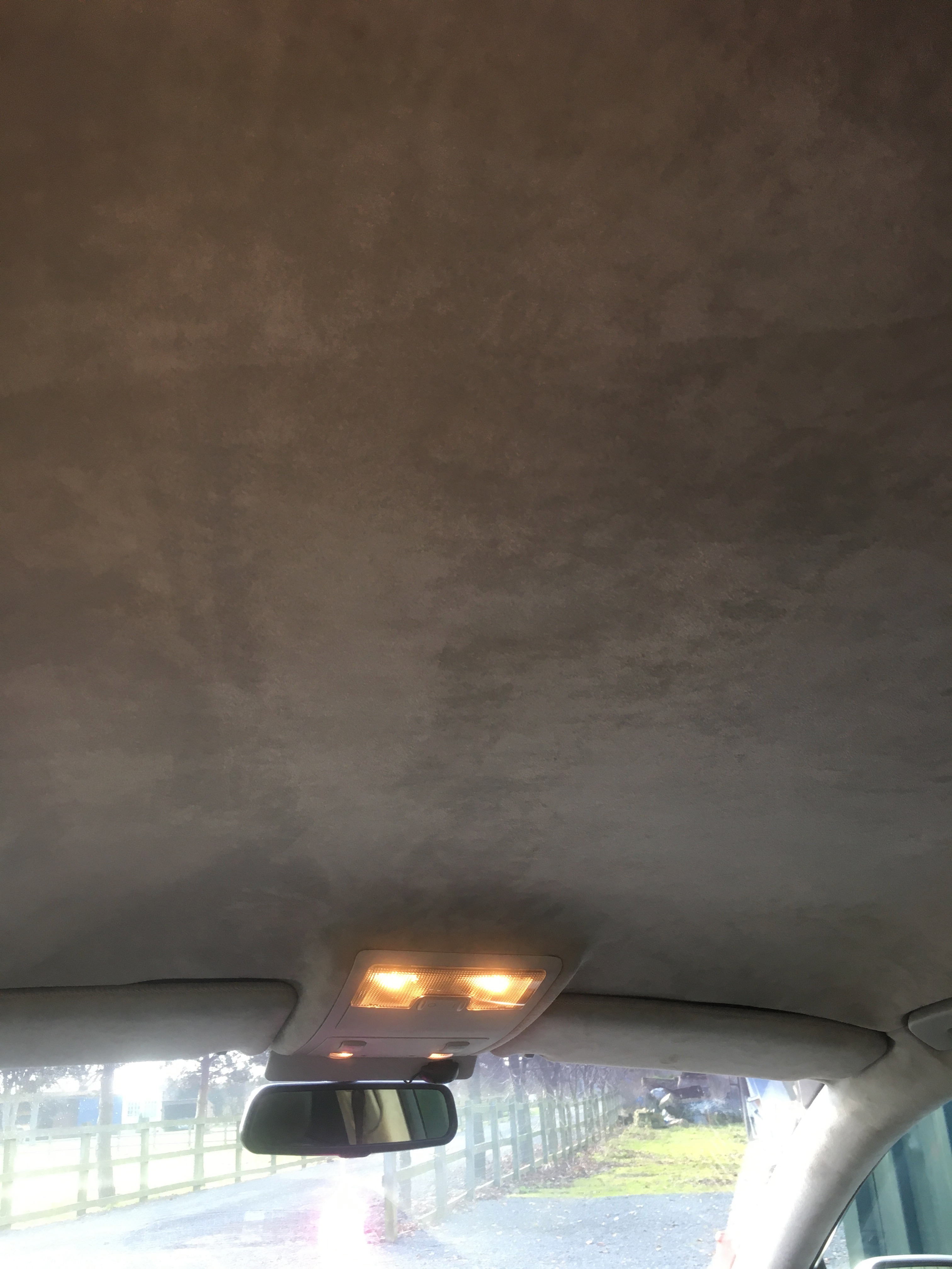

Now I've had my headliner re trimmed by 'Tony the trimmer' in Bedfordshire,
My RS6 is now cosmetically as good as it is mechanically and will be up for sale soon.
Apparently it is very common for the foam to break down on cars of this age, but fortunately the
alcantara can usually be reused, with the old foam being replaced and new adhesive applied.
see before and after photos.
