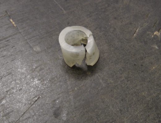

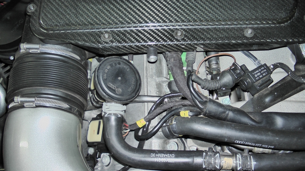

As mentioned in a previous post, the securing arrangement for the rear of the front CF engine cover included a piece of silicone tube to tighten up the mount. No idea if that was OE or a PO solution.
I used some heatshrink in layers to build up the peg diameter and the CF cover just slips on. Works for me.

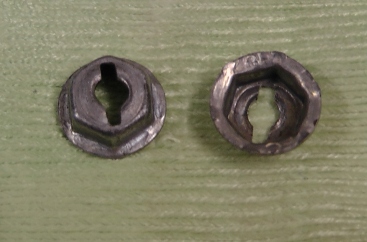

The female part of the 1/4 turn clips were missing. Started to make up a replacement using sheet metal nuts. Perfect size. Will post up the final solution when completed.

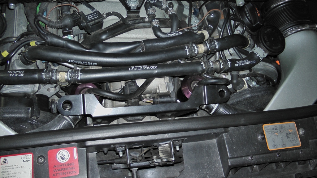

I did find that the front CF engine cover wouldn't sit properly at the front anyway as the DV vacuum hose was protruding above the clip bar.
I've fixed this by ordering a set of GFB DV's T9301. I'm already using these in the RS4 so keep it in the family. The vacuum fitting is horizontal rather than vertical so the cover will snug down to where it is supposed to sit.C5 RS6, Milltek and Wagners: B5 RS4 450 + HP: A4 1.8 GP TQS original: 1963 UNIMOG 404:

Nice. Looks like the DV hoses are oversized, hence the poor fitting.

By oversized, you mean too long? Agreed but the replacement DV that are fitted place the vacuum hoses a little too high anyway so to get them below the engine cover mounting plate they stood the chance of getting kinked. A bit of a sequence of events that didn't seem to gel properly.

I mean they look like silicon hoses to relace the OE vac hoses. Those have a much bigger outside diameter (and much bigger bend radius). I wonder if that's what broke your clip nut in the first place.

Correct, they are silicone hoses. Certainly possible the hoses did some damage to the original clips. Once I get the GFB's, I'll be able to find out what brand (if any) a PO fitted. Been there more than 6 years I believe. Can't see anything even with a mirror to indicate their origin. I'm assuming that as he spent a small fortune on Milltek and Wagners, He would not have put in some Chinese copy DV.

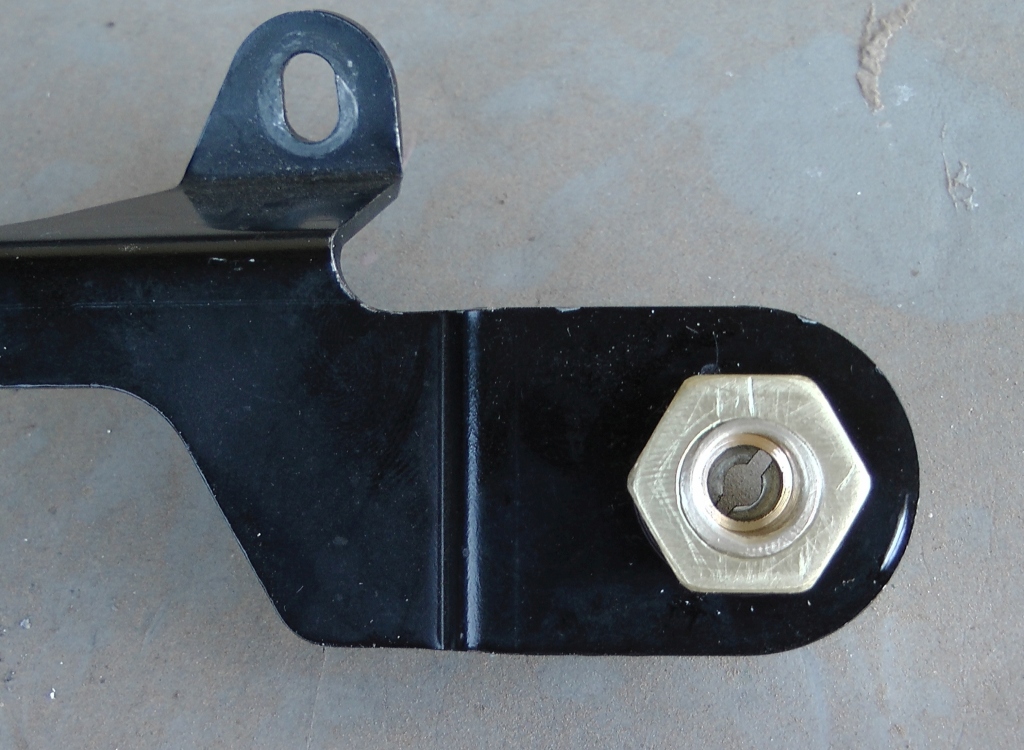

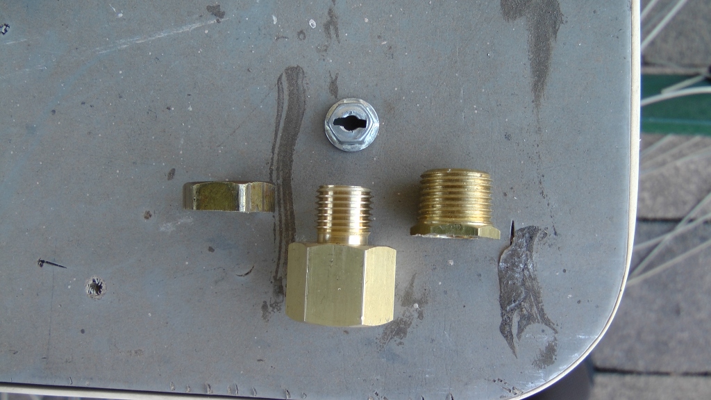

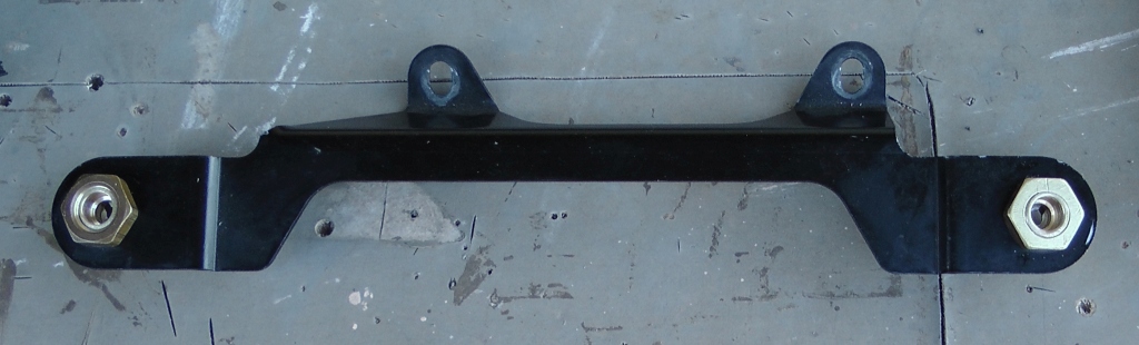

Made up the missing front CF engine panel clips. Easy enough, if I still had access to a lathe then it would look a lot more professional but hand tools only for this one.
A few 1/4 - 3/8 BSP gas fittings, two 3/8 bsp male-male joiners, two 1/4 bsp lock nuts plus the pressed metal nuts that I slotted previously. All the parts needed modifying, basically shortened and then screwed together and assembled in the bracket. This is the detail. Finished product ready to be re-installed. Test run worked perfectly. These won't be going anywhere, a bit of loctite and set for life.

Satisfying.
