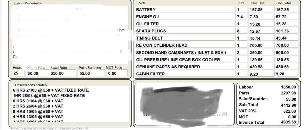

I’ve asked for a more comprehensive breakdown as £430 for ‘genuine’ parts is a bit vague, I’ve also asked why it’s had a service as unless the plugs were damaged, they were only fitted 1800 miles before, as was the filters. Plus I am at a loss to how the head has cost £1245+vat when there was a recon one on egay for under £700. Why did I need 2 cams, I wasn’t told of any cam damage.
Feel very disheartened right now, as I had said I was on a budget. I’ve lost 3 very costly court cases over my family home and am financially drained. This was like: let’s see what we can do. I’m also stunned at the cost of the battery. 2 years ago my last battery cost £125. it’s like no expense spared kind of thing.
I don’t have the cash atm, I said no rush, and it was done before I could think.
And I supplied the cam belt kit, water pump, aux belt and bufkin pipe (which they didn’t replace by the sounds of it)

5 Grand ? That's insane !
Re: This is going to hurt
Did they tell you their labour rate was going up? If not I'd argue they ought to charge you the old rate as the job started before.
