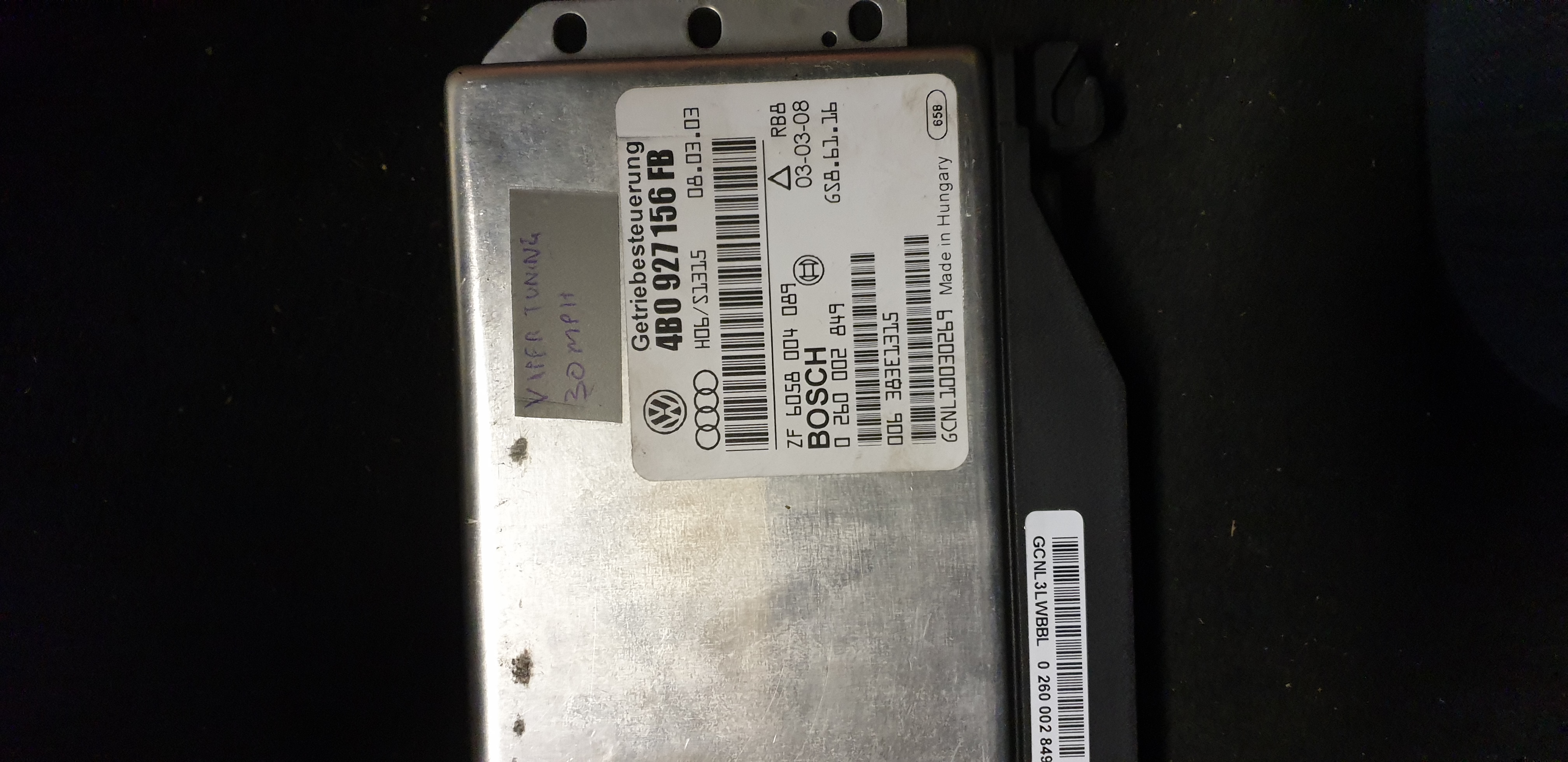

Had this problem for a while now after a full service had a chat with Shopp about it and we thought it best to run the car for a while and see what happens. Basically car went in for service and came back out with the gear box feeling as if it went back to standard from the viper tune it had. So after a while I phoned unit 20 where it had been looked after for a while and after explaining to the gentleman what had happened he suggested checking a green wire that goes to the TCU as it could have corroded thru time. I have lifted the carpet in drivers footwell and was hoping to see a seperate green wire but nothing.
Photo attached of the TCU, any ideas anyone.

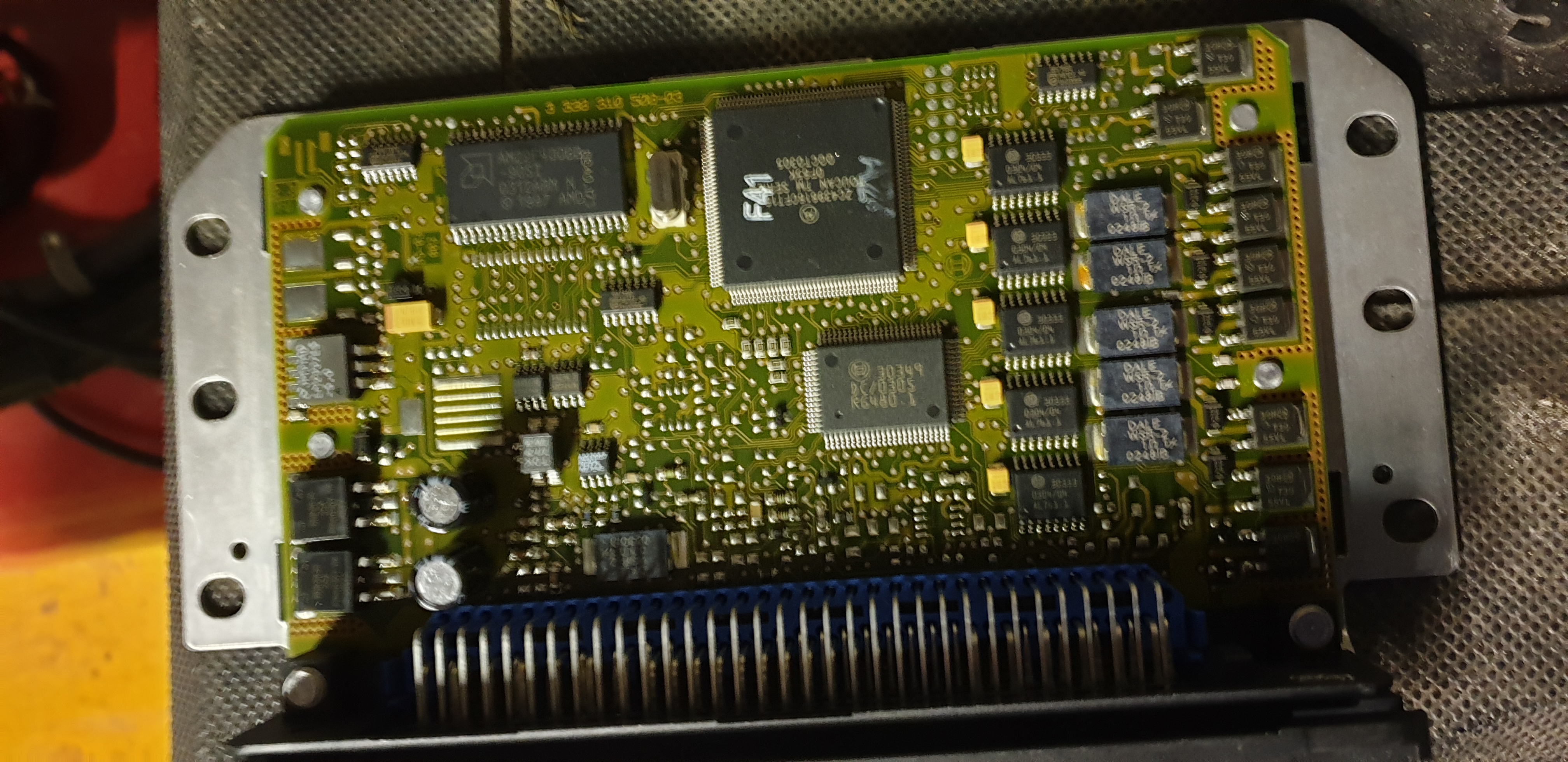

I opened up the TCU and everything looks ok, nothing corroded or loose, carpets all dry. Mind you I haven't a clue what I am looking for.

Are you sure it's the same TCU that came back after the service?

When you opened the TCU did it look like one of the chips had been changed / messed with?

Not that i could see, pic attached. Old boy that serviced it looked after my Audi's and VW cars this was just to much for him I guess.
